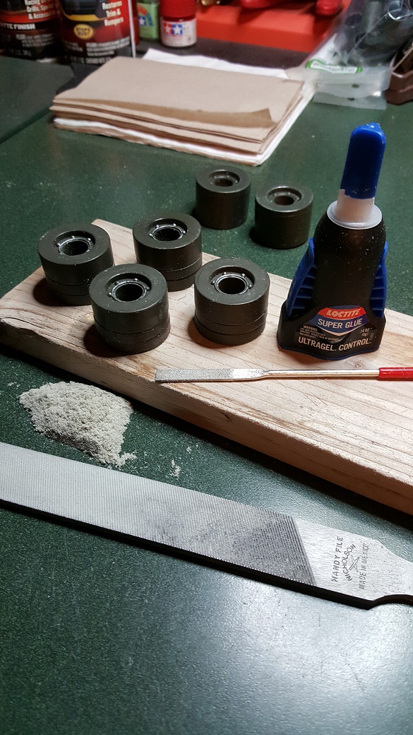

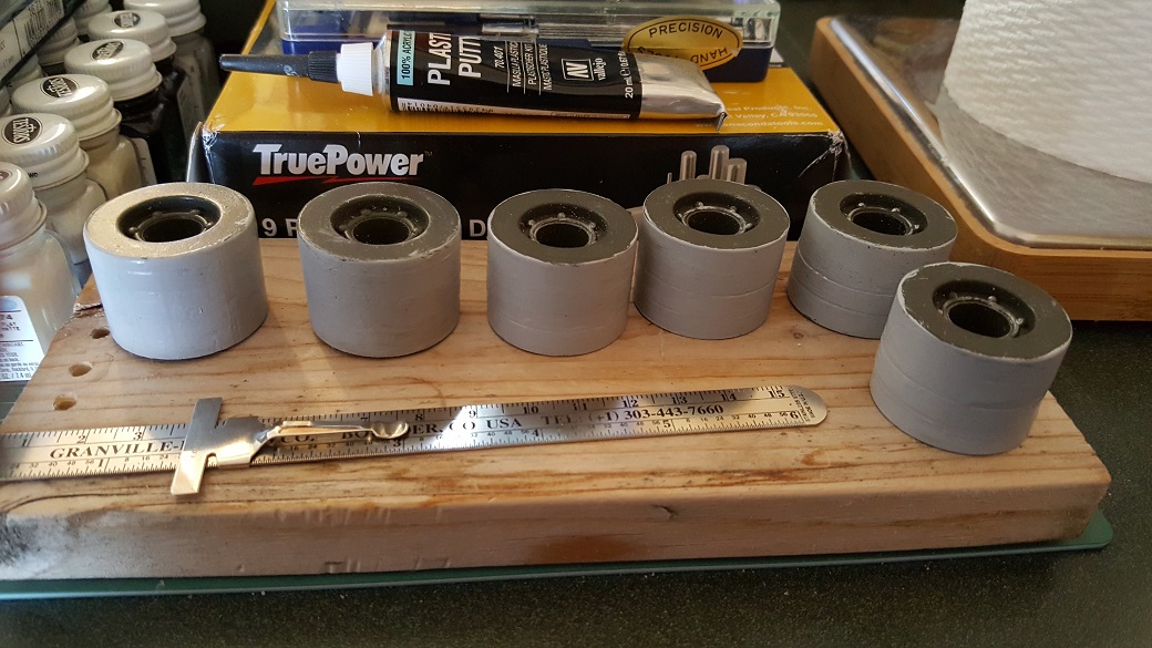

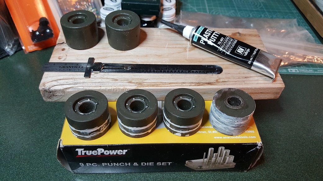

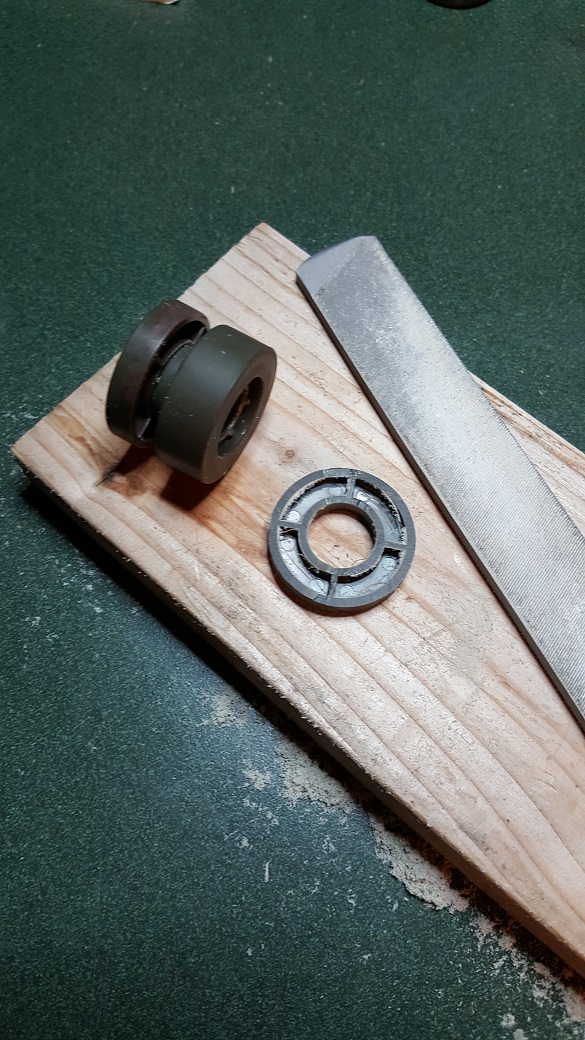

All is well on the Health front again so this evening I returned to work on the return rollers ( pardon the unintentional pun ;o) I cut the shaft off of the intended spacer pieces with a Tamiya thin plastic saw while they were mounted in a mini vise for stability. Filing followed to take the very little required material off for fit. The last step was dremeling out the center ring to enable it to slide up to mate against the roller half. Some of the LocTite Ultragel secured all three sections together. I used some Vallejo putty to fill the slight joins and set them aside to cure. Tomorrow, I can clean them up with sanding and then drill and mount the bushings. Once the bushings are cured into place, I will measure them up in distance from the hull sides using an original RC roller and screw them into place. If needed, I will add a bottom axle shield for appearance' sake using salvaged plastic shafts from making up the rollers. Pics: ( click to enlarge )
A little putty and they can cure overnight.  Tomorrow is sanding and mounting the bushings.
Afterwards the spacers' center openings are Dremel tool sanded out to the right diameter to slip over the axle shaft.
A little filing is required for the spacers to fit perfectly.

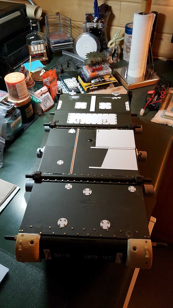

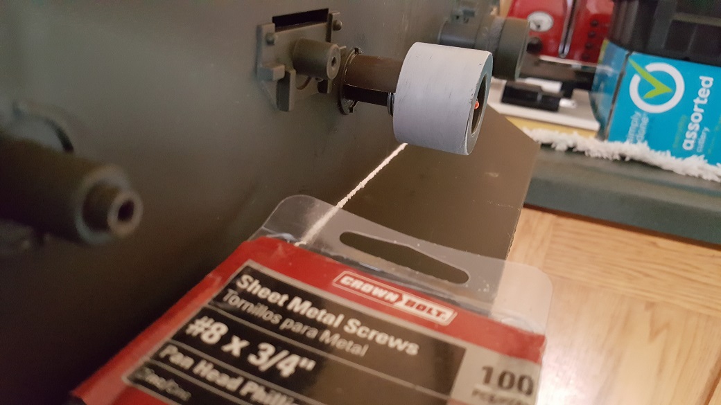

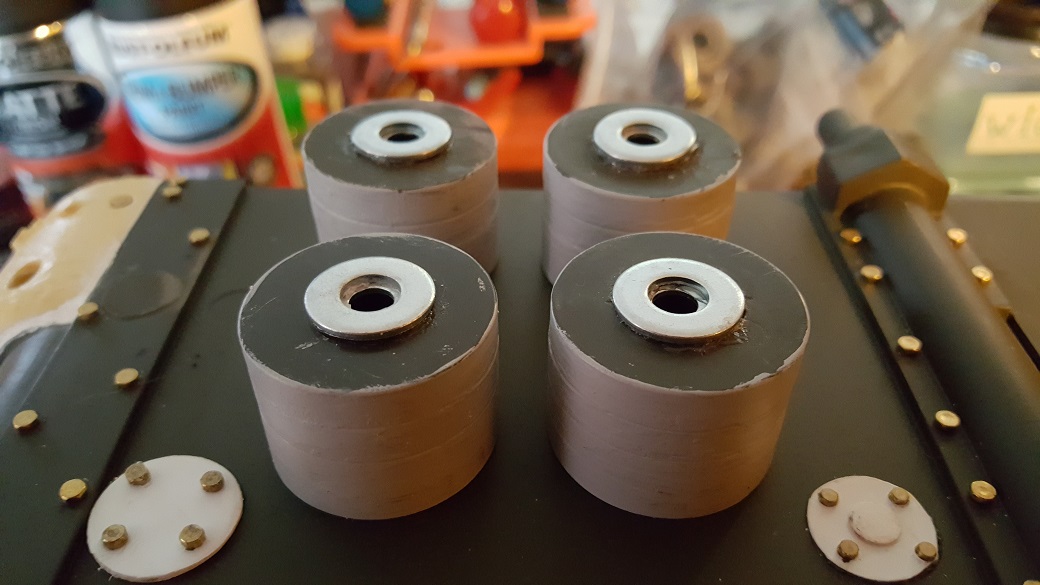

There was time today to work up the mounts for the return rollers and start getting them installed. I used the two sent by Mike first as they already had a bushing installed in them and that made mounting them much easier. The other four scratched ones required inletting with the Dremel and a router bit to have the steel spacer lay flat and be internally mounted. I added a larger, external steel washer as another spacer to get the distance right from the lower hull wall. I should be able to finish up those four tomorrow and get them installed. Idlers next...Pics: ( click to enlarge )
The non-static type return rollers that were made up required an external spacer.  24hr epoxy was used again to mount the internal and external steel spacers
This shows the spacer and stabilizer mount I came up with.  Everything is curing overnight having used LocTite 24hr epoxy.
My Cunning Plan mount using steel washers as spacers to match the distance from hull wall of the RC return roller.  Mounted using a Number 8 self tapping screw.
A coat of Mr. Surfacer 500 to give the rollers a little grip on the tracks.

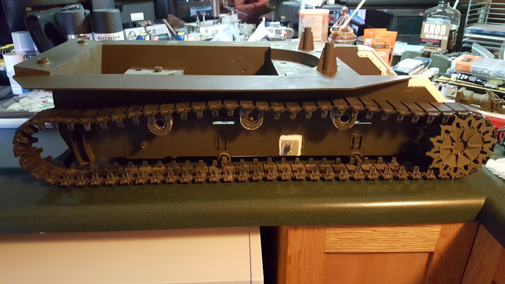

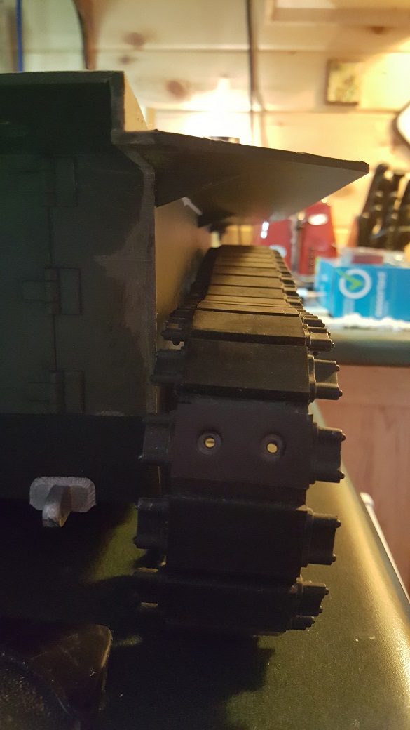

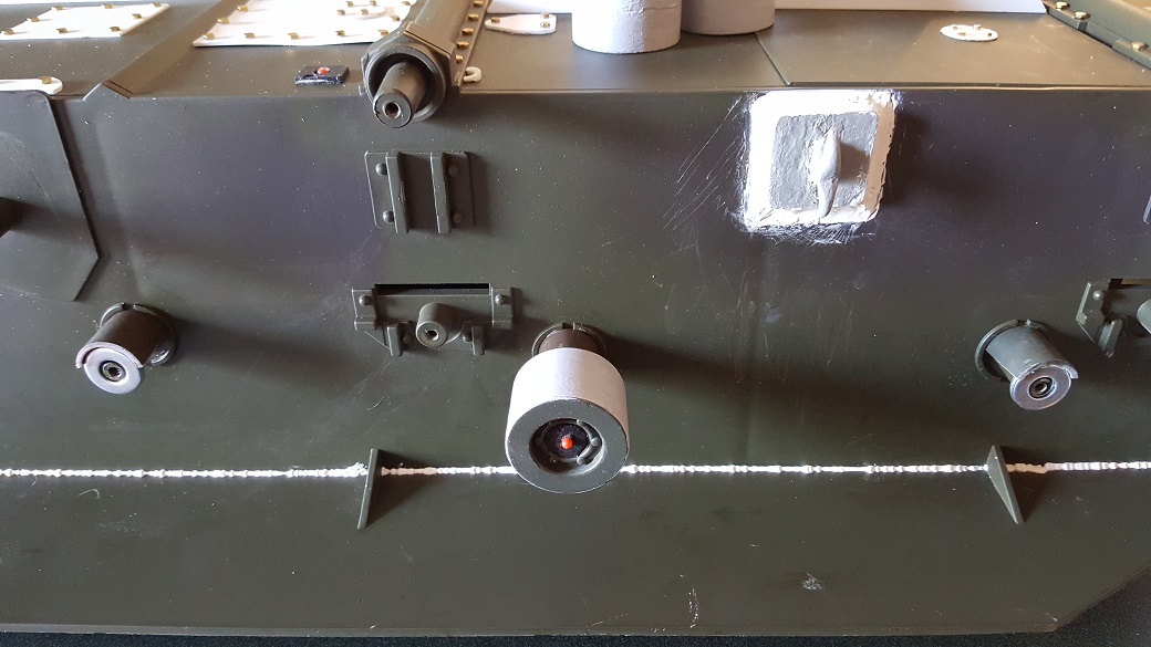

After the End of Shift whistle ( I should get one of those ;o) I mounted the other four return rollers. A little adjustment was needed to keep them a safe distance ( no rubbing of plastic and metal ) away from the axle shields I had installed. The pics will show that my rough hewn measuring efforts yesterday paid off. I had gone to bed last night wondering if I would have to file material off of the spacers since the guide horns on the track are so long but happily, that step was not required. Pics: ( click to enlarge )
A little more Mr. Surfacer will be needed but another milestone has been finally reached.
I have the bottom of the tracks pulled to the side slightly but it can be seen that the top run lays flat over the return rollers now.
Clearance Test...Passed...
