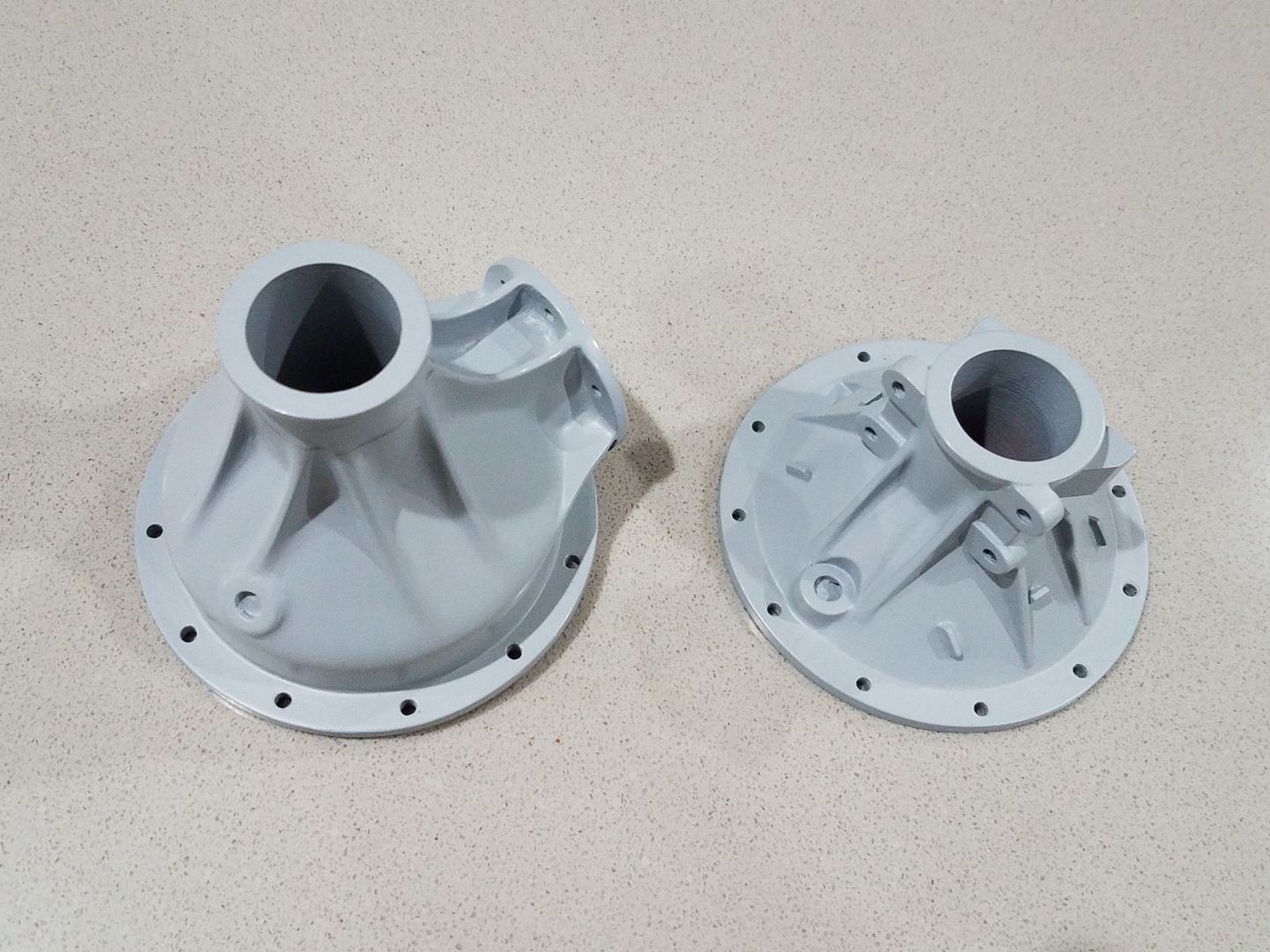

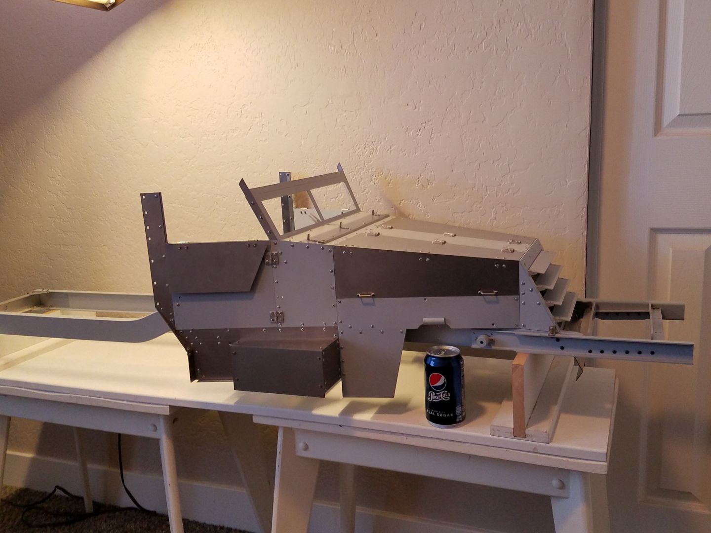

Hello everyone, new to this forum, wanted to share my rather large M2 halftrack build, i have been working on this off and on for several years. It will eventually end up being an M16B with the quad 50. i knew going into this that there would be no aftermarket parts available in 1/4th scale so i would have to make every part, but so far i have enjoyed watching it come together. Heres a link to a few more pics https://ibb.co/album/FX0LC3 , i just recently finished the front diff case sides which will eventually be cast out of aluminum. my focus right now is to make the frame to rear floor brackets and then the rear floor. I know of only 1 other halftrack in 1/4th scale and it was made by International Harvester to showcase their halftrack, it is in a museum.

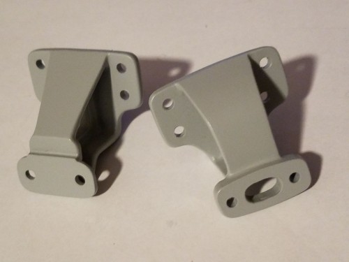

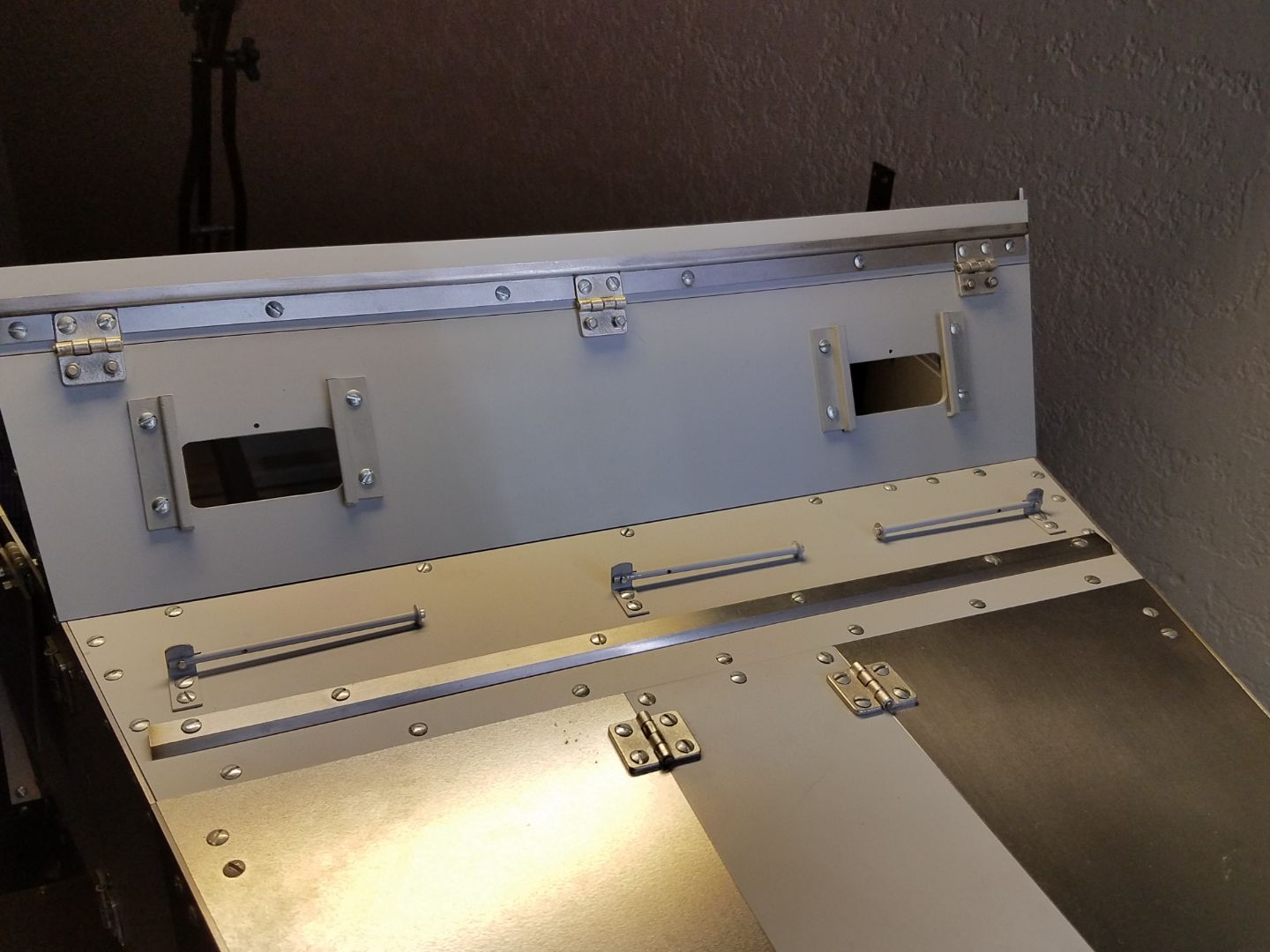

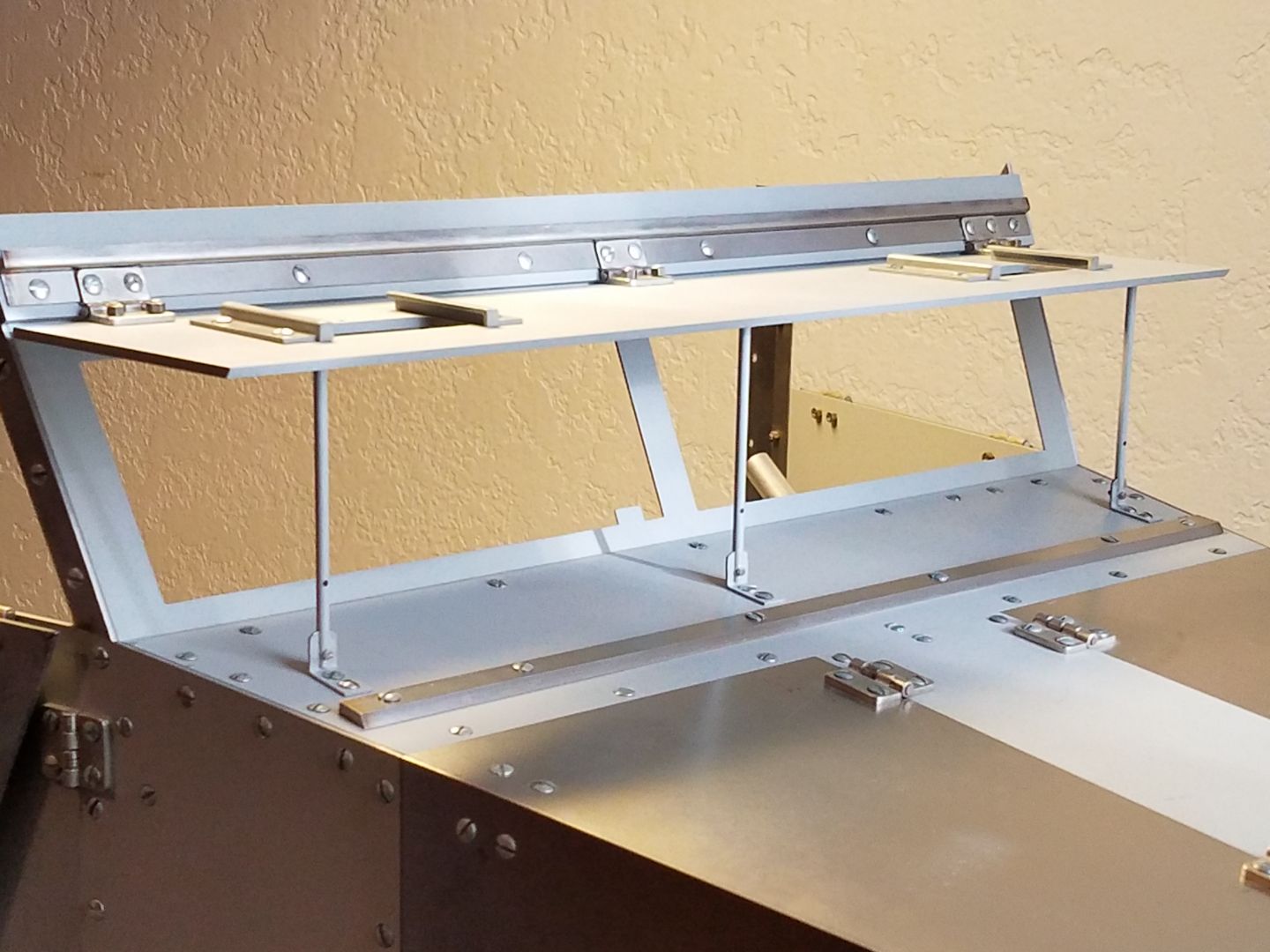

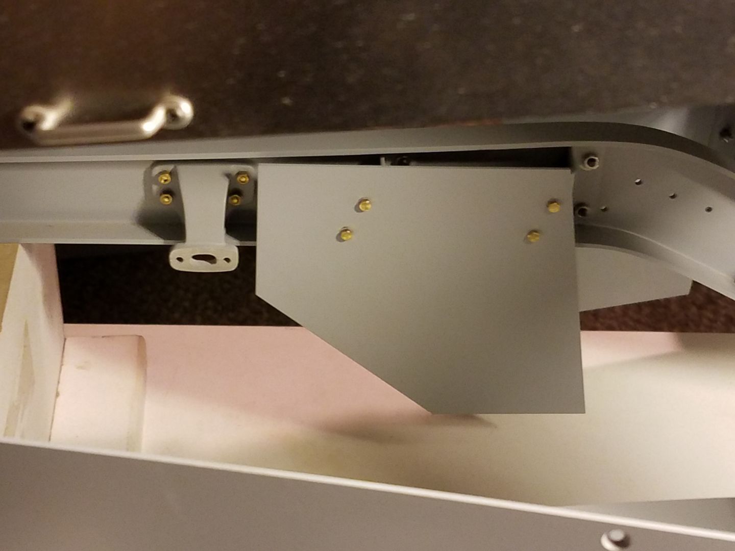

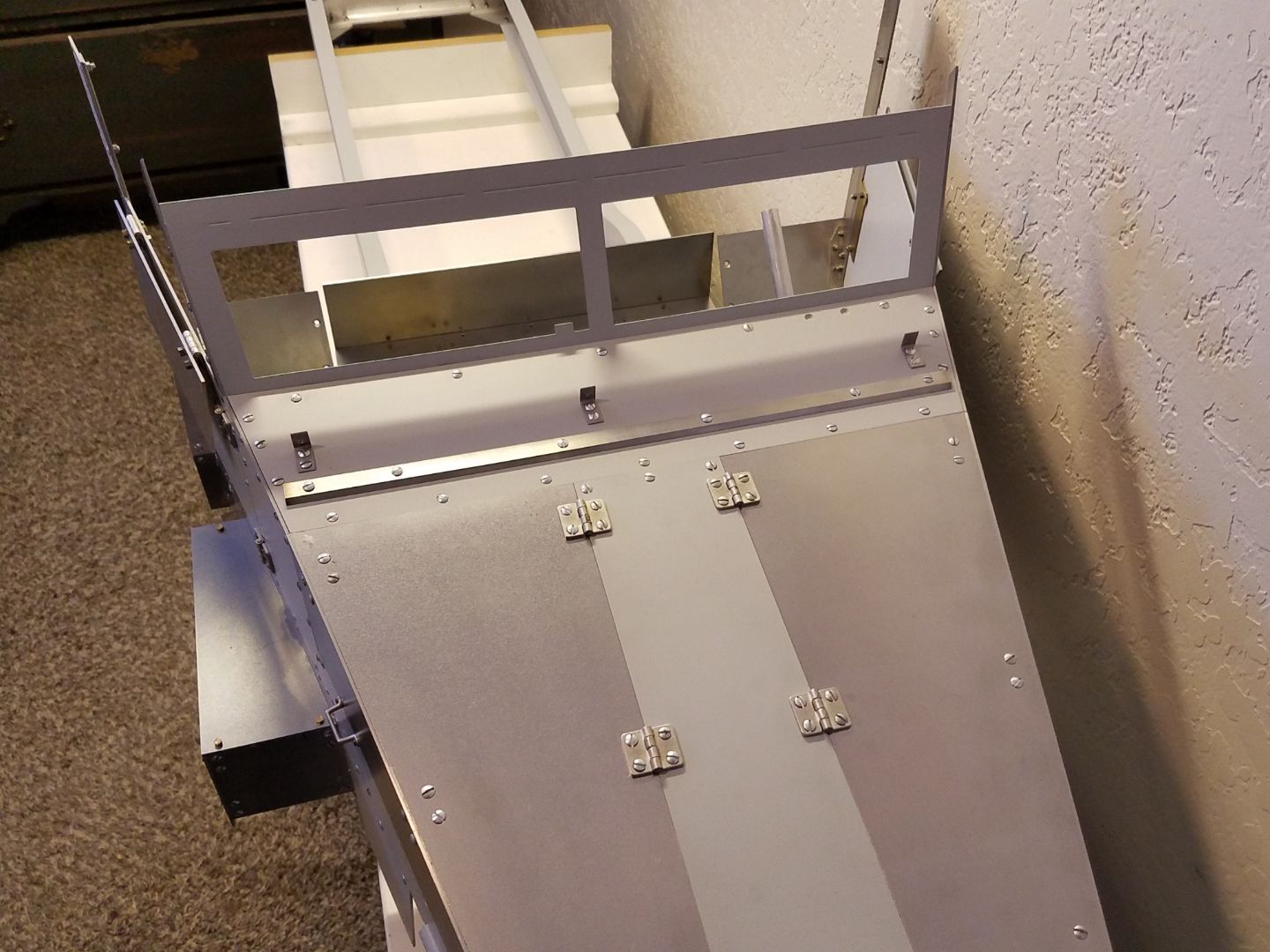

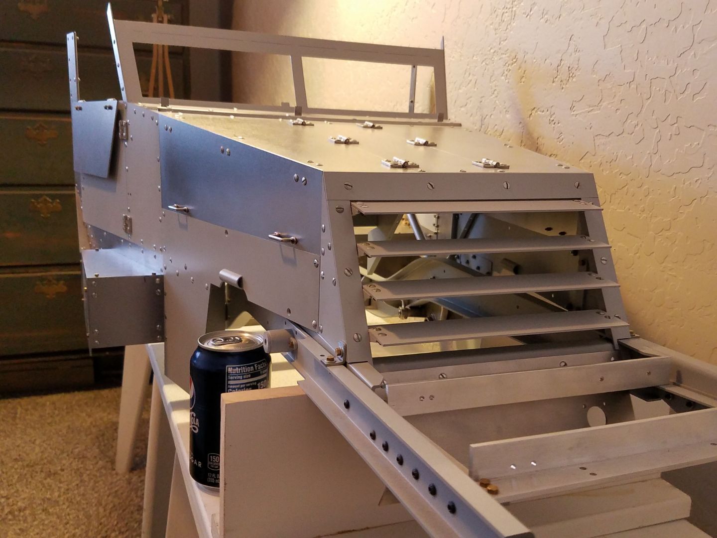

I managed to get a few more things done, the front motor mounts have been cast and installed along with the inner engine armor, also got the windshield armor almost done with just a few more things to add. The track armor is currently being cut out and will post pics as soon as its installed.

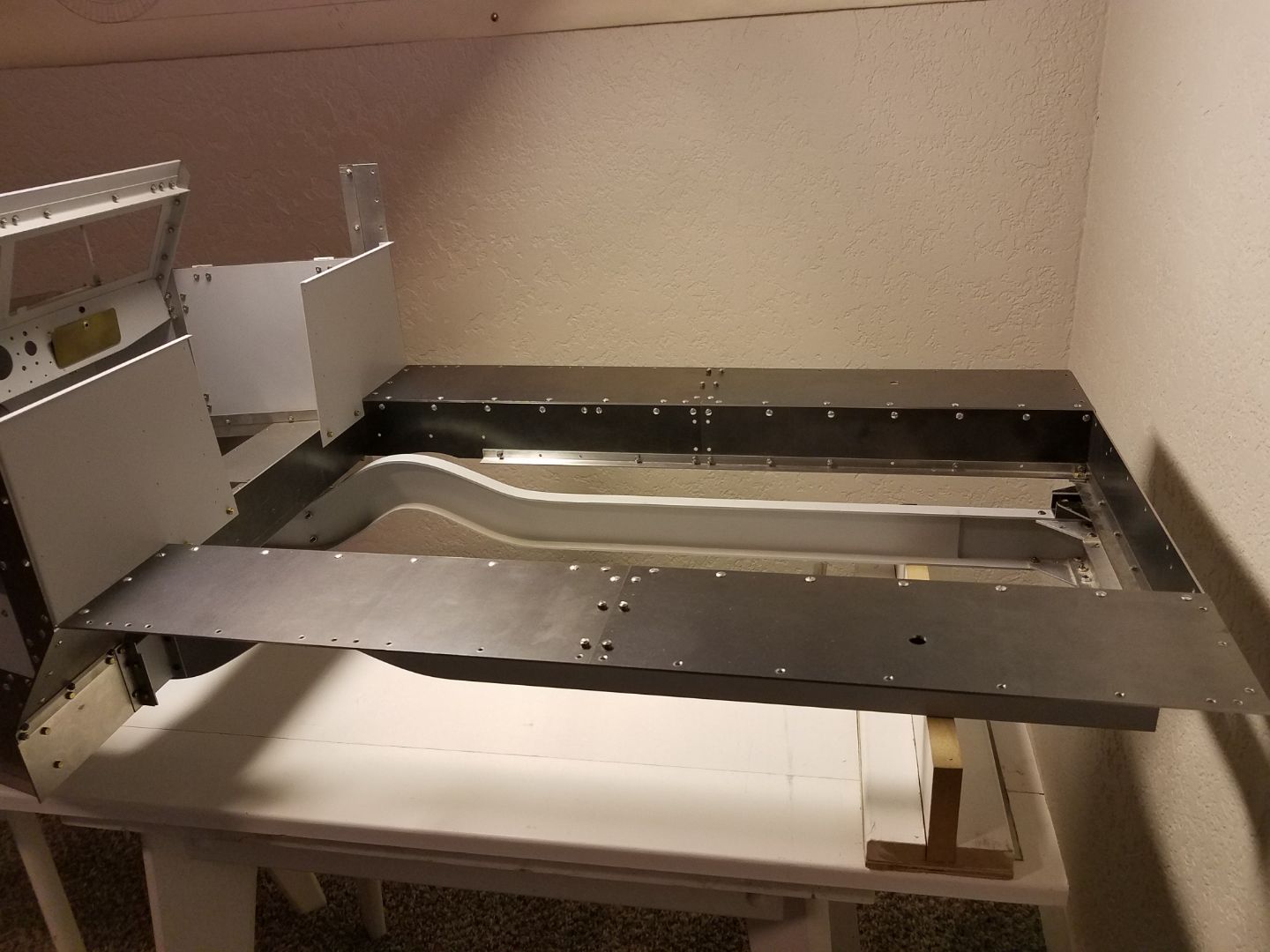

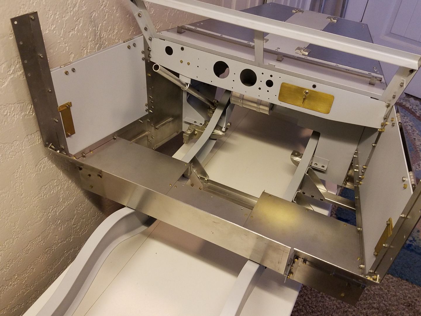

Some progress, i added the 2 rear cab bulkheads as well as the track armor, up next is the center of the rear floor which i am currently working on.
