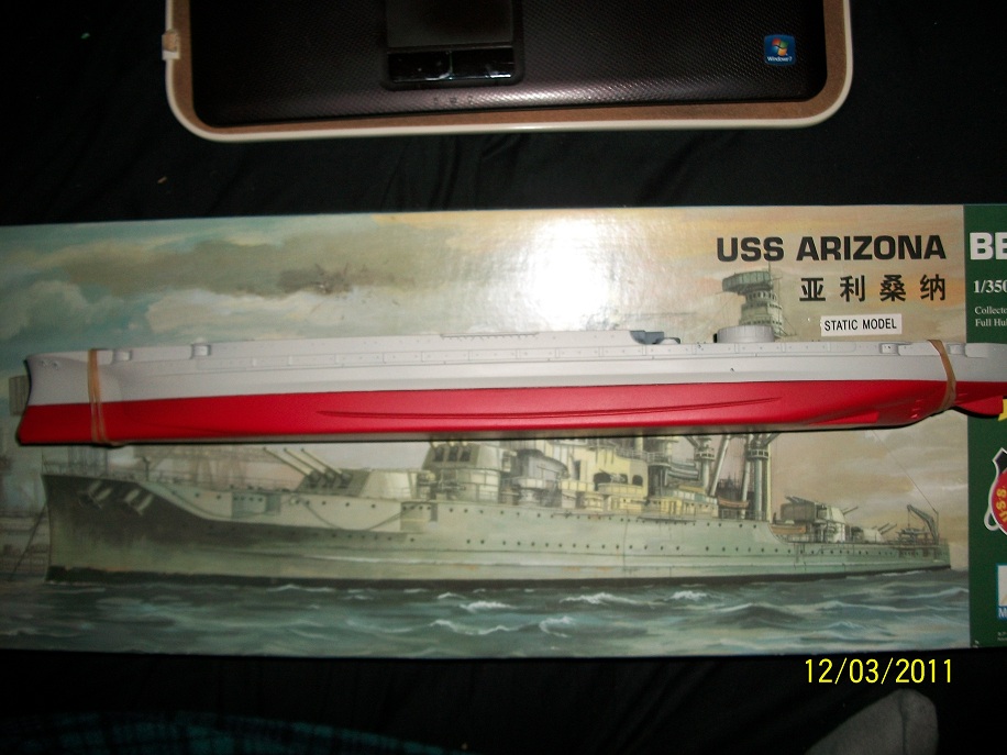

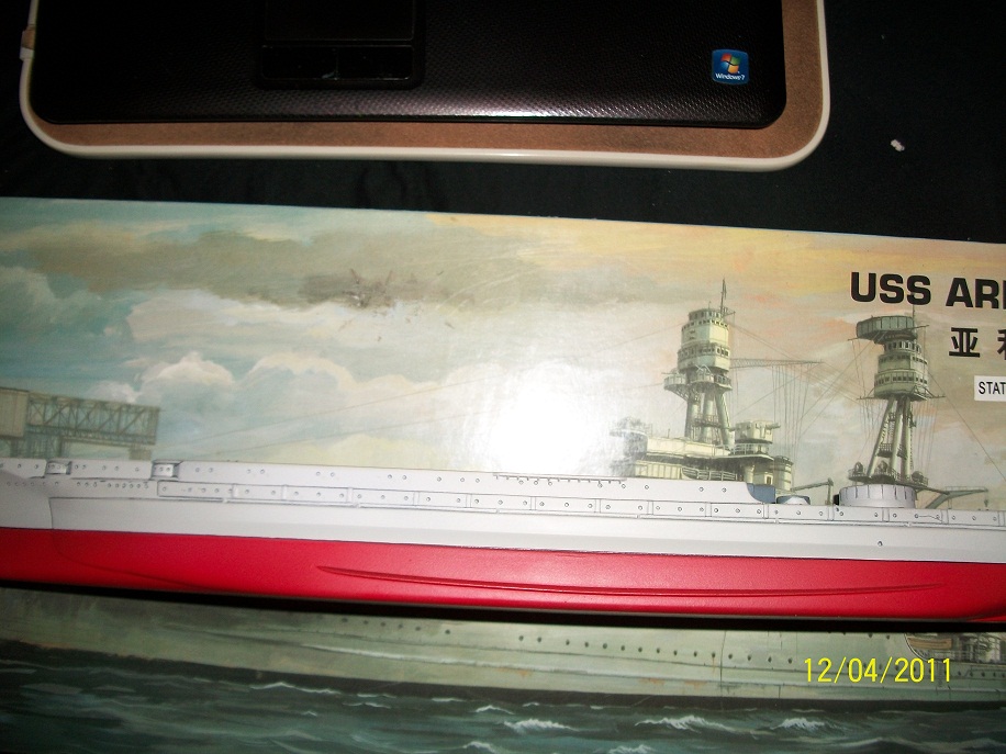

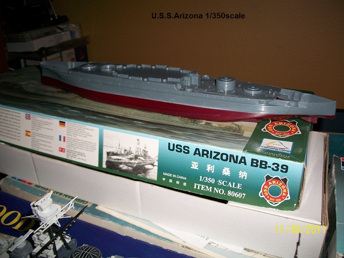

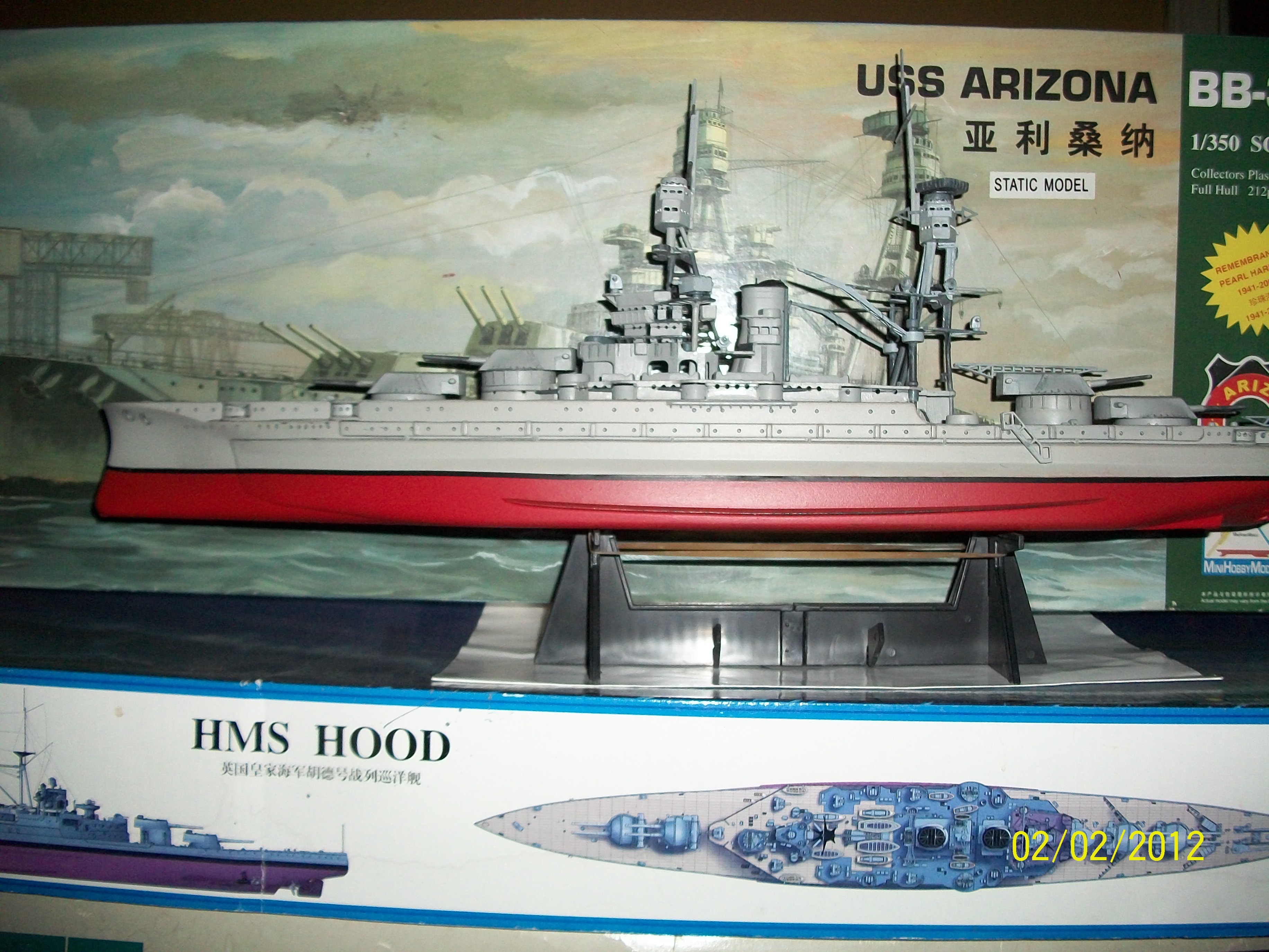

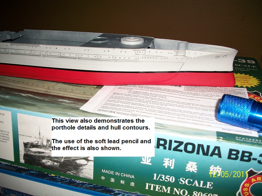

As I posted in my 1/200 scale Arizona post I'm building this kit as a pre-build for the larger scale kit,the hull paintwork and detailing is key to a great looking ship.

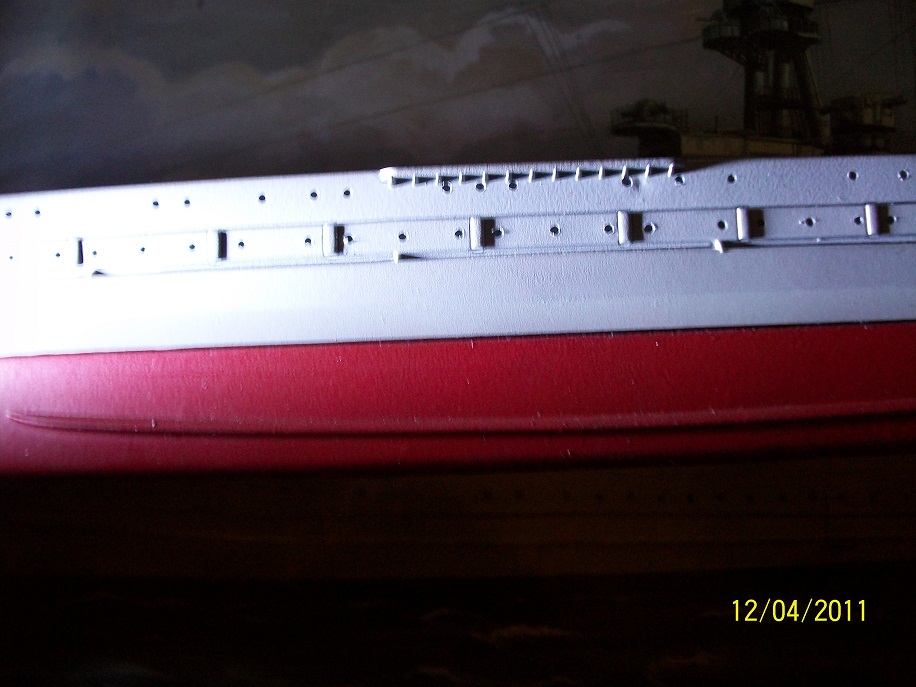

Every porthole has been cleaned with a drill bit due to the flashing of the moulding. This and the outlining with a no.2 soft lead pencil after the base coat of Model Master 1930 Flat Gull Gray increases the detail. The outline marking gives form and shadowing to the hulls changing surface shapes.
The lower hull is painted in Model Master Flat Red 1250 over a base prime coat of Flat Black. Tamiya Dull Red works well for Royal Navy and Kreigsmarine ships,Like the Hood AND Tirpitz of my earlier builds. American ships tended to be a little bit brighter.
Due to the Era of this ship,pre-ventilation the use of port holes is extensive,and many were shaped incorrectly and even different sizes,a sharp drill bit used by hand will correct most of the imperfections and result in a cleaner looking hull. I am going for an early 1930"s look and the basic pacific fleet paint scheme.

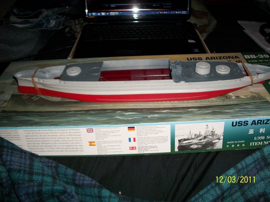

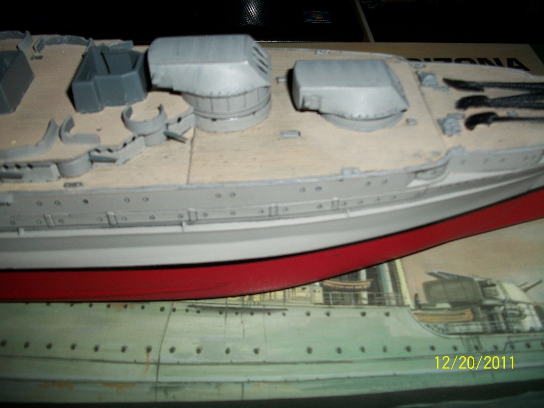

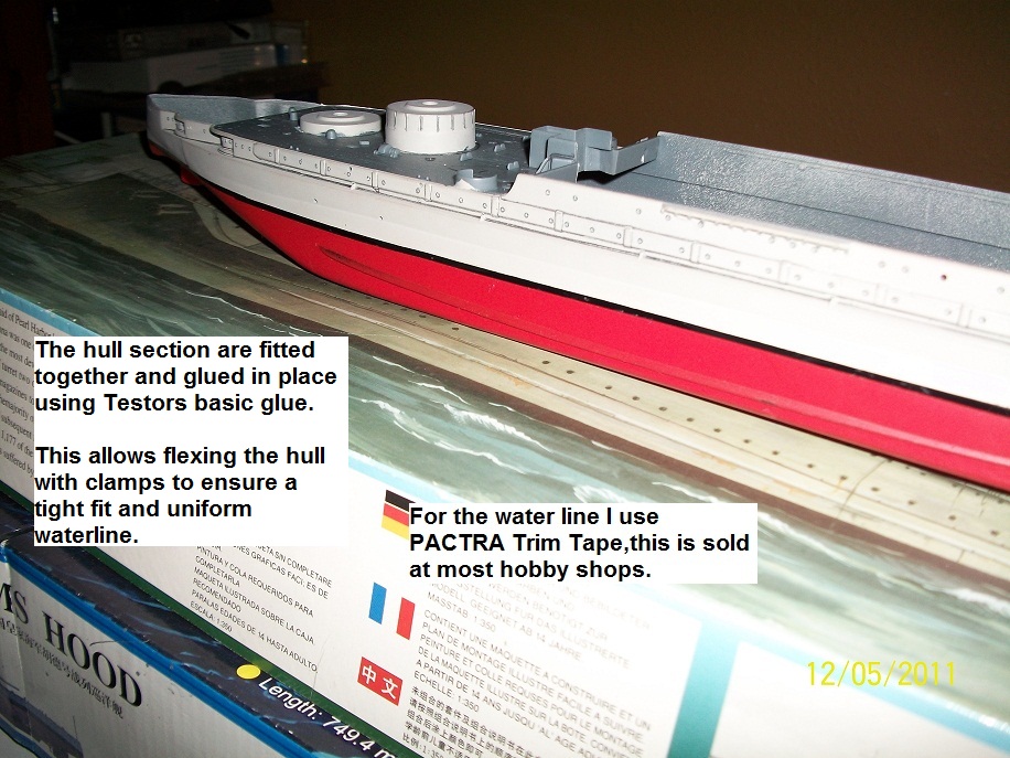

Hull sections are sprayed with DULLCOAT.Hull sections fitted together using basic Testors glue,this is best for ships with split hulls. Using Testors allows for hull flexing where CA tends to snap or break free,also the narrow tip applicator allows for an even line of glue,this prevents glue running onto the painted hull surfaces.
The longer drying time also helps,flexing the hull with clamps to obtain the best fit. Then I use PACTRA trim tape for the water line ban strip. This is also best as it hides any hull gaps,and is easier to apply than painting. In the past the cost of a good quality painters tape and the actual paint were more costly and alot more hassle than this trim tape method. The high shine does cause some issues and a very thin coat of acrylic dull clear or flat clear applied will fix this problem.

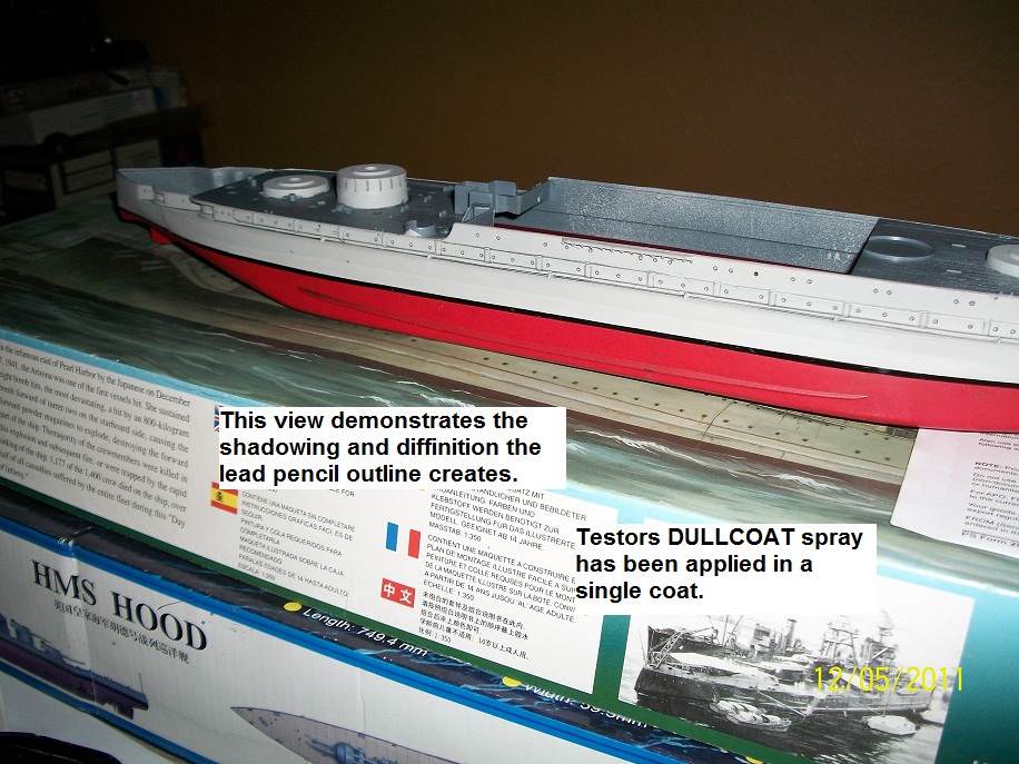

As a note here,I will be using the lead pencil effect on my next tank to highlight the hull contours and the shadowing effect on a tank with a plain base coat of XF-60 from Tamiya. This hopefully will have the same results as on my ships,really don't know why I never tried this on tanks before?

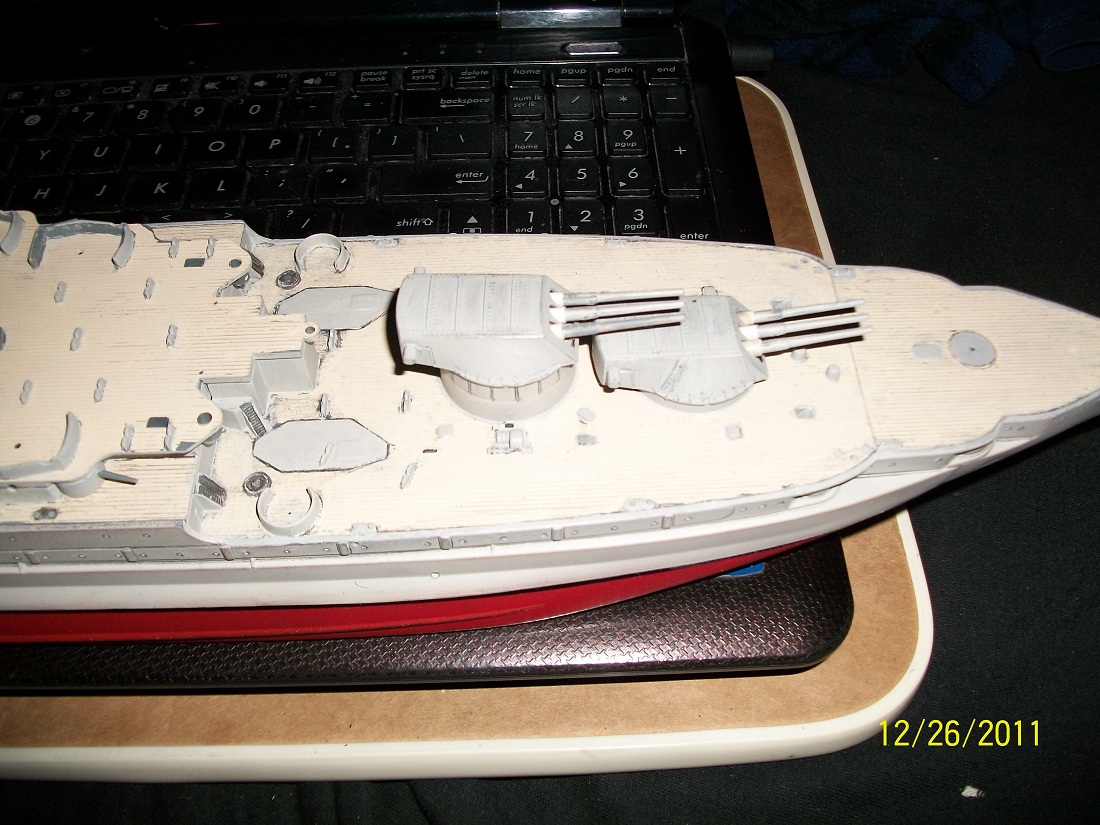

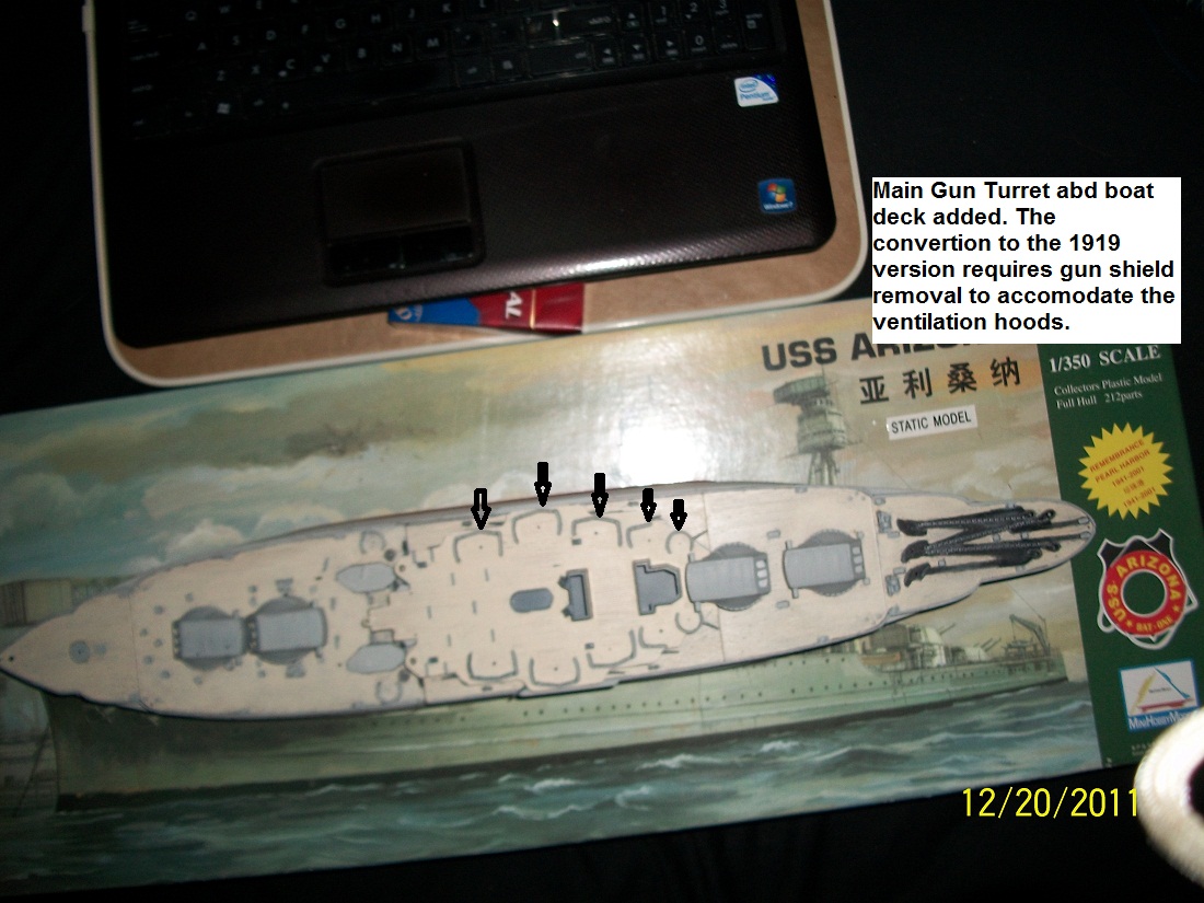

Here are a few pictures,the hull is now ready for the main deck and the main guns to be added. the deck will require alot of prep work,many deck fittings and ladder access ports with hatches are moulded on this kit,the bollards,and deck engines for winches all will have to be outlined and then protected against the deck paint. The technique used will be detailed in that post.

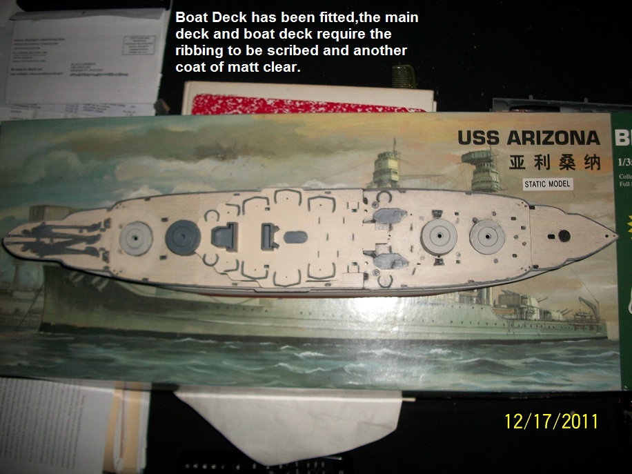

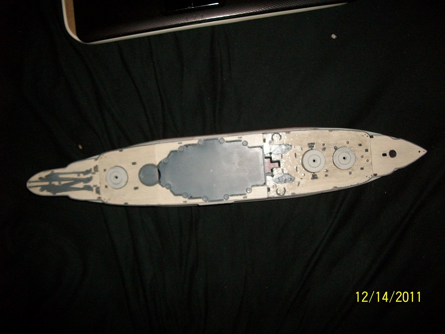

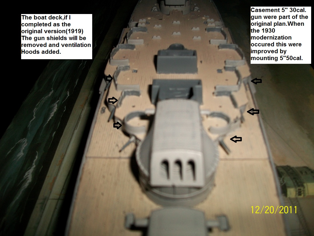

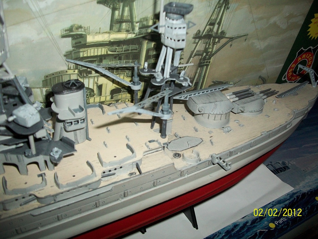

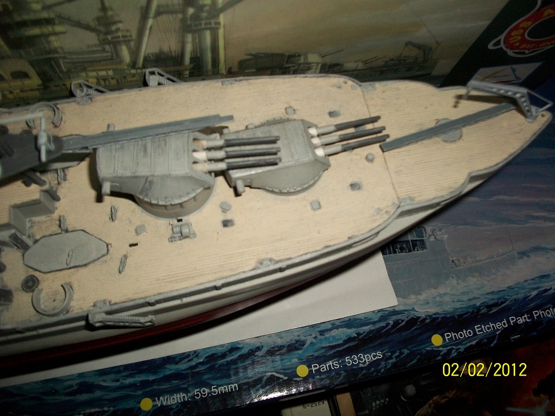

Progress on this build is slow, I would like to produce the ship as Originally Launched and fitted. I have reached the point of having to decide this issue in order to move forward.

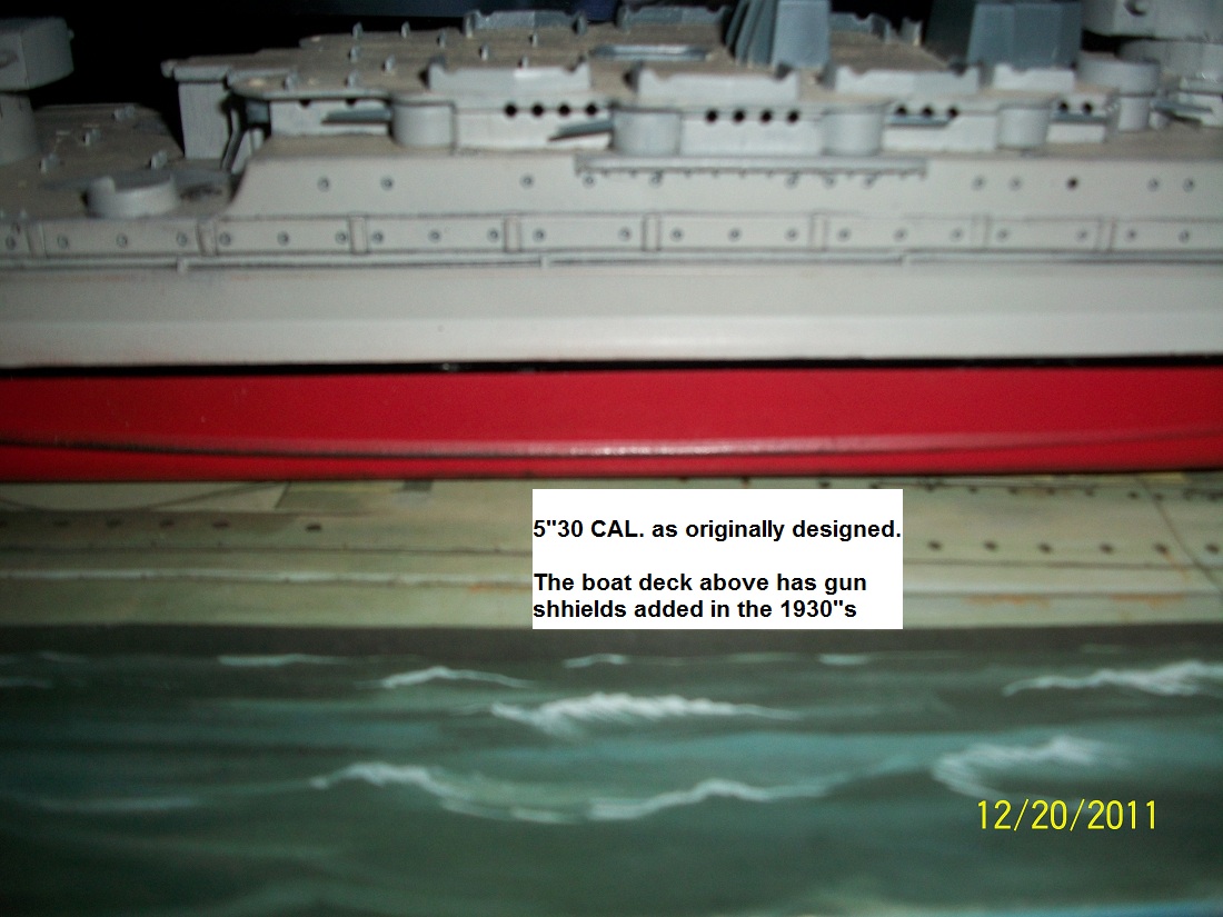

The Boat deck is key to this build as the addition of 5"guns and their shields in the 1930"s and the removal of the cage mast for tripods effected this section more than any other part of the ship.
Here are a few pictures...

I have looked at the original ship photo from 1919 and reviewed the US Naval history site for the upgrade and modernizations to Arizona.
The 1/350 kit has the Gun deck mounted higher as on the original ship the 5"casement guns were all mounted a deck lower,this was changed in the 1920"s as the guns as mounted in the photo below were found to be useless at speed or considered to Wet in action.
Converting this kit may be very difficult where the 1/200 scale version actually has the decks fitting separate and would allow me to install the casements back into the hull and simply mount the barrels to the casements,making it appear as the original ship appeared below.
So it seems at this point I will build this kit as the pearl Harbour version and focus on the 1/200 scale kit to convert. On youtube their are several videos of the 1/200 kit built and sailing but all are done as the modern version of Arizona,I really want to built the original as no one has done this. We shall see...

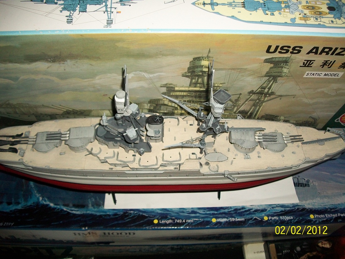

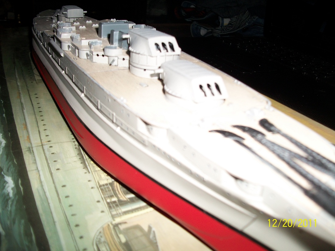

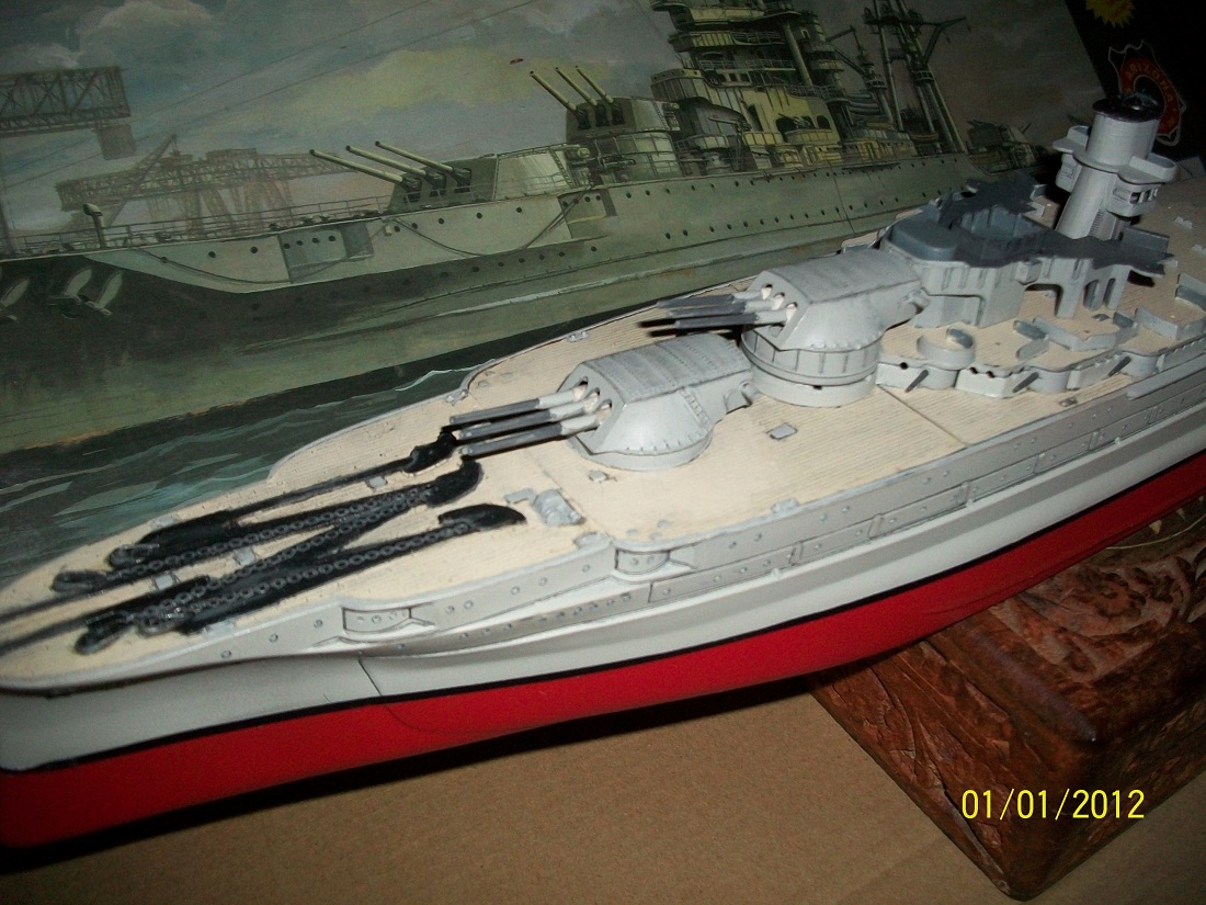

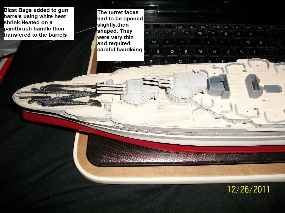

A little late night work on the Arizona,Blast bags fitted using white heat shrink,first heated around a small paintbrush.The gently slid onto the barrels,each barrel connect to a central shaft so installing the barrels into the turret required some filing and shaping to look correct and to simply fit right. The discolouring on a few was to dark,but these assemblies were canvas and known to get dirty from the CORDITE.
The Arizona often carried the Fleet "E"on her funnel,the symbol for firing excellence during fleet battle competitions.This was of course prior to integrated radar gunnery systems being installed. The US Dreadnoughts that joined with the British during WWI adopted the deflection scales and range clocks of the Royal Navy. These will not be on this kit at this point.
Although I do intend to install these devices on the 1/200 scale version. Hopefully as I will need to print these deflection scales and apply as decals on the turret sides and Barbette housings. We shall see?

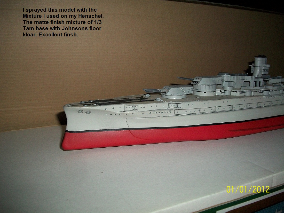

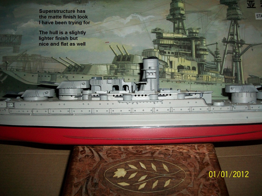

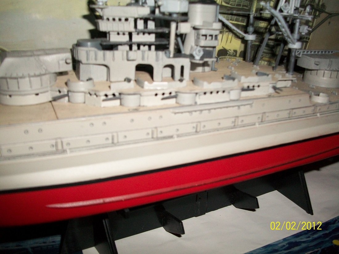

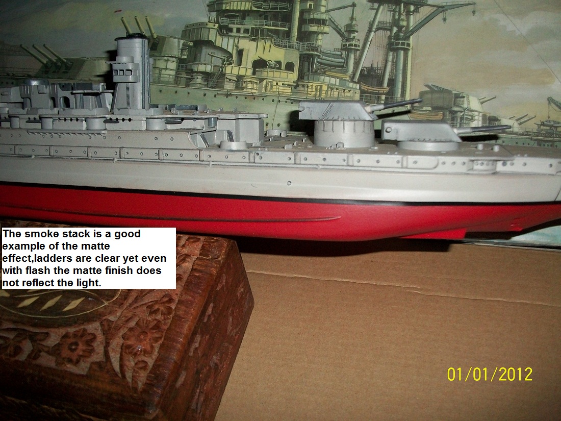

I also used the Tamiya matte base / Johnson's Klear mixture on this ship when I sprayed my Henschel King Tiger. It has dried and looks very well,the tone between hull and superstructure is more defined,the Hull is a shade lighter,the main superstructure being darker.This is the pre-war Pacific base scheme.with the superstructure darker as the level above the water increases.The towers will be Flat white,and of course the mixture will be used. Interestingly the Navy changed this scheme in the late 1930's as aircraft played a more important role in our defence operational plans. The decks of Arizona were very light,being an oil burner from the start she did not suffer the coal dust accumulation other Dreadnought Battleships suffered.
I understand the changes are not as obvious to many as they are to me,the addition of the main superstructure,the deck fittings,piping along the main stack,the bun barrels with blast bags,and the final addition of the mooring cables,the main section is not glued in place yet but the installation of the drive equipment has been delayed,this static version is offered in other countries with motors,the battery tray and stuffing boxes are moulded into the lower hull but so far no luck getting the drive unit.

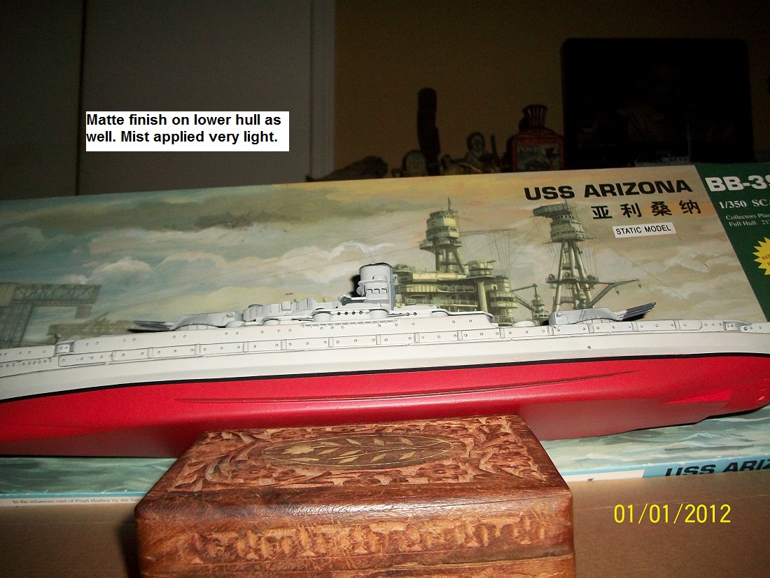

Also the weathering continues,the hull needs some more detailing,but I TEND TO BUILD FRESH.you could say. All capitol ships have their time fresh from dry-dock,the Arizona is being built as she emerged from her 1932 rebuild,I had to correct much of the superstructure,which is built as of last night,I should have her near completion soon. The towers were wrong in the kit,and the aerials were even to short and mounted on the wrong side of the rear tower. Some plasticard round pieces and all is fixed.

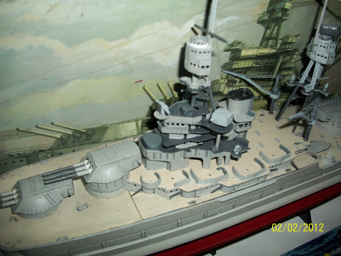

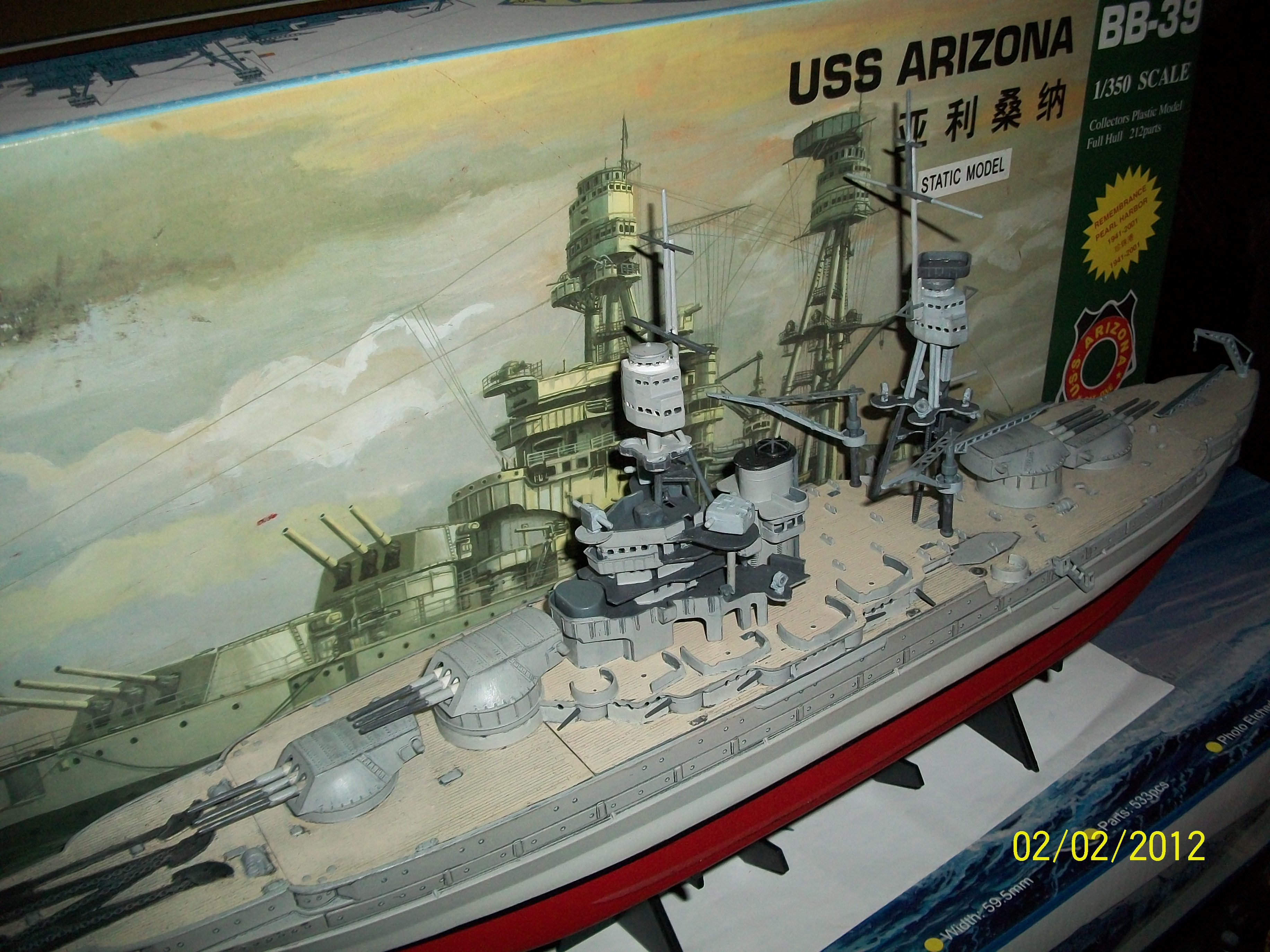

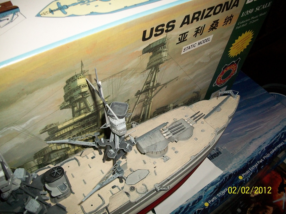

It has been a while since I posted,the Arizona has grown some new parts,the conning and observation towers were really poorly moulded,and they just were wrong,
I have built them using plasticard round stock,and some sheet material,the platforms with the kit were good just all the supports were either wrong or did not line up correctly.
Well I did my best,and Hopefully the 1/200 scale kit is a better design,which being a trumpeter brand it should be. Here are a few pictures,mainly superstructure,tri-pod towers,cranes for boat deck and aviation and the aircraft catapults are fitted.
It is in a pre-war 1931=1936 paint scheme,the white towers came after 1936.
