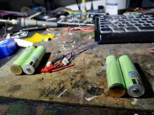

I think I have already commented it somewhere, but here it goes again, I dont want to use LIPO batteries anymore. I had a couple puffing, and when driving the tanks me or my sons the tanks I am more worried about overdischarging (and exploding) the batteries than actualy enjoying it.
I experimented with Nimhs, but the self discharge rate is too high and it is not too reliable for me. I want to have the radio fully charged and to have it ready to use. No matter if I charged the batteries one day or three months before.

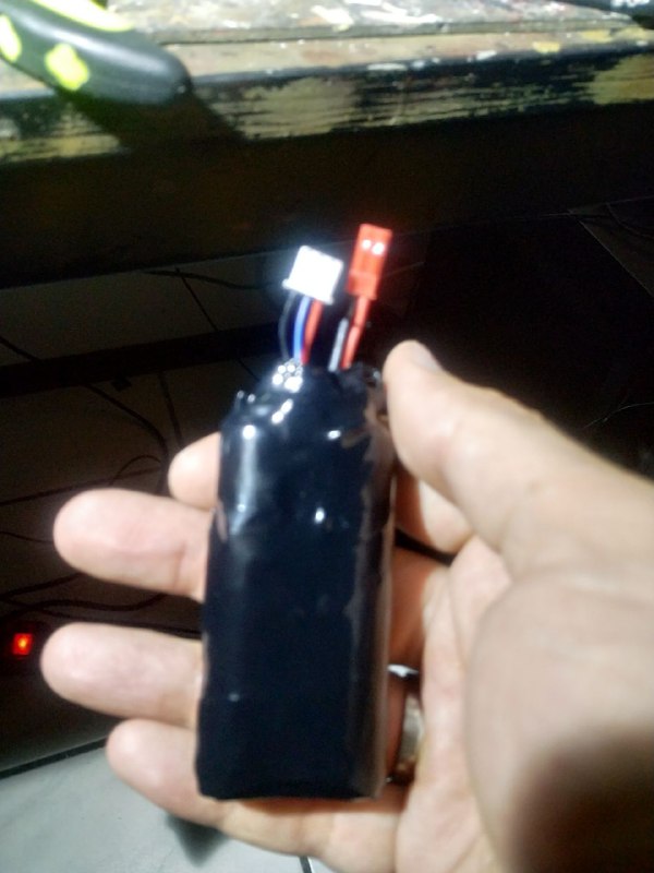

So I jumped into 18650 Li ion batteries, and I did 2 cell packs. When fully charged, those two batteries together give 8.4volts, and the radio needs only 5 volts, so it means it works. I got some chip protected 18650s batteries, so no overcharge or overdischarge is possible.
I cant be happier now. It is ugly, but after testing them for some time I can really say it works, and works very good.
It seems those 18650s are the future. Those are used in laptops, tesla cars, electric bikes, power banks and so on.
I will keep testing them, and if they work well, I will fit 4 of them in my tanks, giving me an oustanding 7.000 mah of battery. About 6 hours of use non stop.
Do I drive my tanks 6 hours non stop? YES, sometimes I do, lol.

I too am using these cells to power my Torro WSN tanks, 3 cells give you around 11.4v nominal, the same sort of voltage as the 8 AA cells recommended and they fit into the small battery compartment. However, l doubt your mah figures are correct. If wired in parallel you will increase the mah but only get the normal voltage 3.7v, not enough. When wired in series (end to end) you gain voltage but do NOT increase mah. In addition, the claimed mah printed on many of these cells is much exaggerated - mine claim 4000mah but its more like 1800. I can understand your apparent confusion as my retailer, Banggood, claims that if you use two cells you double both voltage AND mah! Not very helpful or truthful.
Still worth a look though. I'd recommend reliable retailers who sell genuine branded examples.

General Jumbo01 wrote:I too am using these cells to power my Torro WSN tanks, 3 cells give you around 11.4v nominal, the same sort of voltage as the 8 AA cells recommended and they fit into the small battery compartment. However, l doubt your mah figures are correct. If wired in parallel you will increase the mah but only get the normal voltage 3.7v, not enough. When wired in series (end to end) you gain voltage but do NOT increase mah. In addition, the claimed mah printed on many of these cells is much exaggerated - mine claim 4000mah but its more like 1800. I can understand your apparent confusion as my retailer, Banggood, claims that if you use two cells you double both voltage AND mah! Not very helpful or truthful.
Thanks for the usefull input but I have that under control, lol. Rule number one of aliexpress batteries, the ampers are usually exagerated. That why is so important to get official batteries from good brands like samsung, lg, panasonic and so on.
The ones I got, are 3.500. I charged and discharged them and I checked the mah, 3.400ish so it is pretty acurrate to the 3.500 they claim.
In the radio I have two batteries in series, so I double the voltage and I keep the +-3.500 mah (which is eternal for the radio, lol.)
In the tanks I am planning to wire 4 cells, 2 in series and 2 in paralel, and that will give me about 8.4v and 7.000 mah. Size would be like a 2S lipo, or 6s nimh.
But as I said, be sure to get original batteries!

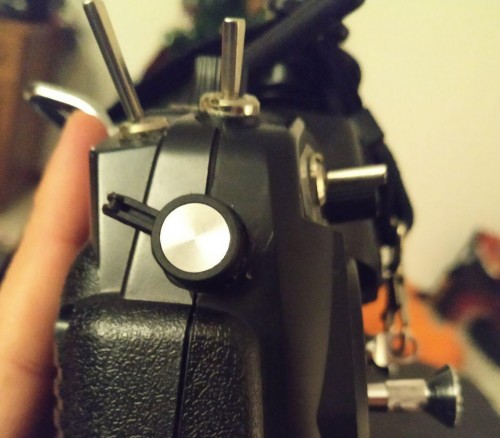

When I thought it was not possible to add anything else to my radio, I discovered I can add two potentiometers more!
So I ordered some, and they will be delivered in one week or so. I will have 4 potentiometers.
Do I need them?
YES! I do.
One controls the volume of the tank. Another controls the smoke machine, and the two new will rotate the cuppolas in my T54 tank.
The radio came with three pots, but years ago I had to replace one of them with a 6 pos switch (one of my best mods) but lacking one pot pissed me a bit. Now I will have it back and another extra. I am super happy!
I will upload pics when it is working :)

Well, as I already advised, I installed two extra sliders (side pots) So now I have 5. :D
At this point I think there are no radios with more functions-three pos switches-push buttons-pots than mine in the entire world, unless maybe something very technical and obscure. If somebody know something with more gadgets please let me know! I am always willing to discover new things, and I even might need that radio in the future!
Here is a pic of one of them.
Now there is only one last part to call this done, and it is a 7 positions rotary encoder. I am expecting to receive it within one month.
Please include me in your prayers, there will be a lot of risks of destroying the radio when fitting it.

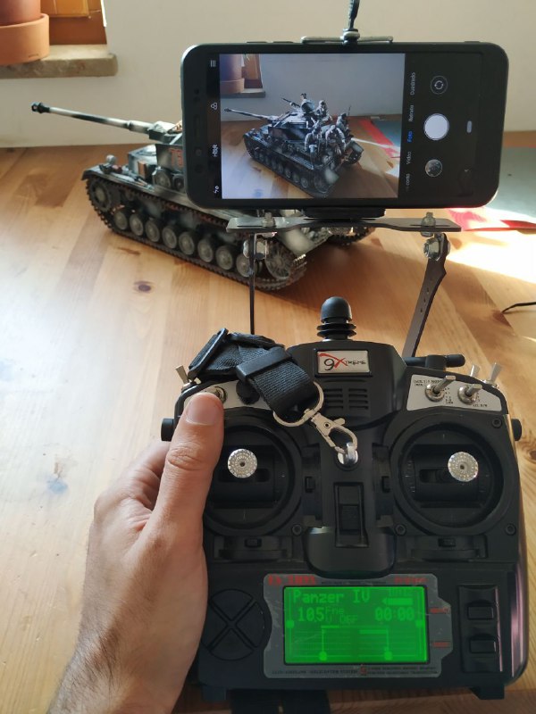

Today I wanted to show something I did some time ago and I did not show until now.
A phone holder! So now it is easier to make videos and take pics than before. I can also use it as a PFV Screen if I place a camera on the tank, or even modify the Elmod's parameters with bluetooth.
A very usefull mod!

I have that exact same set up on my tx as well. Except mine hold a mini screen which is synced to a fpv camera I installed. Very useful model indeed.
