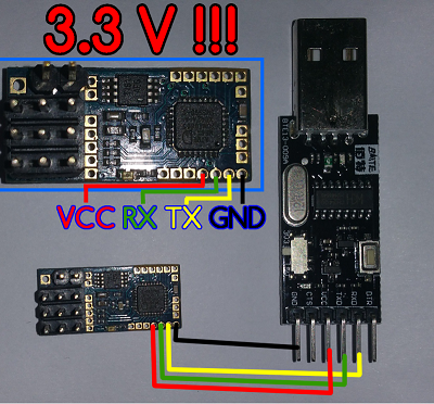

4) And a programer board. This is a nice point. DO NOT BUY THE PROGRAMMER AT BANGGOOD. Dont buy it alone, and dont buy the board that comes with it. It comes bad wired and it wont work, and also is over expensive. Buy a cheap 3 programmer like this one:
https://www.ebay.com/itm/Basic-Breakout ... SwImRYUYAV
And wire it following the diagram, BUT the VCC wire is not needed at all: (Warning, your programmer might have a different order of wires, but just follow the names. I mean, connect for example the GD wire where you programmer says GD) lol
If you already have the bang me good programmer, just take a look to it and be sure all the wires are like the diagram.

I've been waiting for this thread and will be following closely. I'll take a good look at my programmer after work and see what I have. I got mine from ebay, not bangmegood so it may be different. I know for sure that right now it doesn't have a standard j connector so I at least have to do something with that, but now I at least know where the wires need to go.

Max, I dont know what kind of programmer you have, but a standar J connector wont fit. The J connector and the normal pins are double the size you need. What I did in my small board is to solder some 1,27mm female connectors like these ones:
https://www.ebay.com/itm/10pcs-50-Pin-5 ... SwBahVC4Rz
I decided to solder the female ones in the board, because they are really small and the male ones are more fragile than the female ones.
https://www.ebay.com/itm/5pcs-50P-50-Pi ... SwMmBV0TOU
This makes everything a lot easier, specialy when testing the light options. Its always easier to plug and unplug things than soldering, specialy in such a small connectors.

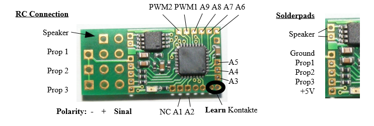

Well, this is the board we are working on. For wiring the lights, you need to put one of the led legs (I think the positive, but reversing polarity seems to not to be a problem, the led wont light but wont burn or explode) to A1, A2, A3, A4, A5, A6, A/, A8, or A9 and the other where it says ground. I think the output power is 5v, so you might need some resistors.
So when you are programming the board with the software, you can select which output you want to use, and what do you want it to do. You can program all the outputs to do whatever you want. Flashing, blinking, steady... So it has a lot of flexibility.
No idea what are PWM1 and PWM2 are used for, lol.

Here's the first mikro I bought, and the programming cable. It's a bit different from yours, Rad, but I think you'll understand it and be able to help me figger it out. Check out these two quick videos and they'll show you where I'm at
I guess I need to solder the connector to the mikro but those are some tiny little holes and they're really close together. Know any good video tutorials for soldering tiny little boards like this?
