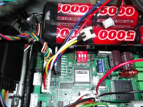

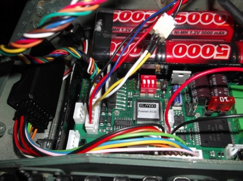

Just fitted the eco to my taigen kv. 1, now the 5 pin plug for the muzzle flash which goes into plug 2 , also has a little plug with 2 cables .Should it stay plugged so all 5 wires are in plug 2 or do i unplug that and plug the 2 wires red and black into plug 12 for the recoil. Thanks :think:

No help going on here. So i will answer myself. Emailed rctank.de and was told no i dont have to separate the 2 pin socket from the 5 pin plug and fit in the recoil 12 possition.So thanks me. :shifty:

Haha thats the video that got me asking the question to start with. He says on the video to connect the 2pin plug in socket 12, but turns out you dont.

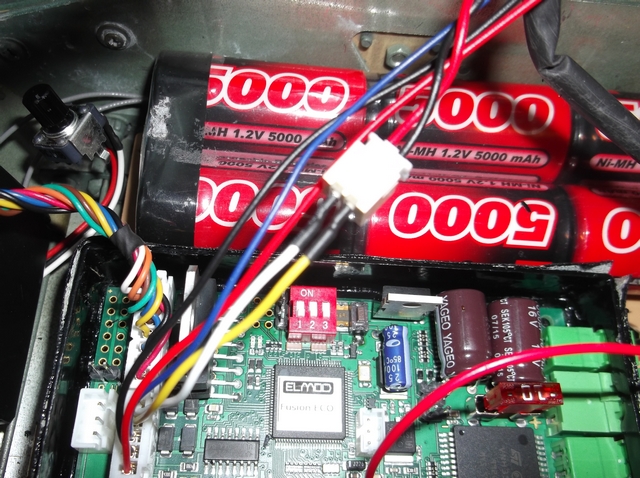

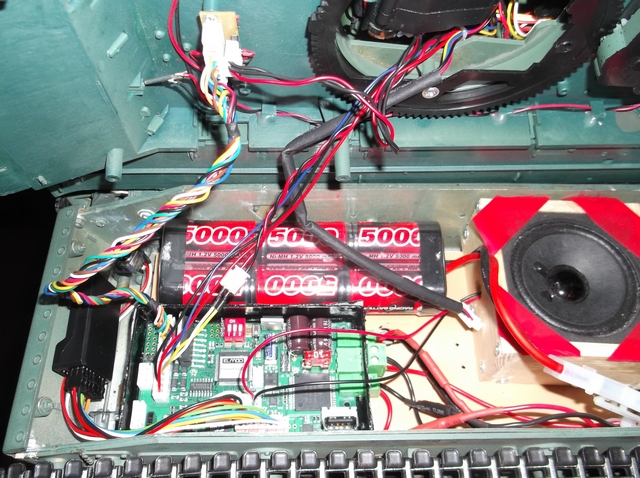

Ok this is how it should be connected, all working fine now :thumbup:

Captain Hilts wrote:Ok this is how it should be connected, all working fine now Image
Thanks for posting this Duncan it's a big help to all of us who are utilizing the stock recoil setup. I've learned quite a bit just researching this one.Image
