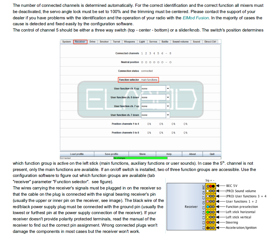

I'm assuming that you are at this point in the manual:
The board will auto detect the channels, however, you will probably find that the tx needs to make the Channel 5 and above functions active. It will give you the option to assign a switch or knob to the channel.
On my Flysky, this entails going into the menu and 'Auxiliary Channels'. By default it is set to none. Next to the knob or switch that you want to use is a label eg SWA, SWB, SWC. SWD, VRA,VRB. You select which one you want assigned to Channel 5, and save the settings (probably just exit the menu).

I have indeed been sat at the screen shown in your post Wibbly.
