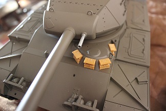

Heres a pic. Wrong for this tank but shows the potential.
Banana plug MG
Banana plug MG
