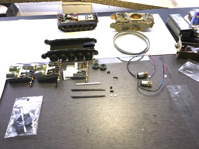

Make them move (MTM) has a unique gearbox setup in their RRC kit. I have found a good model for this gearbox. The Italeri 1/35 Crusader III 8)

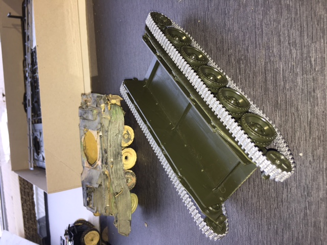

Going full metal tracks on this Crusader @) The next video will be with MTM gearboxes and Friulmodel metal tracks :O
here is a video of the right side plastic ITL track being run in on a stand. These plastic tracks are not very durable (IMO)and started to slip on the sprockets during a ~30 degree incline run.
https://youtu.be/s5IBp2N24AY
Here is a video of the Crusader running on the new METAL track.
https://www.youtube.com/watch?v=ejUtRRqQB68

After evaluating these gearboxes decided that the MTM is the way to go on this Crusader III

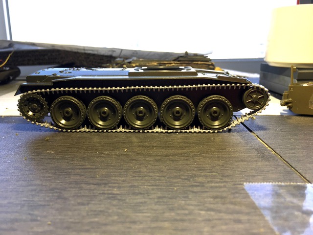

Axles are ready for trimming and fitment into the chassis

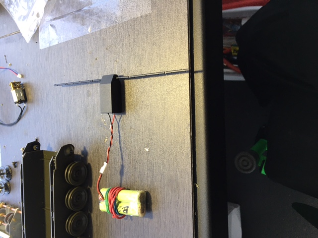

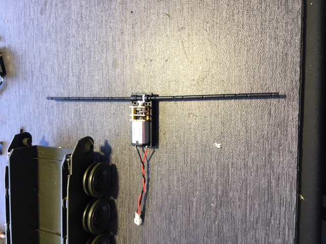

This is the left side gearbox. These are a bit tricky to assemble as the instructions really don't show much.

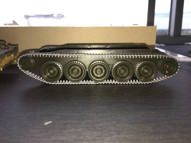

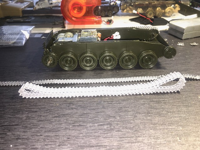

This is a far as I got today. This is not an easy model to assemble I mean if you want the road wheels to roll lol. Had a few issues but got it sorted out the the chassis\tracks are assembled and look good.
Certainly different than any Tamiya model. Road wheels and <br />sprockets\idlers all very different the way the are attached on the hull. Works good just have to pay attention to the instructions
This is a very interesting model, very nice tracks
IMG_8316 (1).jpg (73.26 KiB) Viewed 3846 times

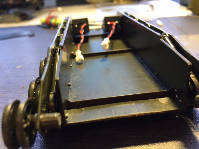

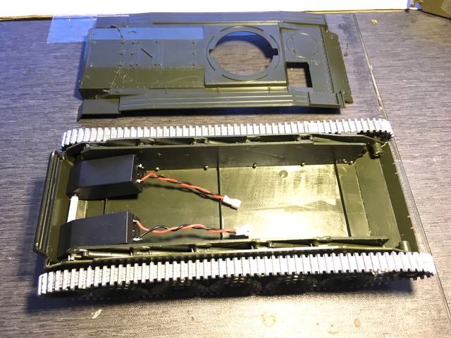

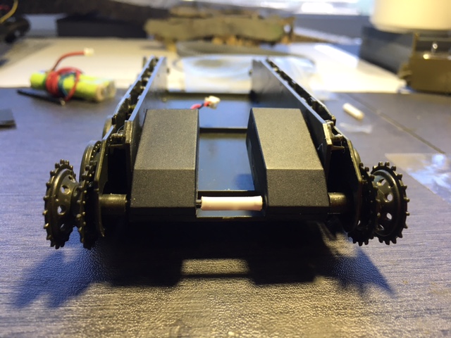

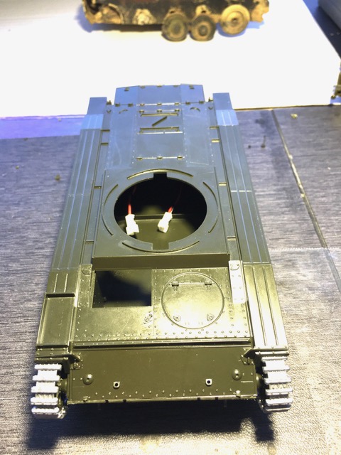

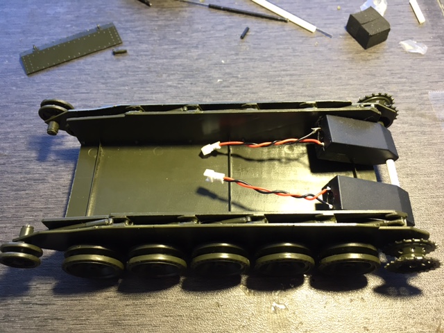

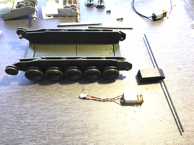

Converting the Crusader is proving to be a challenge using the MTM gearbox. I must be doing something wrong with the assembly of the gearbox and now I need more parts to continue with those. The Crusader tracks were a bit tight as there is no way to adjust the track tension without modifying the chassis of the Crusader and I snapped both drive axles trying to get a video. I will try to get more gearbox axle parts from Cush and then I will continue with the MTM gearbox construction.
MTM gearbox fits very good in here.
very nice model of the Crusader
Tracks are a little tight and put a big load on the axles
These things are sweet and even though I did not get them to work in this model, I will try with something else after getting some replacement parts for the gearbox's

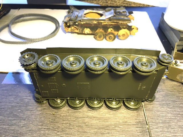

The gearboxes sure seem to fit well and neatly. Although it could be an effect from the camera lens, in the second-last photo, it seems as if the tracks are pulling the idlers outward. Is that so? Are those polyvinyl tracks?
Edit: I now see the answer to my question at viewtopic.php?f=33&t=33348&p=329783#p329783.
modler
Posts: 621
Re: NOS Italeri 1/35 Crusader III with MTM gearbox
Post by modler »
Herr Dr. Professor wrote:The gearboxes sure seem to fit well and neatly. Although it could be an effect from the camera lens, in the second-last photo, it seems as if the tracks are pulling the idlers outward. Is that so? Are those polyvinyl tracks?
Yes they are polyvinyl tracks. I think the camera angle made it look like the Tracks were "pulling the idlers outward" The Track tension was a bit tighter that I would like and there was no way to adjust them without modifying the chassis sprocket openings, and they worked great as first but failed after a short while. Cush from MTM messaged me and said the poly Tracks get too much traction and I would need to switch to individual Tracks link type Track. I have some experience with those that are made of plastic links and and will spin easily under torque therefore reducing the load on the gearboxes. I was doing a pivot turn when the gearboxes failed. That puts a huge load on everything when using poly tracks. Even worse are "rubber Tracks" like on my Panzer III :O
The Crusader III has very narrow tracks and I thought maybe I could get by and if I had adjustable Tracks tensioners, it may have worked. So I will be looking into better tracks although those things take a lot of time to assemble. I will look for ones already assembled as the last ones I tried to build took too long and I gave up :/

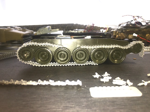

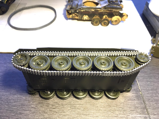

I looked in my inventory of parts and found a set of tracks that work on the Crusader so I am building them up now. After these tracks are built and working I will switch over to the MTM gearboxes.
slow but sure work in progress.
These tracks take a while to build.

Looked around in my old inventory of Tanks parts and found a individual link plastic track kit for early Panzer III, IV Tanks. They did not work on any PIII or IV that I have so they were never used.
I was driving the Crusader III chassis around when the right track broke. So I repaired it then drove some more and it broke in another spot so I realized the tracks in this kit are really fragile and are not suitable for R\C use and are good for display mostly. So I got to thinking about the above track kit which had 1 track 3/4 built and thought I will try this track and see if it works on the Crusader and much to my surprise they do :D They are a bit wider than the Crusader tracks but seem to work good. So I am running a PZ III ITL on the right side and the stock poly track on the left until I get another track built which takes some time to assemble.

Cush from MTM says I need ITL (plastic) to use with the MTM gearbox so I will use these as test tracks until I can find a Crusader ITL track.

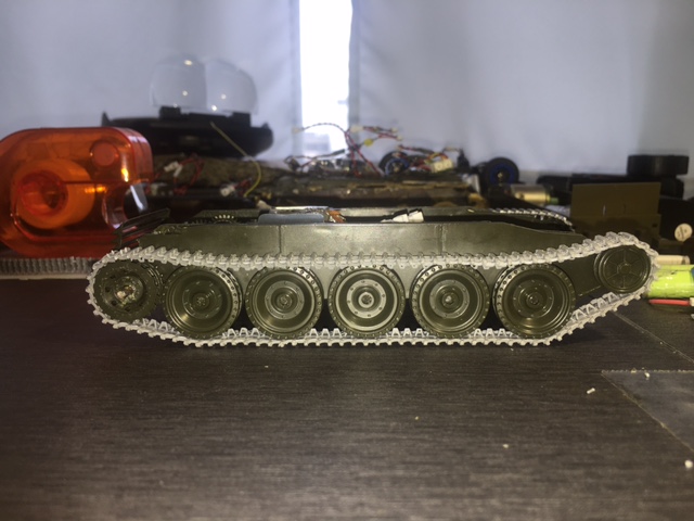

the ITL look distorted in this picture for some reason
Got lucky that they fit this Crusader. They are a bit wider but that does not bother me.
wow I like this. This track is designed as a &quot;posable tracks&quot; but I have plans to run them as active track on a R\C model.
wow I like this. This track is designed as a "posable tracks" but I have plans to run them as active track on a R\C model.
I started the assembly of this track 6 months ago for a Panzer III but it did not fit the sprocket properly and had given up on using it until now on this Crusader

I have an idea to make the MTM gearbox's adjustable as far as track tension is concerned using the same adjuster hole and screw present in the chassis now and beef them up as well 8)
This mod will make the MTM gearboxes removable and have a mounting plate that is compatible with the Tamiya gearbox so that they are interchangeable.
More on this as I get time.

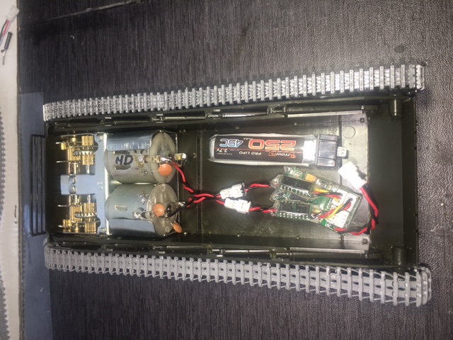

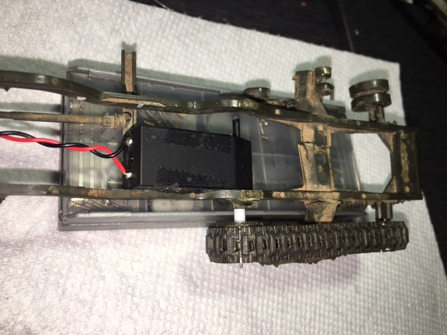

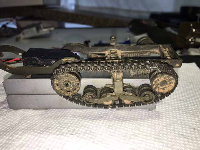

I had some time to look at MTM gearbox again and redid the axle with the last of the parts I had on hand on got one side working again and this time I altered the assembly of the axle and it seems more robust. I am getting ready to test it in a half track chassis to drive 1 track and see what happens.
reworked gearbox video
https://www.youtube.com/watch?v=kBy7XCbifjY&t=4s
ready for testing after the glue dries
fits in this chassis which is pretty small.

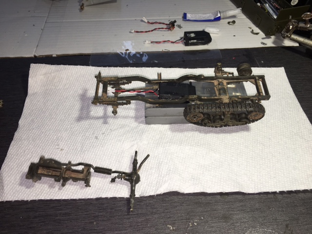

using this M4 Halftrack chassis to test the MTM gearbox rebuild.
