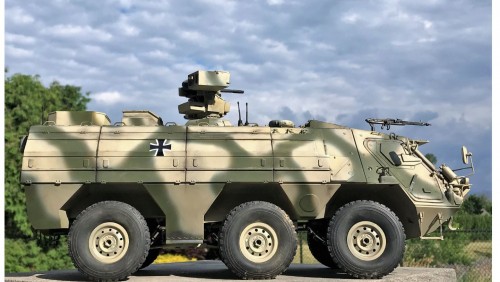

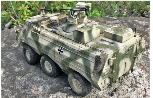

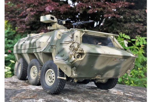

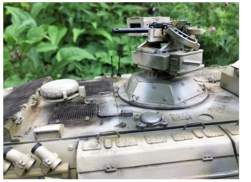

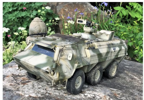

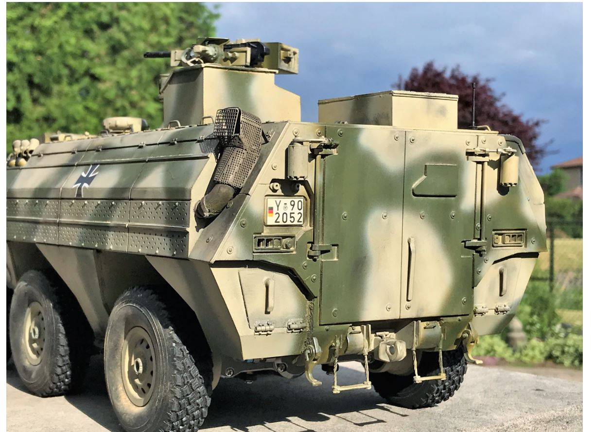

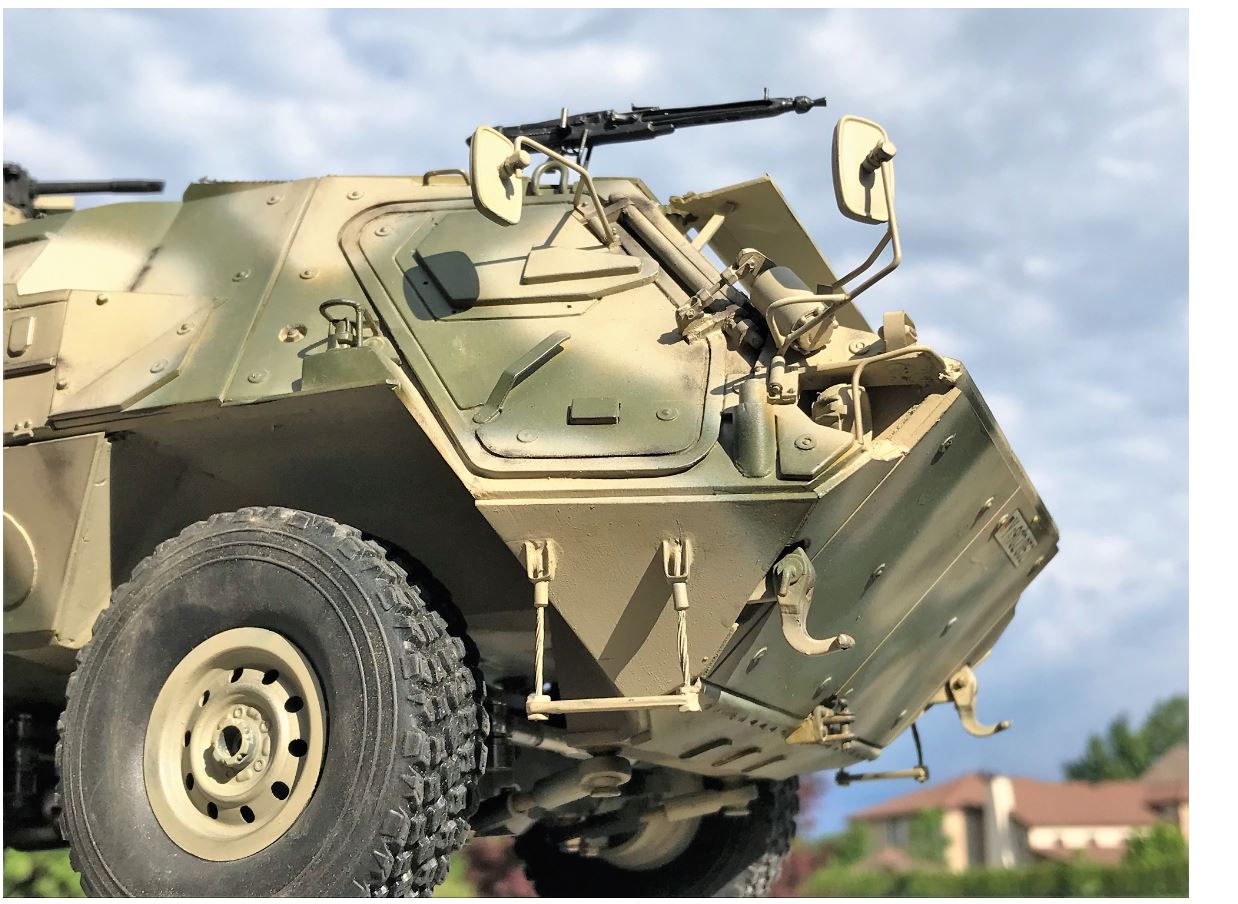

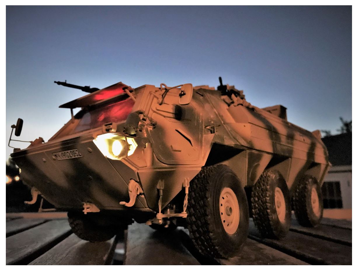

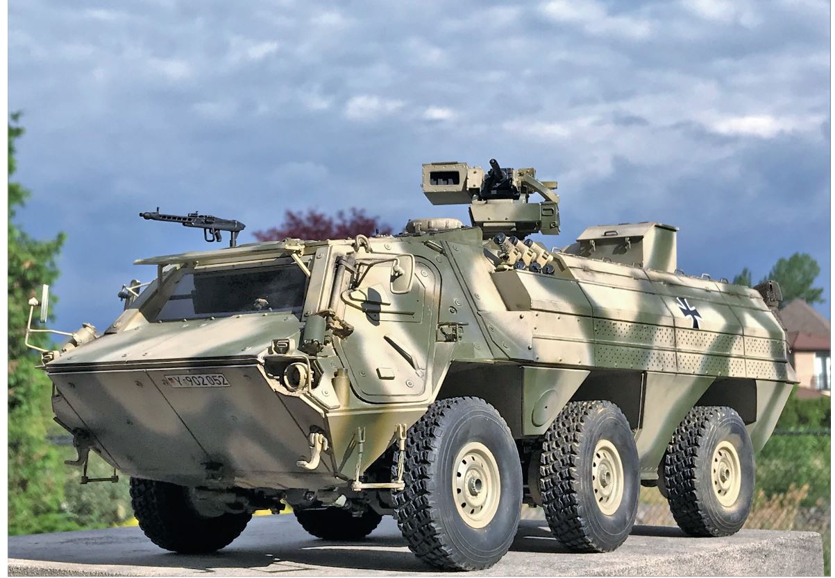

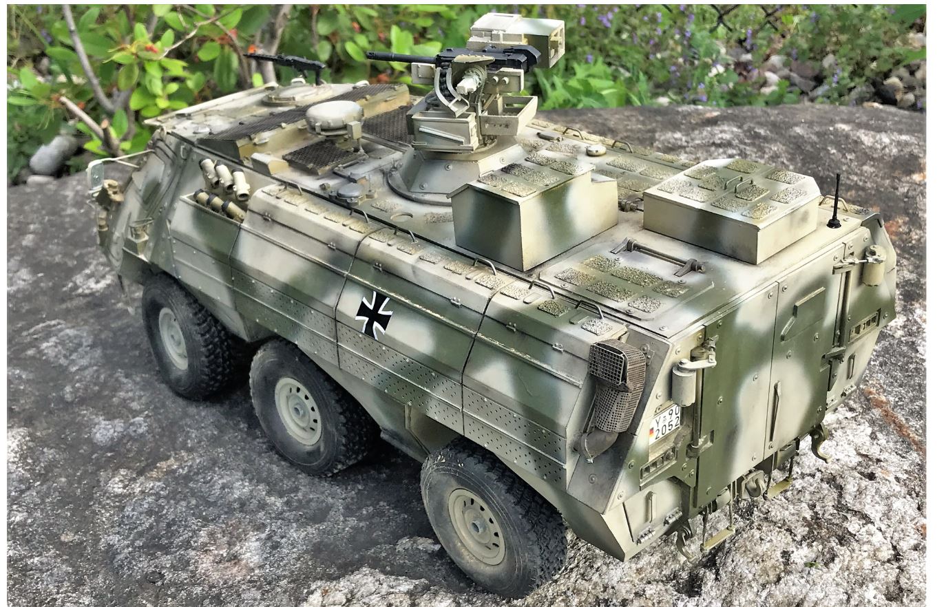

For the benefit of guys checking the Show Off section, here is an RC German Bundeswehr 6x6 TPz-1 A8 Fuchs TransportPanzer in 1/16 scale. The build can be seen at viewtopic.php?f=202&t=29533.
The model has the following features;
- Ludwig plasticard base kit
- Clark TK40 control board
- 6x6 drive with metal axles and steering on first 2 sets with dual steering servos
- Twin set of Metal Gearbox with 370 Brushed Motor for WPL 1633, connected to L and R engine connectors on TK40, with engine sound.
- FLW-200 turret rotation, with 40mm Automatic grenade launcher with elevation, gun flash and sound
- Flysky FSIA10b 10 channel receiver with S.Bus connector
- Head lights, tail lights and cabin lights.

Very nice model. The last picture, with lights, is awesome.
