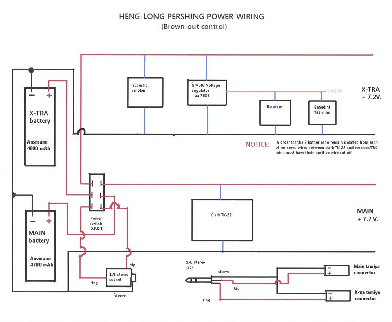

I decided, this spring to upgrade my H.L. Pershing to 2.4 Ghz.
I went for the Clark TK-22/ Benedini combo, an idea that was first proposed by Dan (Battle Armor RC) and successfully tested lately by reyemmanuel.
I already had a Hobby King HK-T6A V2 transmitter, already programmed to emulate the H.L. TX. (Thanks to Curtis, from Immortal Hobbies) and Dan’s instructions for coupling the TBS-mini to the Clark board made my system almost “plug&play”.
My personal touch was the addition of an acoustic smoker, driven by the Benedini engine sounds; and the anti “brown out” rewiring of the power supply.
Here’s some wiring diagrams and a couple of videos of my tank showing indoors and outdoors operations.
(Notice that within a radius of ten feet, the sound is loud enough to cause the camera’s microphone to distort. A comparison between the noise of the gearboxes and the engine sounds gives a better idea of the volume.)
TK-22,TBS-mini,Receiver wiring.JPG (76.8 KiB) Viewed 1780 times

Here's the last attachment...

Dang that is sweet, 360 rotation, that smoker you got hooked up. the gang is going to have to drive to Sudbury to do a Battle Day for sure. Great build.
