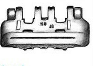

If you are planning to create an early Churchill Mk 1 as shown in the graph, you might want to recreate the early Churchill type tracks, different than the late type.
Churchill early tracks

I'm afraid I'm going to chicken out and probably build a later version with the straightforward tracks, the early tracks look kinda complex. :crazy: :haha:
