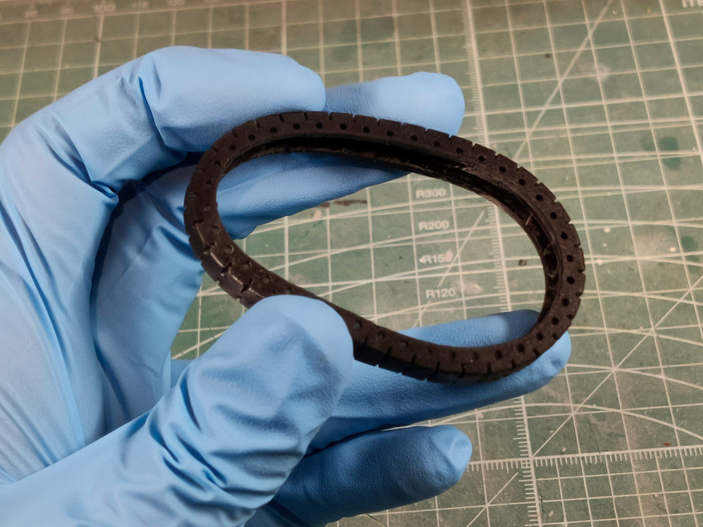

Spent the last few days trying to print with flexible resin; all of my exposure calibrations and test prints came out perfectly, but every model print would detach itself and stick to the vat. I had three attempts where nothing but supports came out. I was just about to give up and try something else but then:
Could do with some tweaking, but I'm really pleased with how these went. The surface is a little shiny and partially translucent; maybe more fitting for high fashion or fetish clothing than a war machine, but gentle sanding with 360-grit gives a nice opaque matte finish.

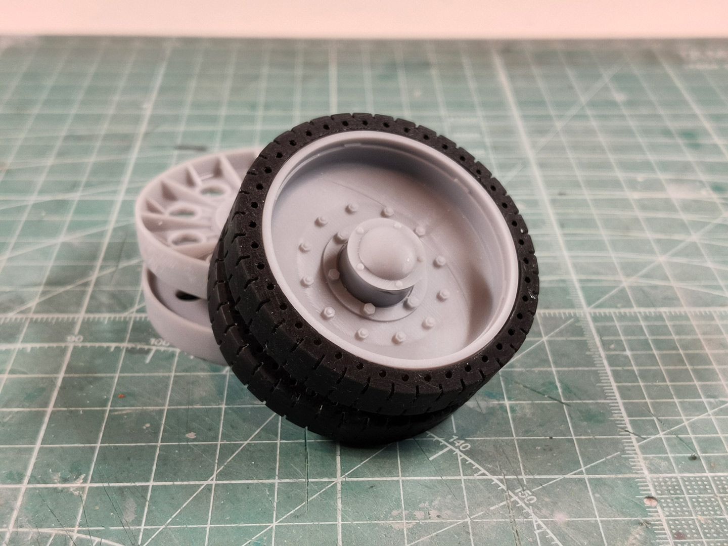

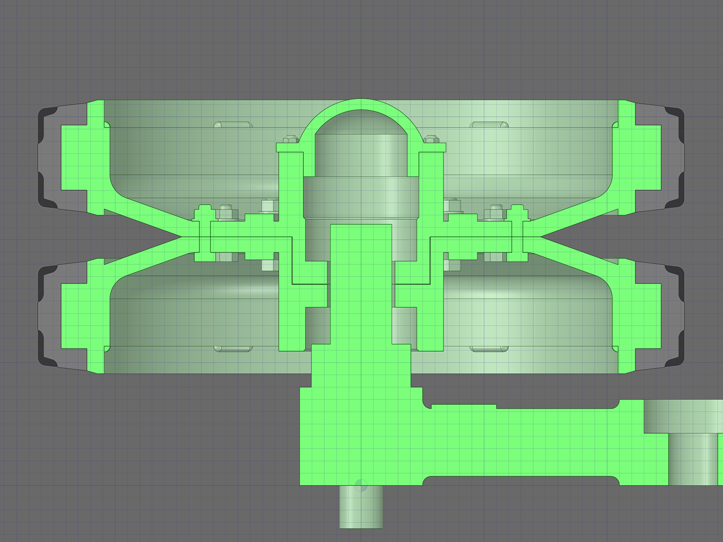

Yep, that's the plan. Should be a direct swap using the same hardware. The stamped wheels I'm doing for your SU-85 are specifically designed to use the metal HL swing arms and bearings, I'll send you a set with the wheels. You'll be able to take the plastic arms and wheels off the HL hull and install the new metal/resin ones straight away.HERMAN BIX wrote:Will the bearings out of the OEM wheels transplant into the printed ones ?
I've tweaked the design so that the weight is shared more evenly between the two wheels and the screwed-in bearings hold the two halves together. I'll get some test prints going and see how that works.
I'll make adjustments to suit the Taigen axles and bearings too.

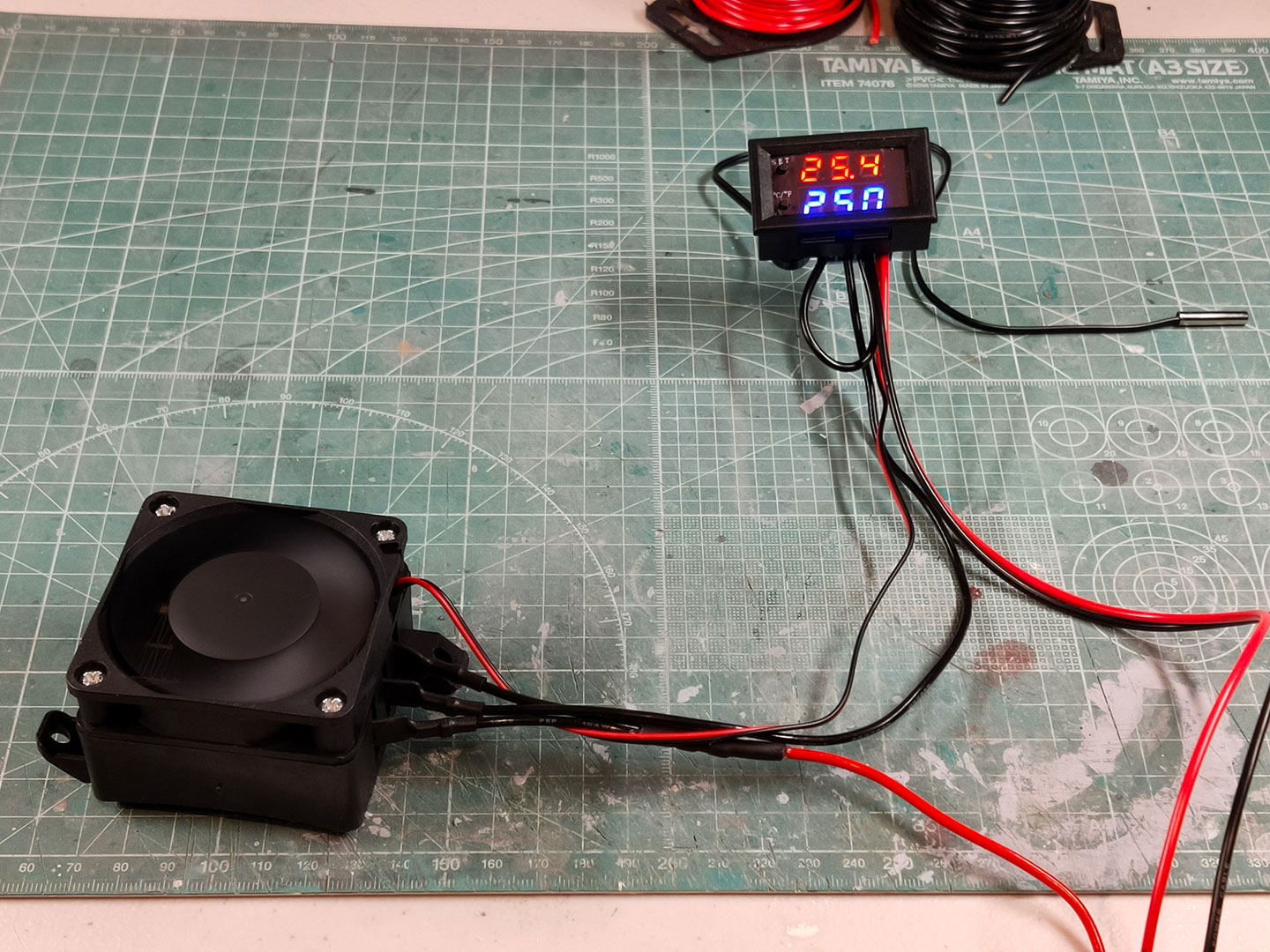

Hopefully shouldn't be too much longer on that front. There were two small packages in the letter box this afternoon; a 100W car heater cartridge and a thermostat/thermistor set.General Jumbo01 wrote:Only polystyrene though so still need those great looking printed ones once you are ready.
Got everything wired up and working, it was easily able to maintain a temperature >30°C in the printer enclosure during some quick tests. I'll try some prints with the strong Siraya Tech resin this weekend. Then I'll print an enclosure for the heater and controller so there aren't loose wires going every which way!

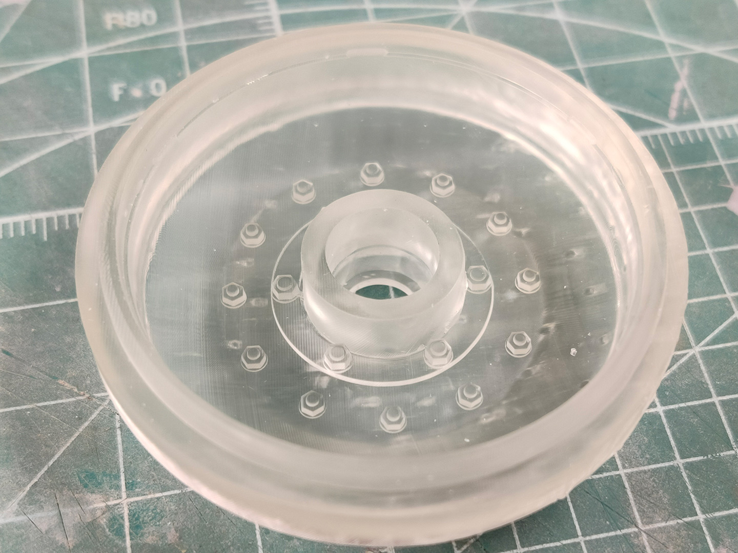

On that note, the heater in the printer enclosure makes all the difference. I've got some very crisp prints with the clear Siraya Tech resin, they look great.
There'll be some cleanup required around the back sides of the wheels where the supports attach, but it's no worse than removing sprue gates and certainly preferable to ejection pin marks. It's hard to photograph these things since they're clear, I'll have to give them a coat of primer so they're easier to see.
