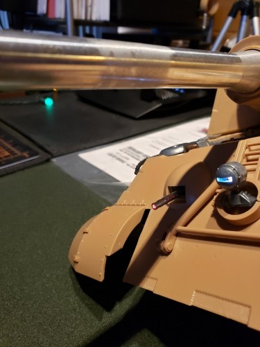

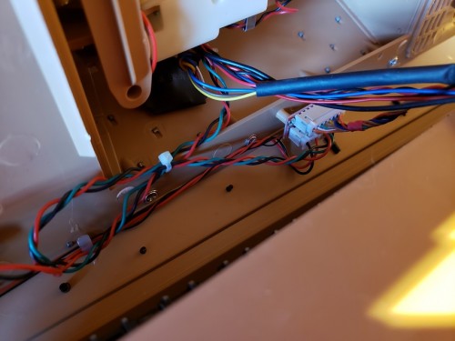

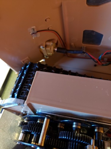

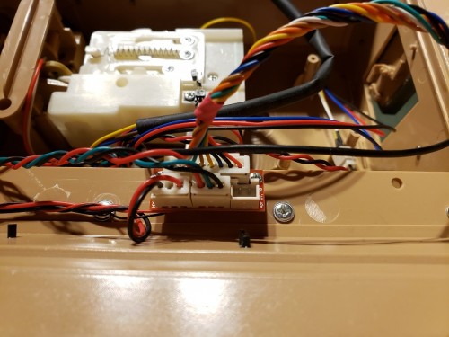

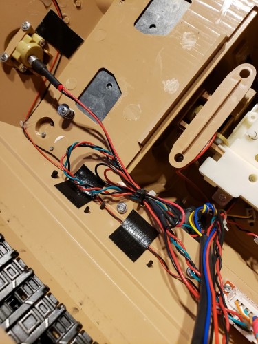

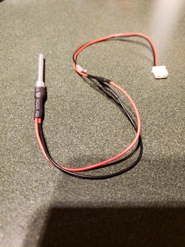

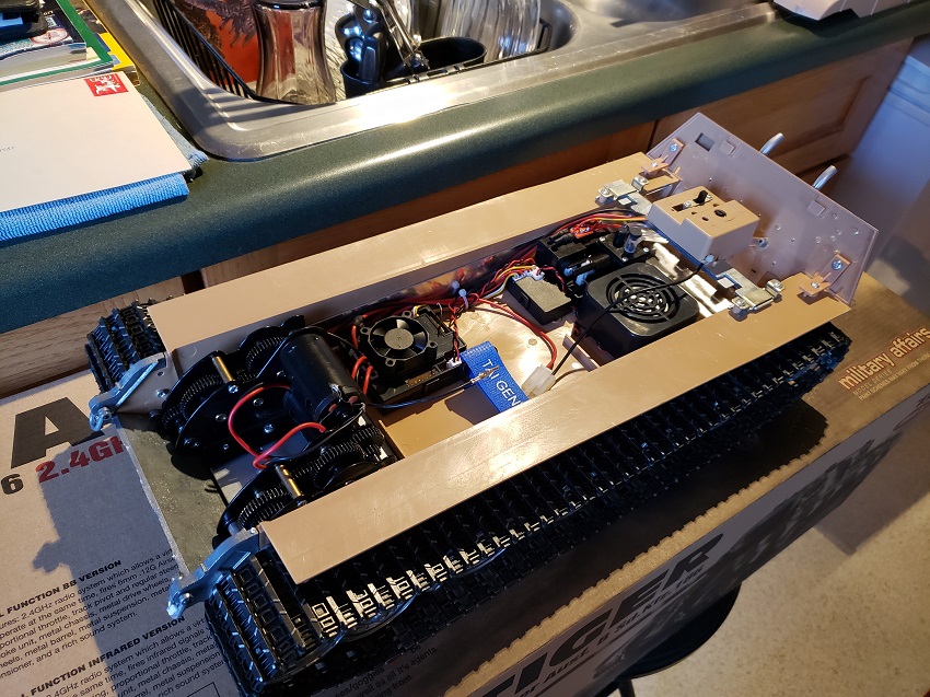

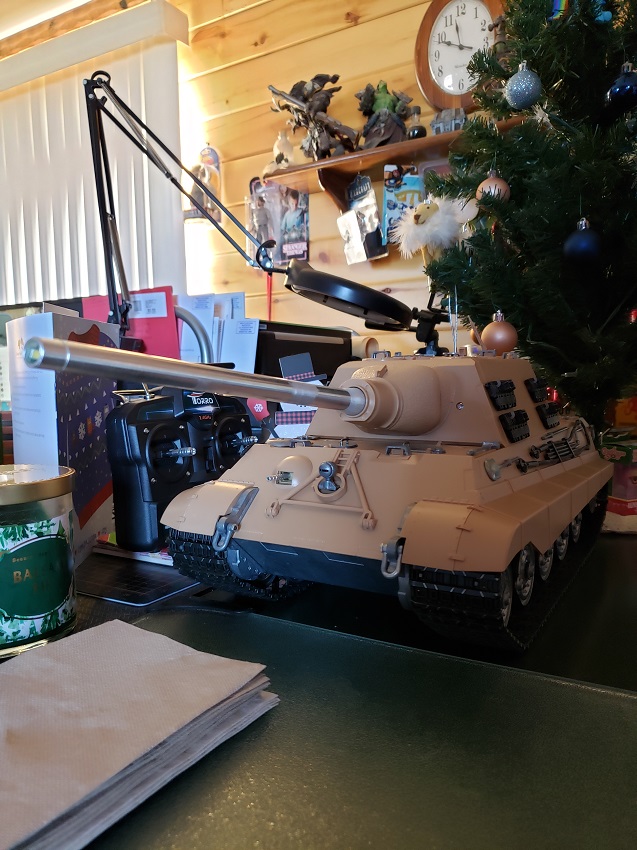

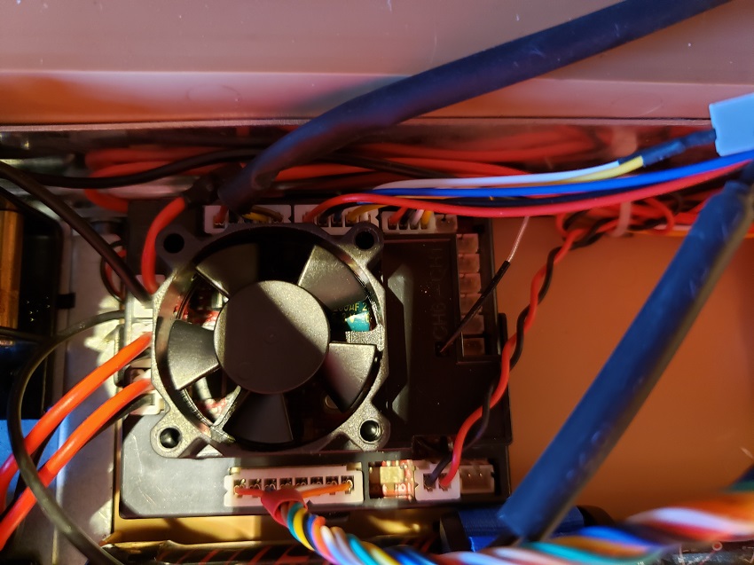

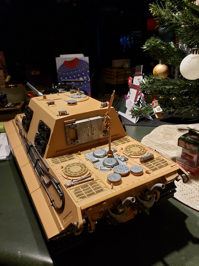

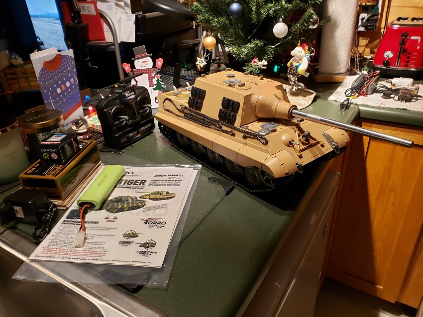

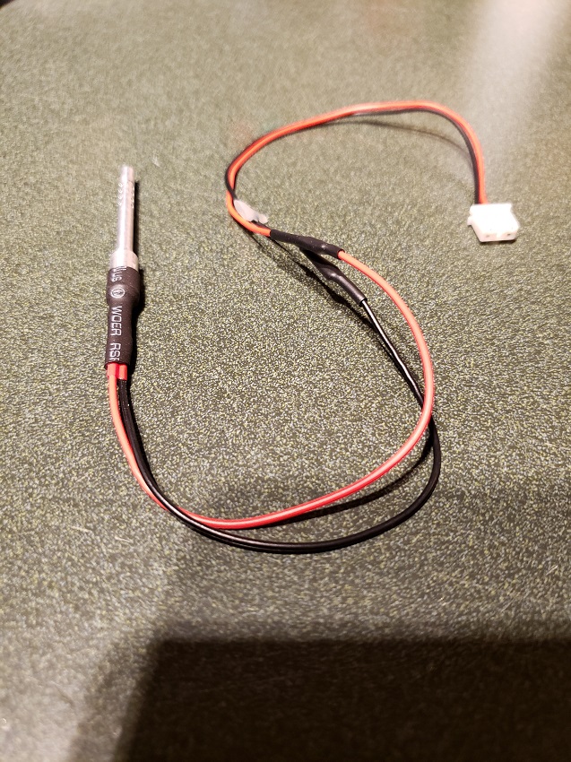

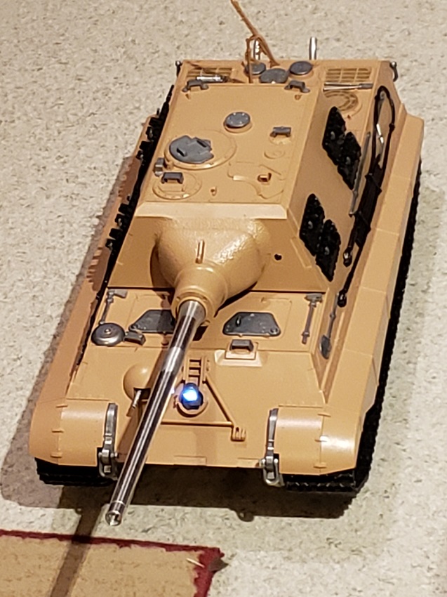

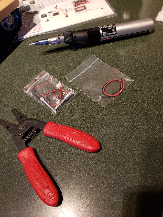

Well, Santa had other plans this year besides new tracks for the Stuart. I was very surprised to find this long coveted AFV under the tree on Christmas morning. I was just beginning to seriously put the Jagdpanther Build from last Christmas together when this Monster showed up. I swiveled direction so fast I think I hurt myself. ;o) Seriously, tho', I am awaiting parts to turn the Jagdpanther into an IR version w\ flash and recoil and this IR Jagdtiger is already set and ready to go. It was from a fellow out in CA who had quite a few of these and I cannot fault Grifter as he found a great Deal for an unpainted one here in the States. I normally buy from Taigen for entire vehicles but they had been out of stock for some time. The vehicle arrived with a couple of faults. Broken rear deck ( where someone got happy trying to push and lock the deck down ) and a non working bow mg. The deck I had repaired solid the first day out of the box. Looking at why the deck would not lock down, I put a washer apiece on the catches to lengthen them an 1/8 of an inch and the deck lock issue was resolved as well. On the way to repairing the bow mg, I removed the stock speaker and replaced it with one of Maxxmekker's Specials. What a difference in sound! You can feel the surface it is sitting on vibrate with the bass undertones of the idling Maybach. ;o) The bow mg had two issues, a suspicious looking melted area on the wires and someone at the manufacturer had put too short a length of fiber optic line in the barrel and it was not touching the bulb. I had originally thought, "Hey it is a plug in unit." "Just buy another" Easier said than done. Chatting with Dave from Forgebear, I got useful information and decided to just repair it myself ( It was during the fix that discovered the skimpy fiber optic cable issue ). The Smoker output was anemic as well but a closer examination showed how someone at the factory ( same guy?) had tied the exhaust tubing together under the catch for the upper deck and kinked both sides off. New tubing resolved that issue and the Smoker is working much better. So, aside from some detailing and picking a paint scheme I can move forward with this Detail Build. I cannot find a working Barrel Lock nor rear Deck MG so garnering some inspiration from an elder Matorro Jagdtiger Build by Jim Bob Wan, I think I can put the existing parts to work with movement. So without further babbling from me, Here We Go!
