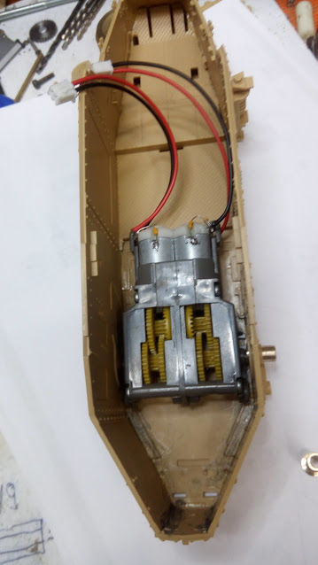

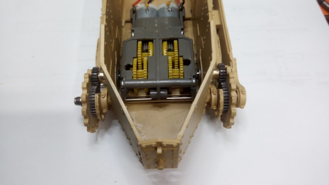

Together with my dad we decided to motorize Takom's Renault FT. Tamiya Twin Gearbox is used. Even 58:1 gear ratio is too fast for slow moving tank so my dad decided to make additonal gears outside the hull, which is similar to real FT.

Great start Kaczor, I like the addition of the extra gears, I too have been working on rc'ing one of these on and off for about the last 18 months :/ I have also used the tamiya twin gearbox unit but I tried configuring the gears in a different order, it made a slight difference in reducing the speed but it could still be slower :S I look forward to your development with this :thumbup:

Bigger gear was glued to the sprocket. The gears are exposed so in the future I have to avoid mud ;)

Nice little tank , you should ask someone you know with a 3d printer to print a pair of covers for the exposed gears.
