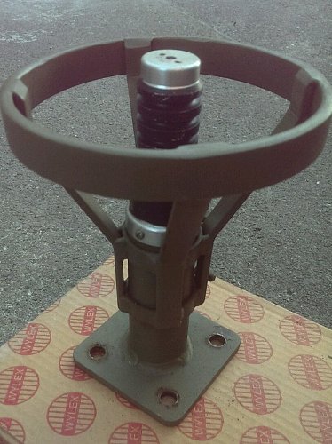

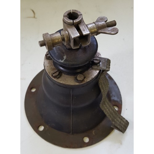

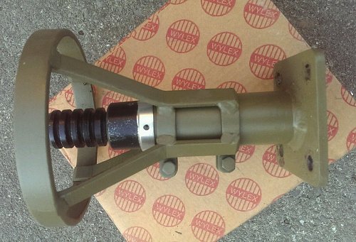

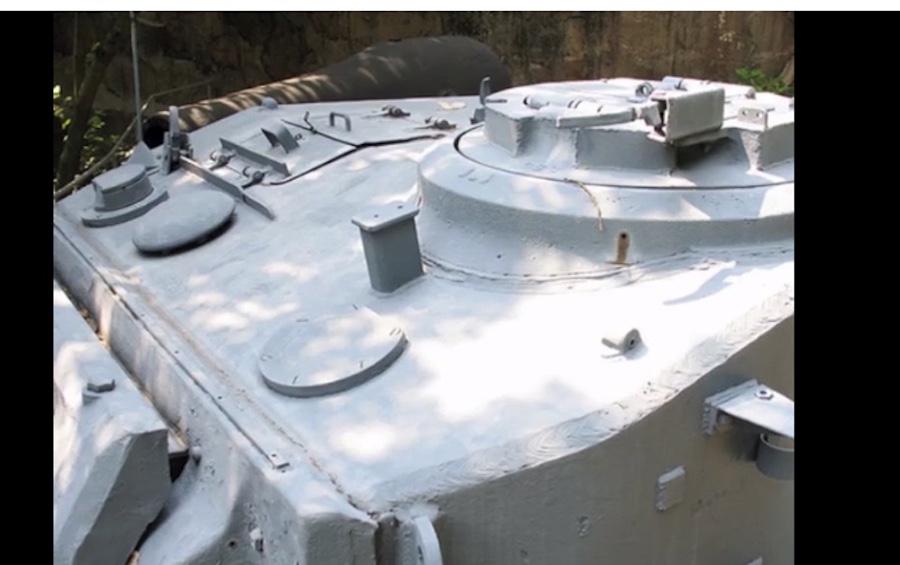

Here are the antenna photos that might help.
Peter

Sorry - did not purchase it - just found it for sale and then lifted the pics. I used to do this when restoring antique engines from USA as I was too tight to buy the parts and ship them from the states - I used to make them. Engines now too heavy to lift and machine now so found tanks (1/16) a little smaller. Holding and turning spanners also started to prove difficult.
Just looked at the Cromwell aerial - a little battered at present. Will need to make another one for the Black Prince so could try and get round to it early. Not a lot to show in the build yet and have just ordered some alloy plate having finalised a rough plan. Decided not to follow the readily available line drawing as noticed an error with the suspension against my Bovington photos.

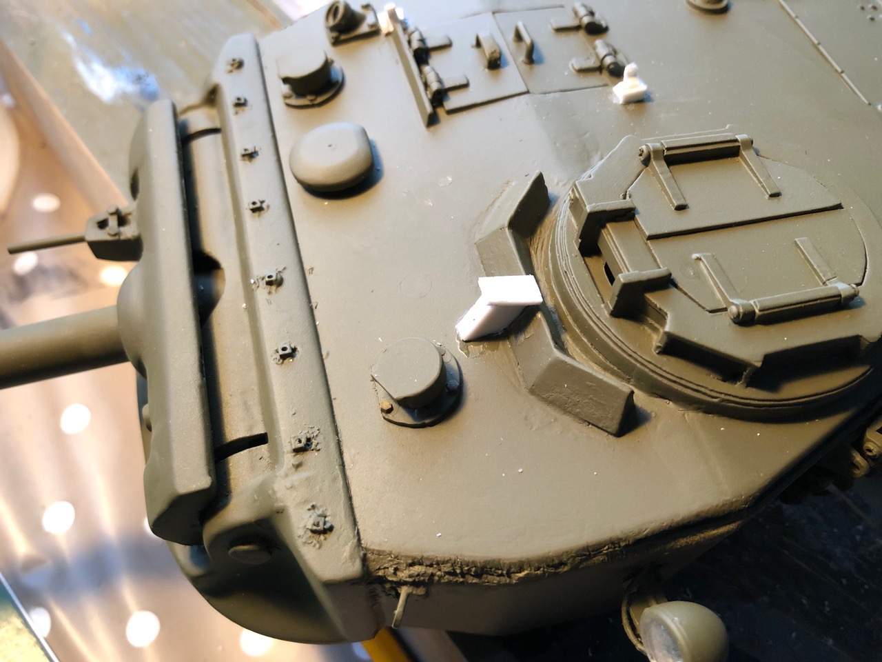

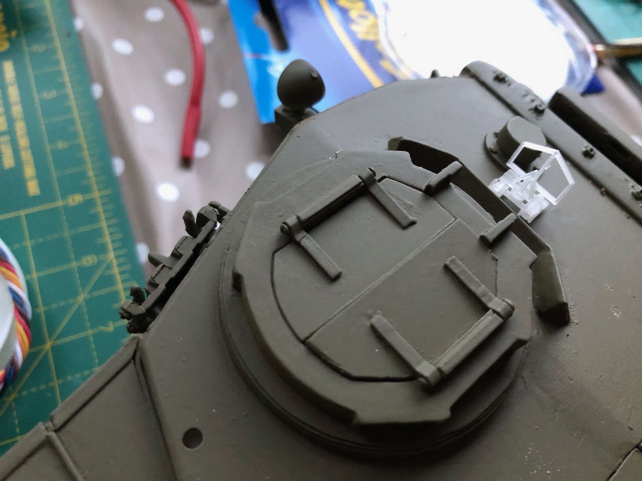

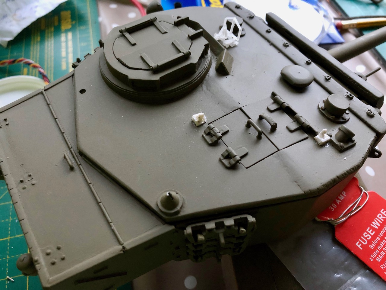

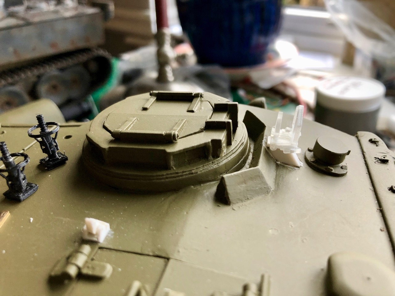

..a tiny update. This will be the Comet's gunsight. It's the same as the one on my Cromwell. I'll have to make a support bracket for this one. On the Cromwell, the sight is level with the Commander's cupola, but on the Comet the revised cupola was somewhat taller (to allow for the new vision blocks), and thus the sight needs to be raised up accordingly. To match the increase.
Comet gunsight
Comet gunsight
The catches on the Comet loader's hatch are different to the ones on the Cromwell: they oriented in a vertical position. I scratch- built them
Comet hatch catches and gunsight
Here, you can see the catches, and the bracket that supports the gunsight (which somebody's obviously purloined :/ ...) I'll look for it on eBay
Comet gunsight bracket and catches for loader's hatch

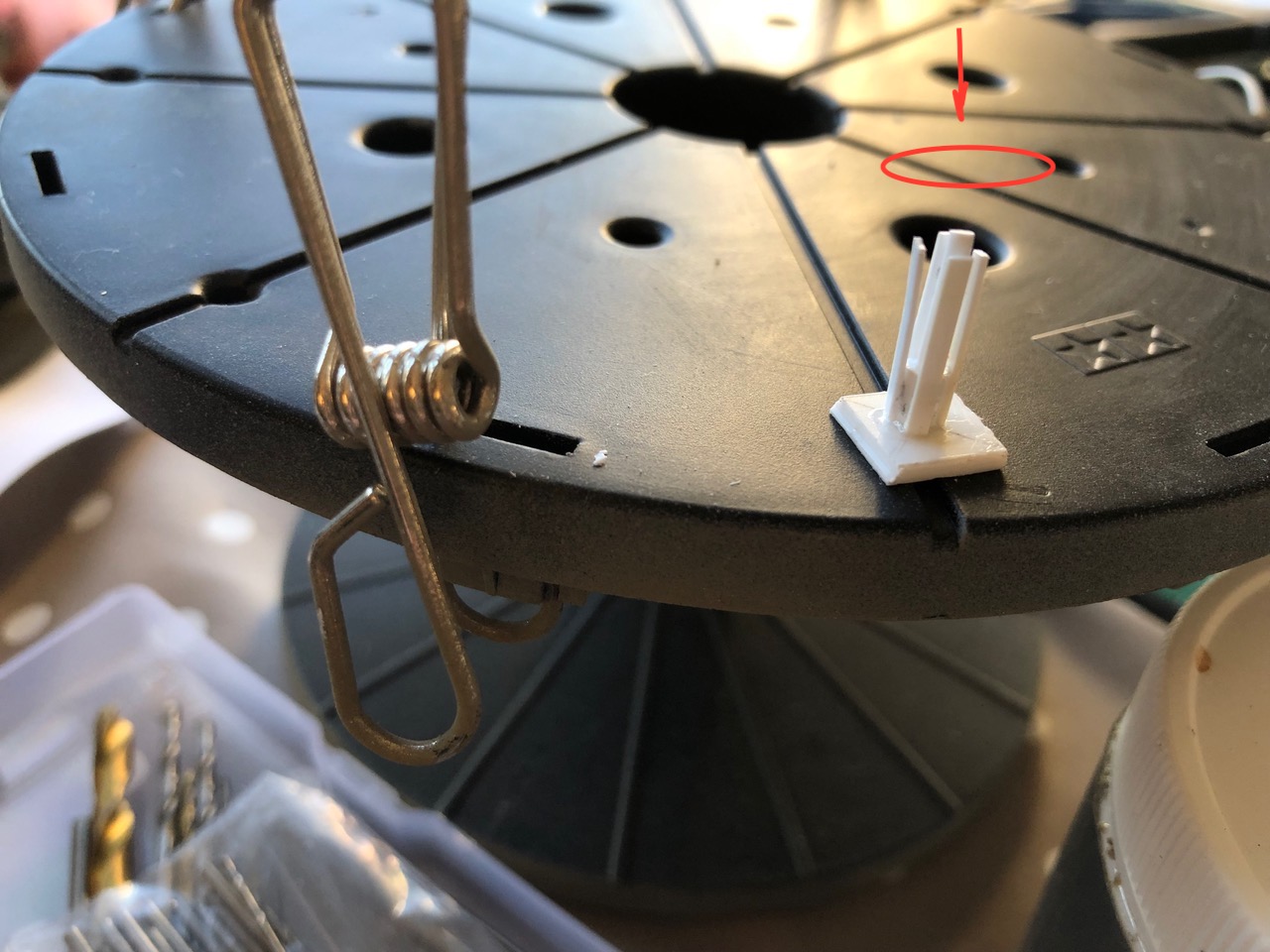

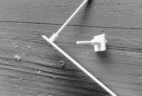

I started to assemble a version of the Mk 19 radio aerial base out of styrene plate and tube, before Enginepeter displayed his amazing expertise.
It was pretty much to scale. It began like this:
Radio aerial base
Radio aerial base
That's 1.3mm tube inserted into 3mm tube, mounted on 1.5mm styrene plate.
Then I added the four arms (1.5 mm styrene strips) at 90 deg intervals. So far- so...well, ok.
I made the 'halo' part of the radio mast's protective cage out of styrene strip. The idea was to bend the arms out, and bond the strips to the halo. Ok in principle..but the best laid plans, eh?
Comet-No 19 radio aerial base-B
But bonding them required octopus fingers. In the end, it was all too fragile. :thumbdown:

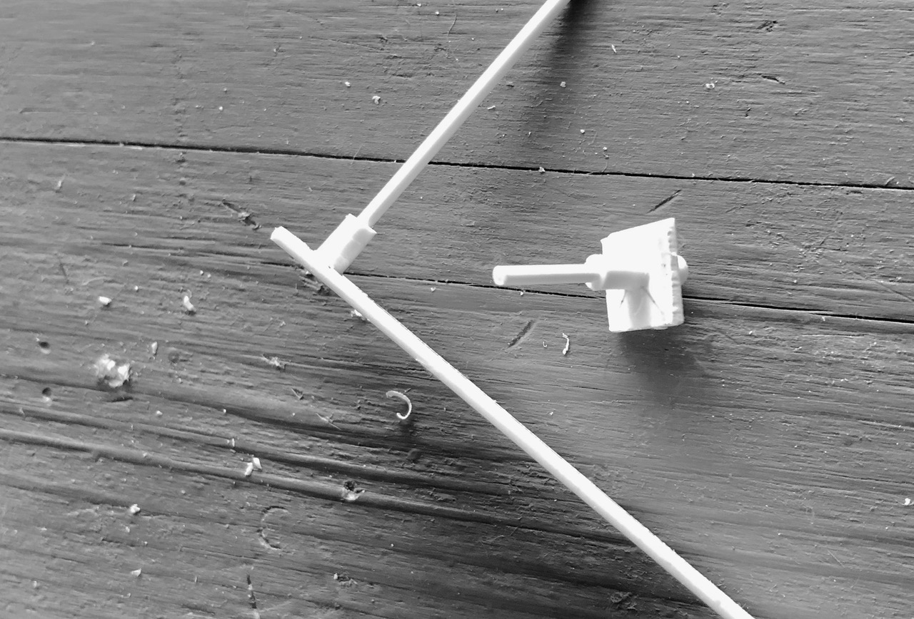

Then these beauties arrived in the post from Peter himself (what an absolute gent, and genius!!)
Now, potentially I could have the first Quadrophonic Comet RT set in existence! :lolno:
No 19 Radio quadrophonic aerials...
Which to use, hmm? Well, the ones with turned brass would be the obvious choice, but the halo might be a tad weak. The others are PLA, I think, and perhaps not as fragile. We'll see.

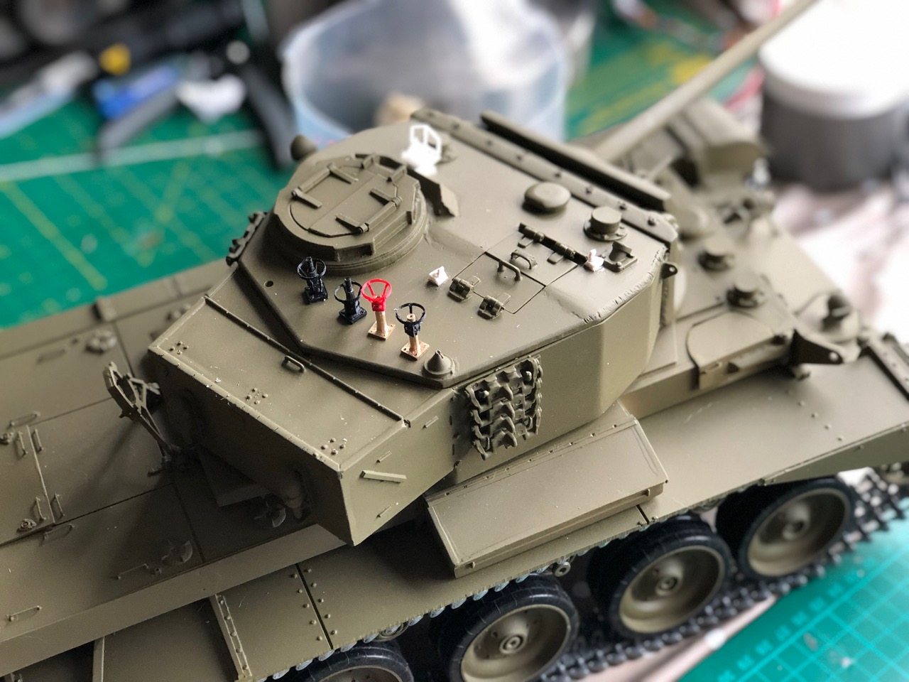

Then I made a mount for the Commander's gunsight:
Comet-mount for Commander's gunsight
Taking photos of white objects seems to be a problem for my iPhone 8 +. It's hard to compensate for, post pic. Still, you get the idea.
Here's the unit mounted:
Commander's gunsight mounted

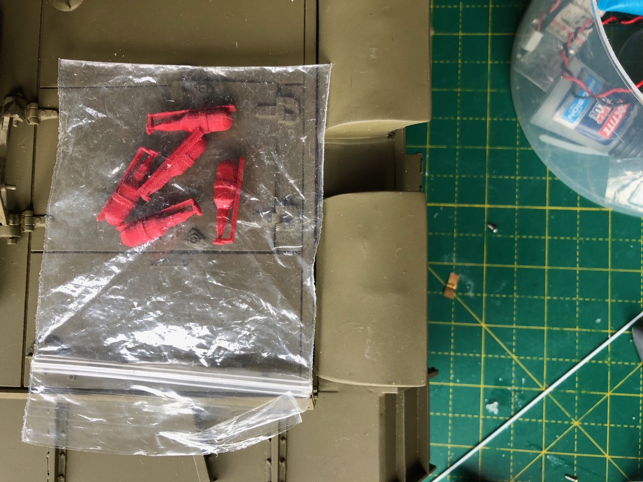

Finally, with generosity unbounded, Peter also supplied some fire extinguishers:
Comet-fire extinguishers.
They'll come in very handy on the Cromwell :thumbup: This Forum attracts some amazingly creative, and generous, people. I only wish I could be one of them. :| :haha:
