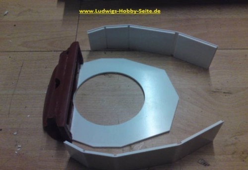

This is Christian's initial pic, by contrast:
Assembling the turret sides and Mantlet.Comet A34
Another thing to be aware of, if you happen to pick the Comet as your intro into the Ludwig world of Armour, is that the flexible sides don't exactly line up with their corresponding edges on the turret floor plate
:problem:
I had to trim the apex slightly, and the ends by the mantlet, in order to get the best alignment I could. Even then, one side refused to fit perfectly. Still, it looks OK from above. :D
