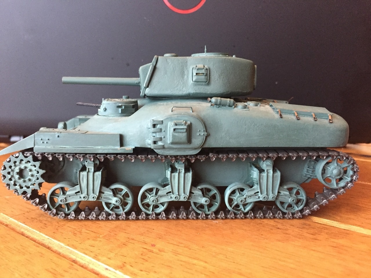

My next project will be the building of the Vandra RAM II Early model Sherman conversion.
The RAM II was a Canadian tank built in Montreal during the war. It was based on the M3 chassis and given a rotating turret with a 6pd gun. About 2000 were build but were replaced with mainstream Shermans before combat started in Europe. They are known as the M4A5 by the Americans. They were used for training and later for the RAM Kangaroo APC.
Ok, its not a pretty tank but its unique and available. Plus the machine gun on the lower turret will be interesting to operate.

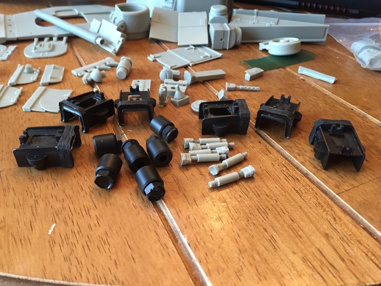

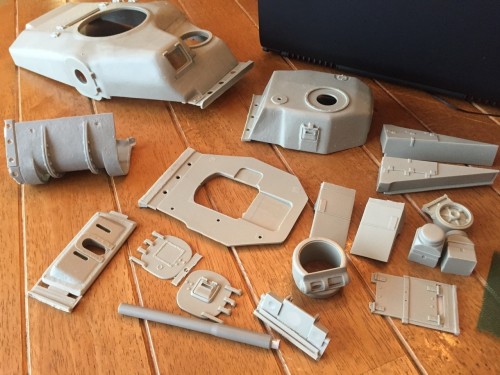

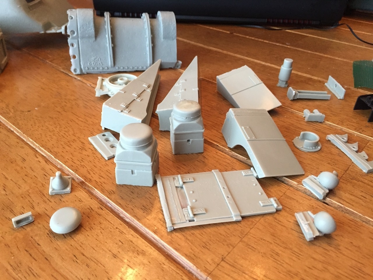

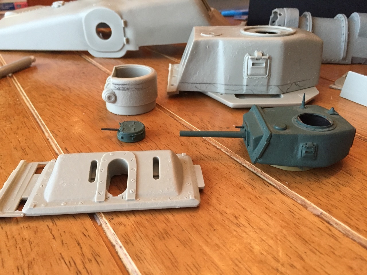

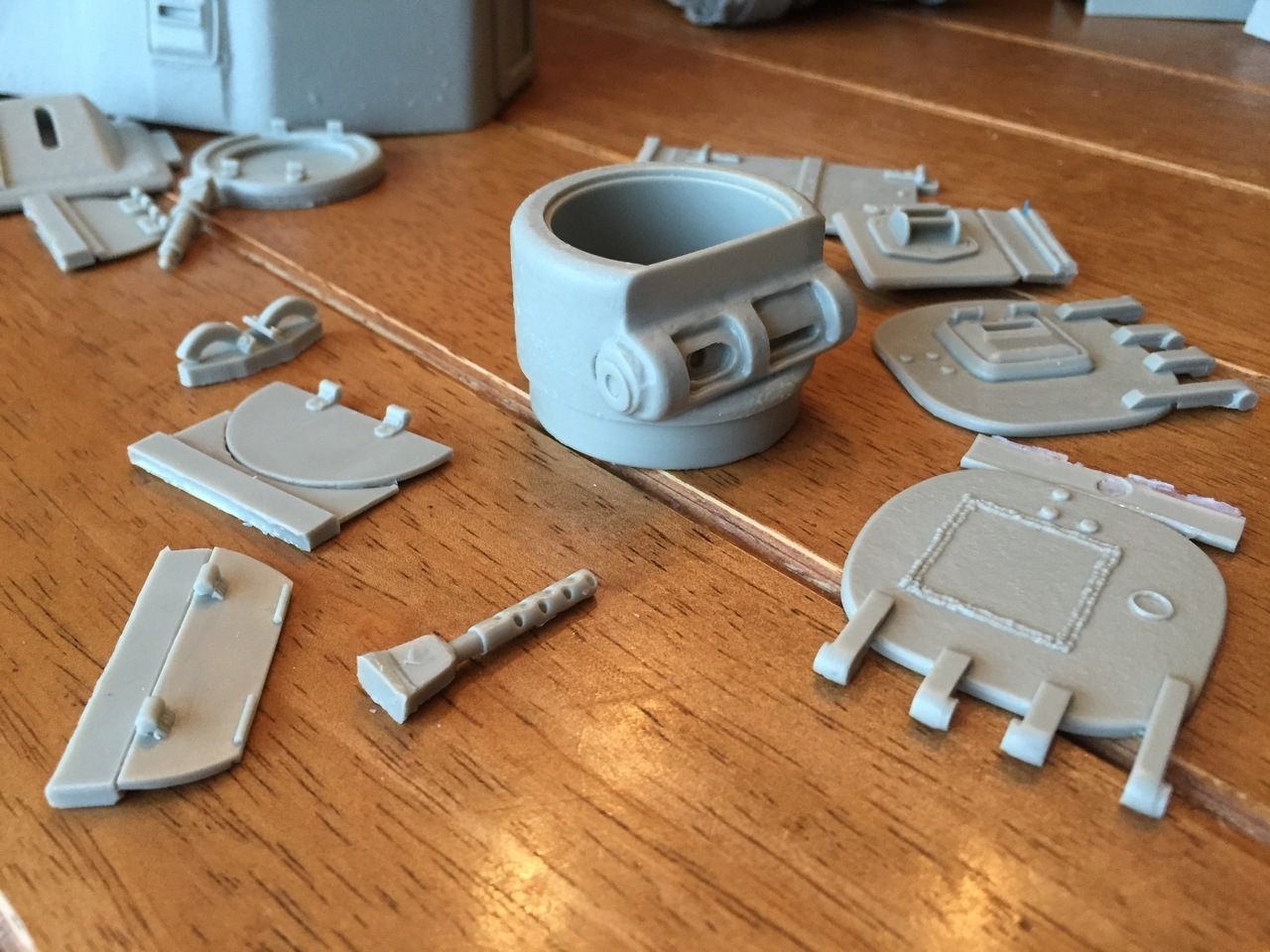

Here are the Vandra kit main parts. I am used to build their conversion kit so I know what I am getting into. They are not too expensive but require a lot of effort to make them complete and accurate. But with references, basic skills and patience, they can be turned into great and unique models.
The kit is coming with black plastic and resin conversion parts for the M3 suspension. After my experience with the Shapeways M3 suspension, I know that a lot of work is required to make the suspension look good and solid. I am planning to use these parts but they are unlikely to remain as they are once I am done with them. I am also unsure whether the resin connector for the rollers will support metal tracks or remain in place with glue. I'll see.

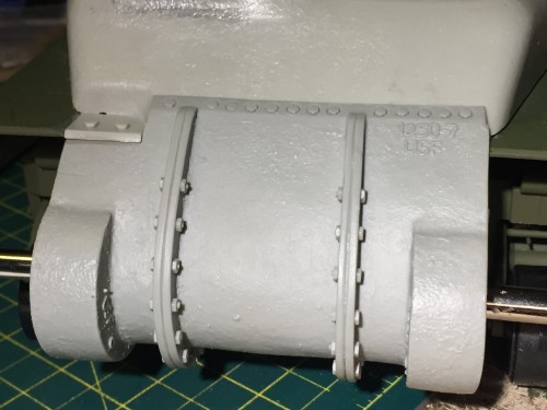

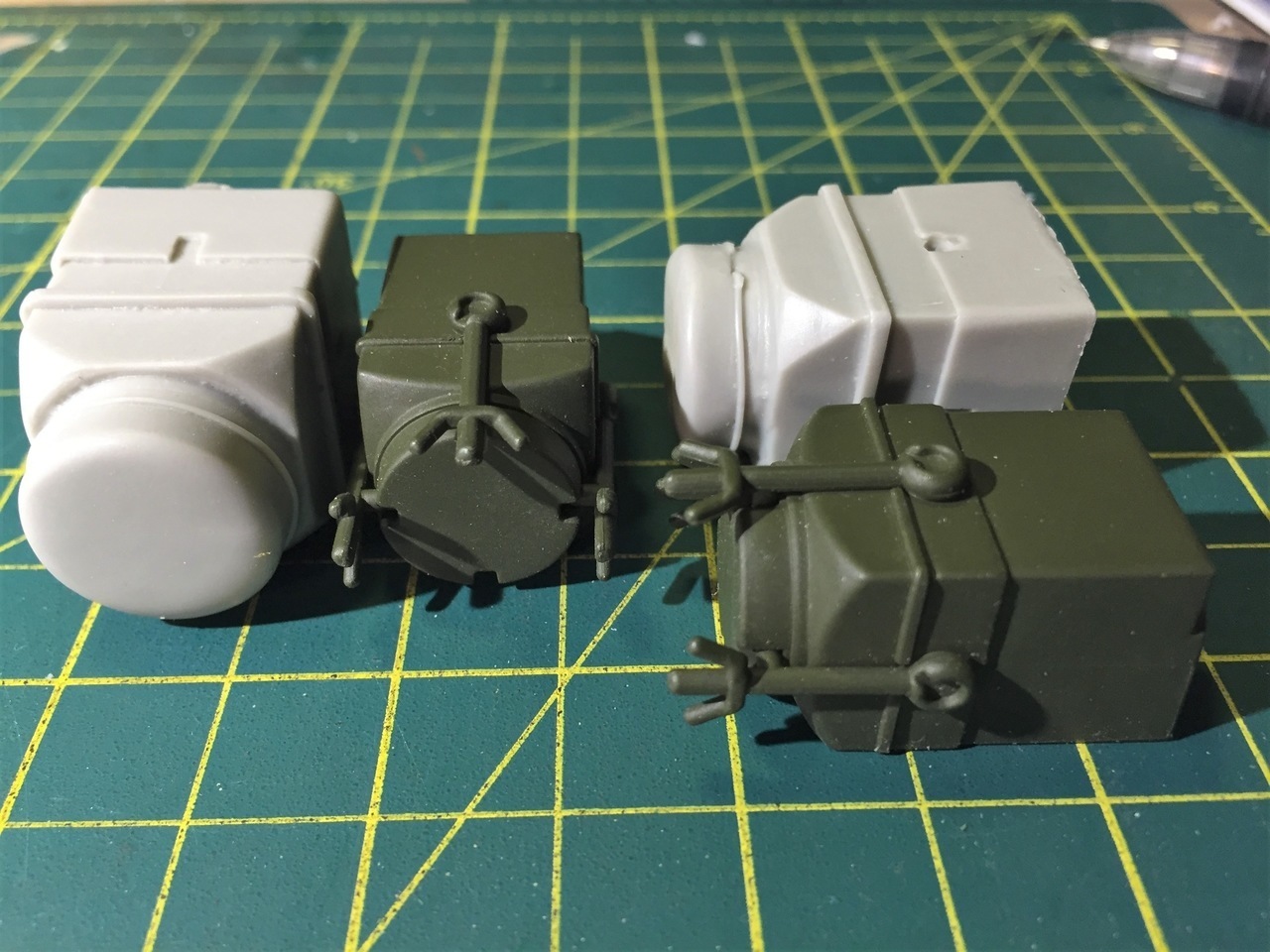

Having built other Vandra kit, I recognise many parts such as the 3 part transmission over, air filter, engine hatch,

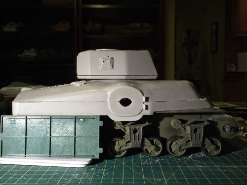

It does not take long to notice that something is definitely wrong with the upper hull. According to my calculating, it is 10mm too high, yes one whole centimeter... The lower deck for the machine gun turret is at the right height, its the rest which is too high or going down too low. So, the plan is to butcher the kit and make it accurate the best I can. I think i have identified most of the corrective measures. They involve cutting the main hull horizontally in two locations (different between front and back) and remove the required millimeters, glue the thing back together, use the dremel to rebuild the joints, shape and redo the cast finish with putty. We can call this plastic surgery... Cutting tanks in half does not scare me. The resin is quite thick so I should be able to make the whole operation seamless. This will be a special ops that will require additional planning. The machine gun turret, front bins and side doors that are equally too high will be adjustment accordingly, turret at the top, doors in two places, bins at the bottom. The ring for the machine gun turret also need to be reduce by 1mm. SImple... well, that's the plan at this time. I am telling you Dean, this will be a nice looking Ram.
As for the main turret, it is at least 7mm too high. So, the plan is to remove the shaded area at the bottom of the top part (easy), and then glue to the turret base. It should then have the right height. As for the gun mantlet, it is strangely exactly at the right height and should fit the lowered turret more accurately. This is good news because cutting the mantlet would have been difficult.
Some bump at the rear deck needs to be removed. I have not seen this in references.

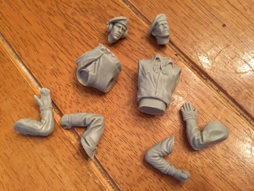

The kit came with two half figures which look good.
All measurements and corrective actions will be detailed more accurately in following steps. I question myself why Vandra does not use a ruler in their measurements. Maybe the extra mm in height are required because of some reason that i am about to find out (gearbox height, HL chassis fit, gun elevation ??), we'll see.

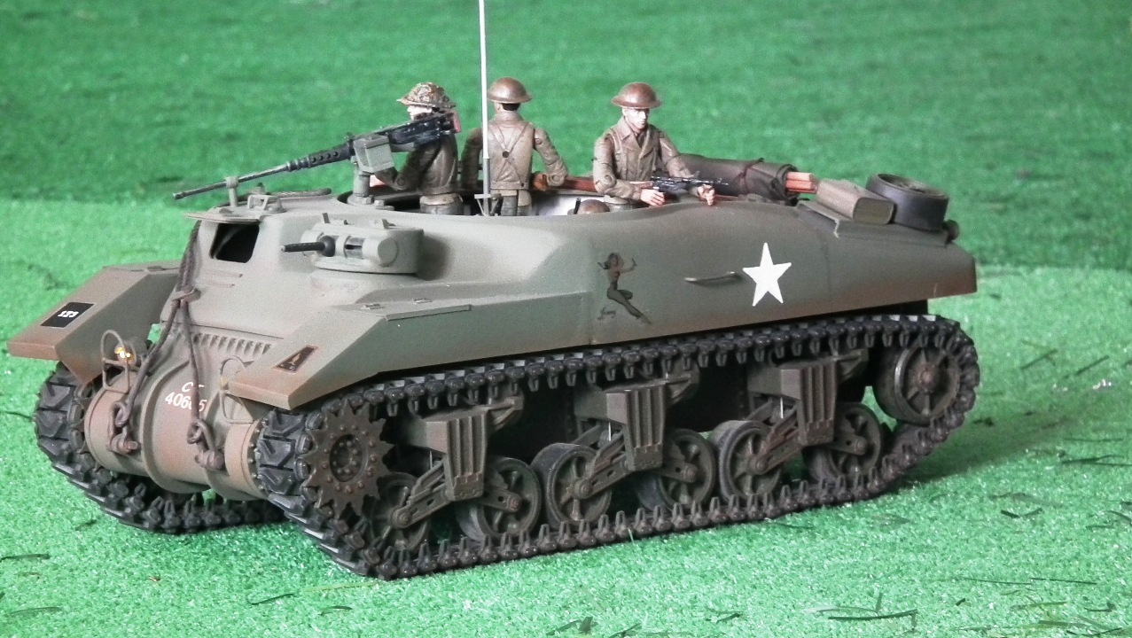

First, a short post on references being used, other than the web of course. Books on the Ram tank are rare.
Canadian armor in detail. Great book on Canadian WW2 Ram, Sexton and Grizzly tanks with pictures in color.

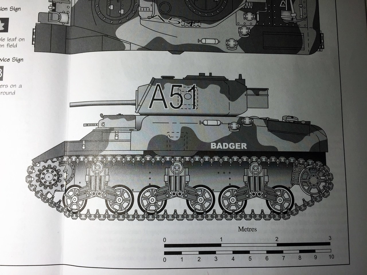

The Ram, by Paul Roberts, Canada Weapons of war series. Good book with black and white pictures, one graph page with 1/35 scale plan that confirmed the Verlinden measurements.
And the old AFV publication no 13 on the Ram and Sexton
Regards, Louis

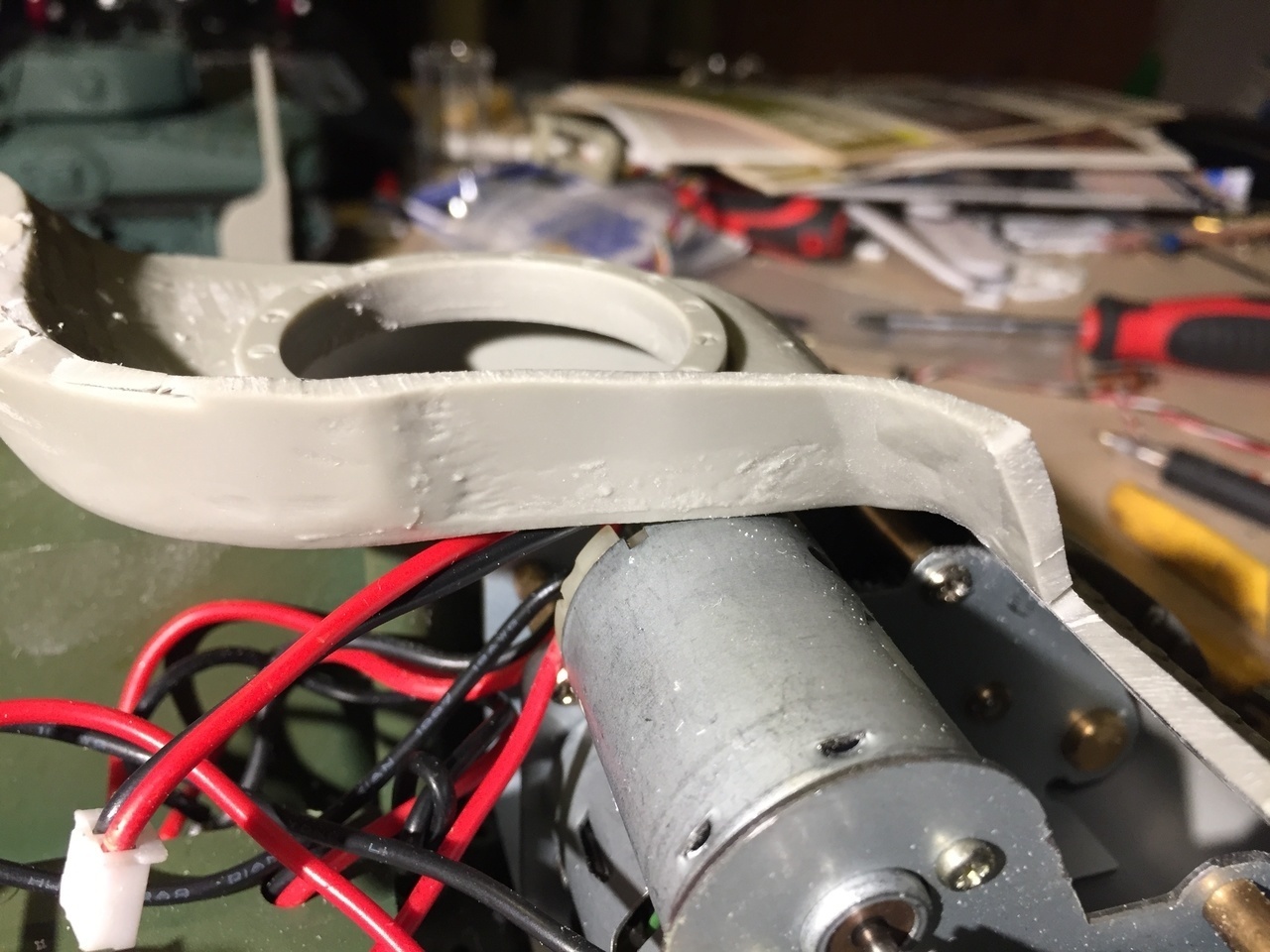

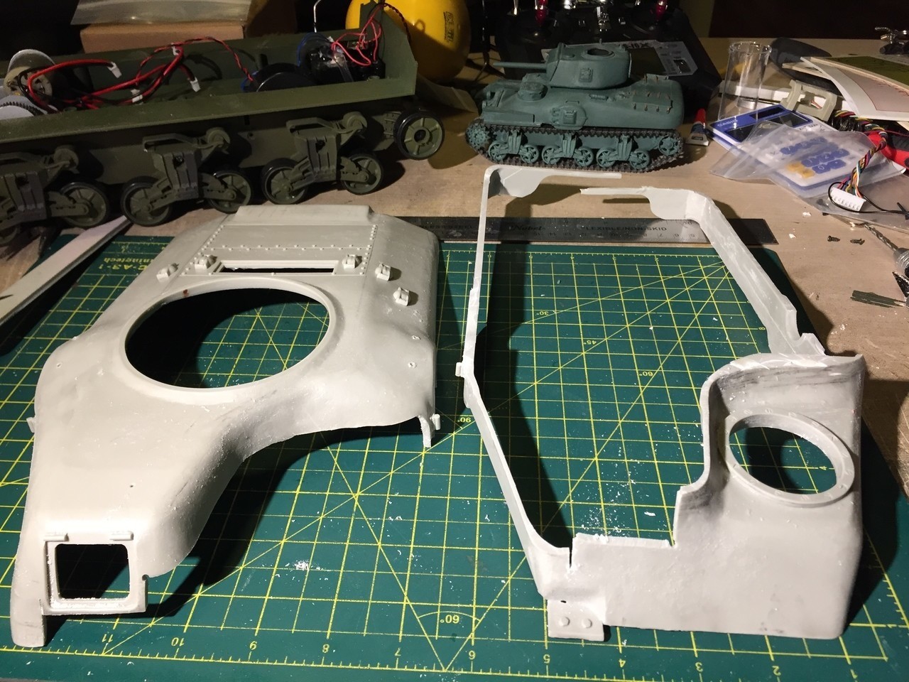

Re: Vandra Ram II Canadian Sherman conversion - Build

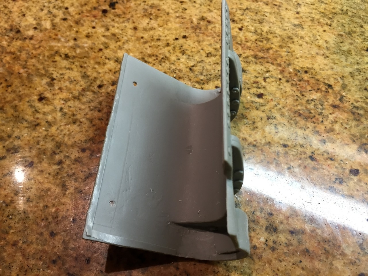

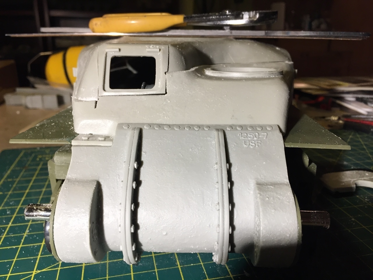

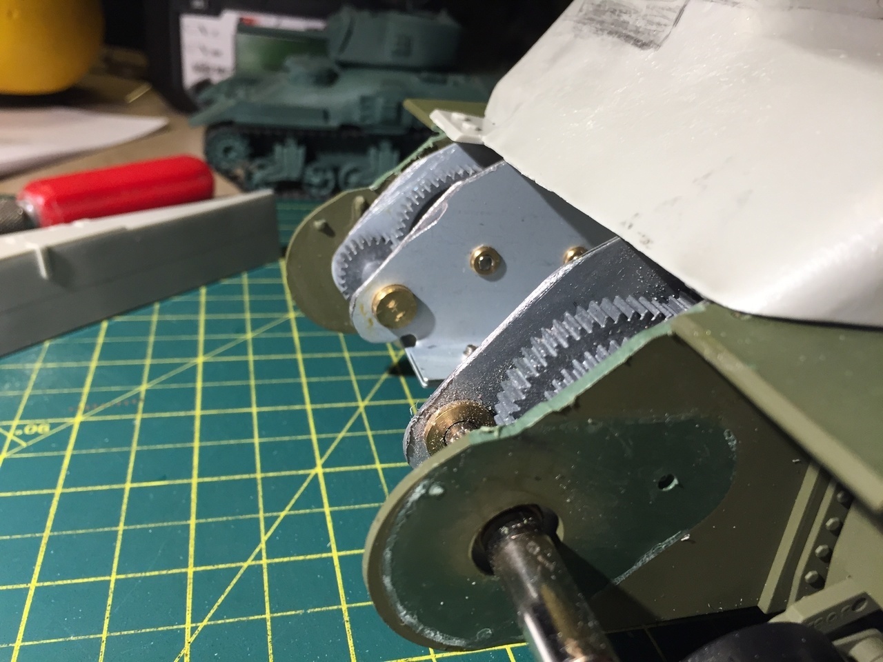

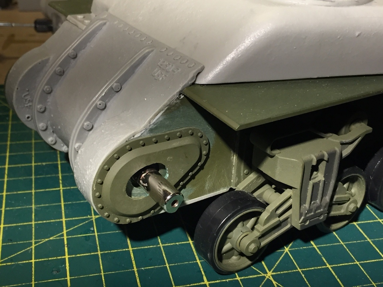

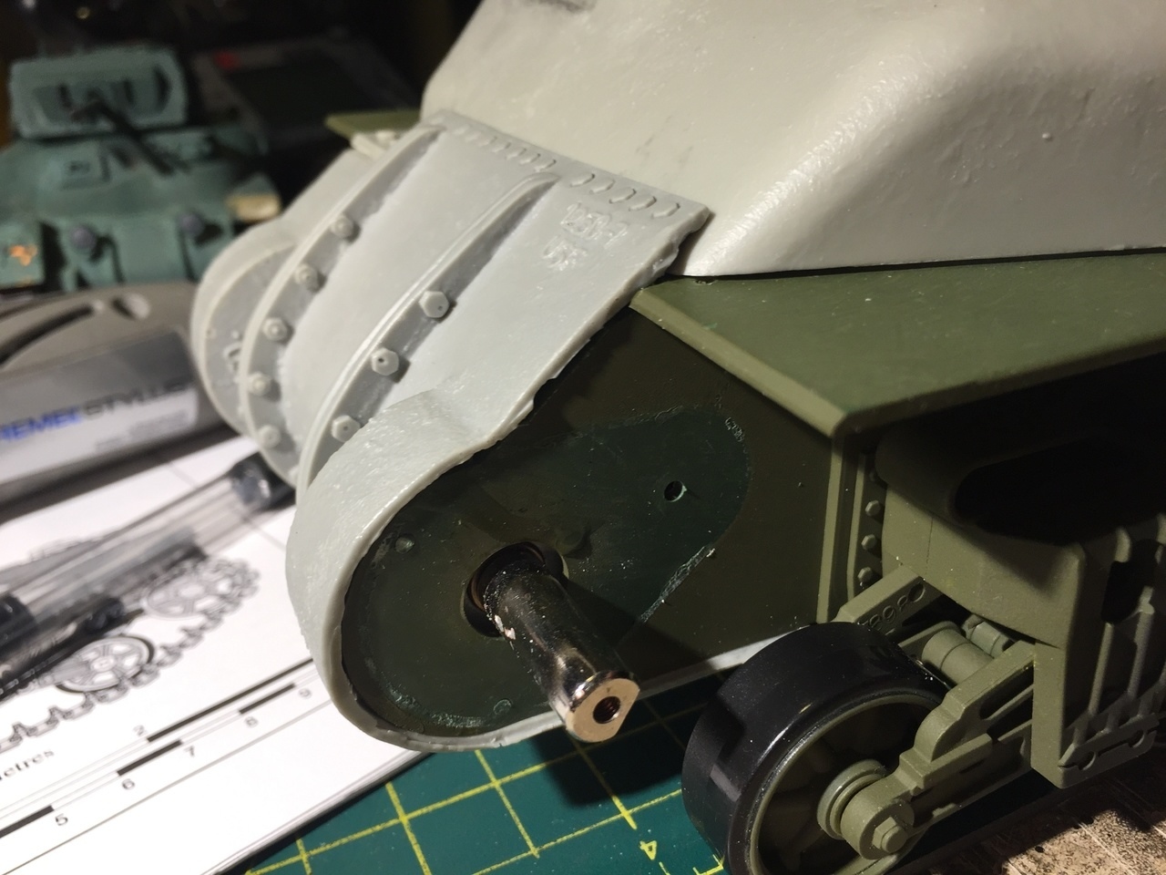

As usual for a Sherman hull mounted with a 3 piece transmission cover, the transmission side covers need to be removed, and the gearbox and the plastic front section has to be grinded in order for the resin part to fit correctly.
The idea here is to lower the front of the upper hull as much as possible. I made it flush with the lower deck. In order to know exactly how much and where to remove resin material on the upper hull to fix its shape, the first thing is to make sure the base is set.
If you install the front part as it is, the upper hull will be like 3mm in the air. So, I completely removed the molded in slot, giving the result that you see above..
That little plate of the left needs a lot of work to be properly placed, the transmission cover needed a lot of sanding. See reference pictures on previous post.
After sanding, the transmission side covers are put back but further up front than before, requiring the hole for the shaft to be extended rearward.

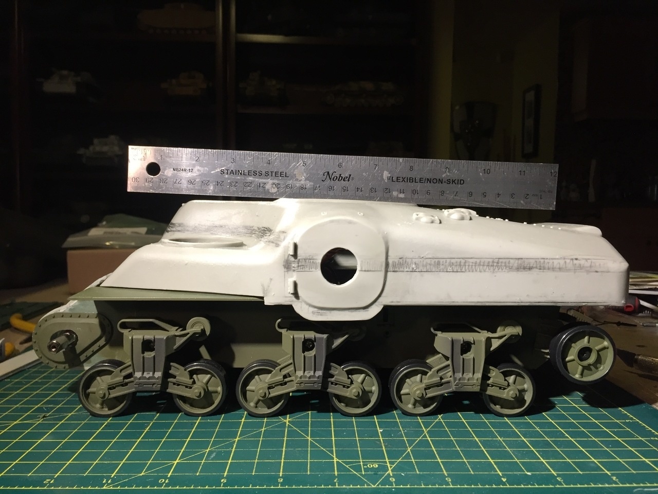

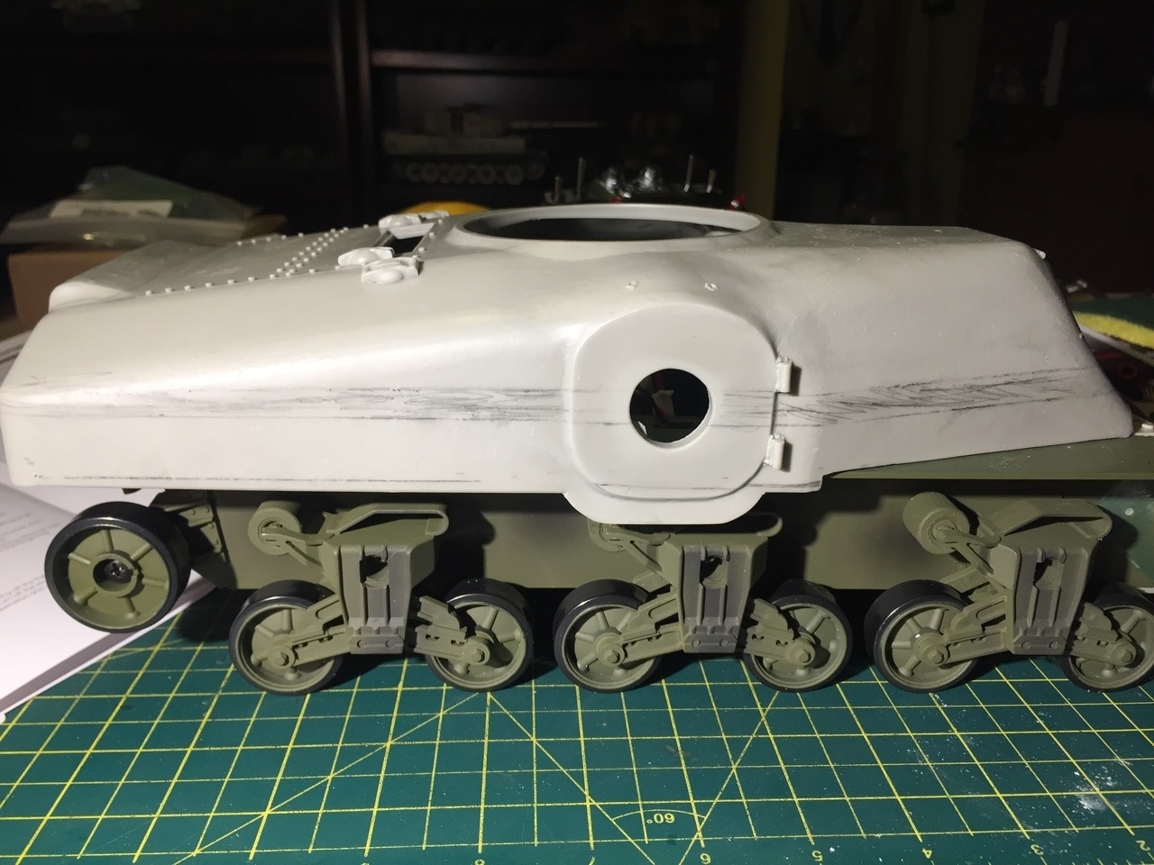

Before determining the placement of the upper hull on the chassis, it is important to notice how much space is available in the back for the air filters. I always found the Vandra air filters to be oversized. I found in my spare box old Mato plastic air filters from an M4A1 that are smaller and seem of a more appropriate scale. I will use these instead.

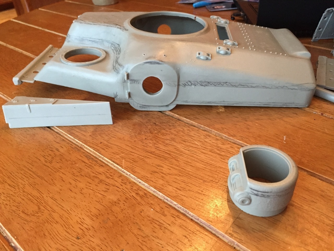

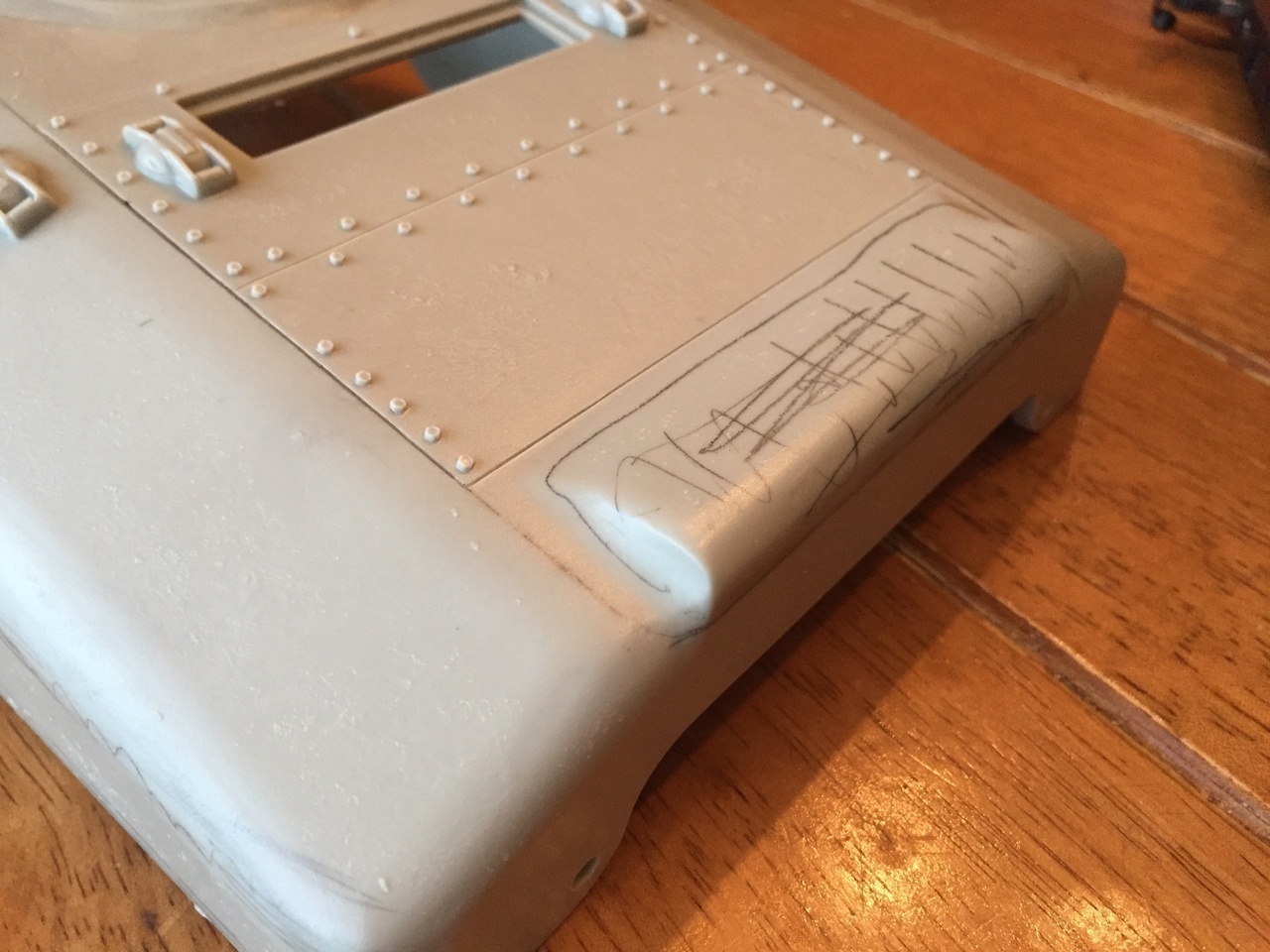

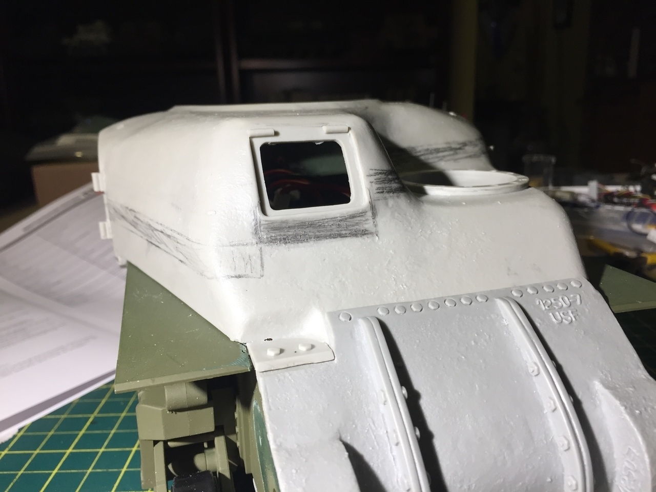

Here is time to take care of the hull. My god, I never imagined it would be that bad. As mentioned before, it is 1 centimeter too high, and on top of it, it is not flat. So, major surgery is required to fix this. I have decided to Go for Broke on this one in an attempt to make it right. I am Not building a tank that looks like an humpback whale.
What a sorry looking tank. The shaded areas is where I will make incisions with the Dremel and slowly reduce the height, including taking care of the angle of the turret ring.
I will remove 7.5mm from the middle, and another 2.5 at the bottom to make it flush with the chassis. The top of the front hull will also get some Dremel treatment.
The front hatch section need to go down as a whole.
Ok, It's Dremel time. The next time you see it, it will either look like a Ram tank, or it is going to be in the garbage.
Regards, Louis

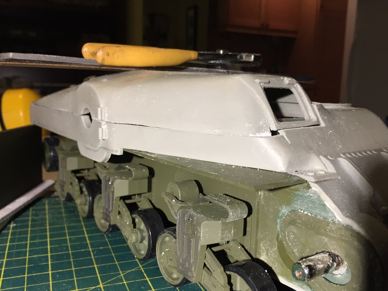

Hi, thank you Alwyn for your encouragements.

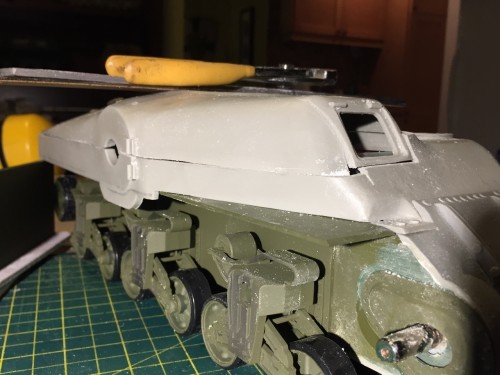

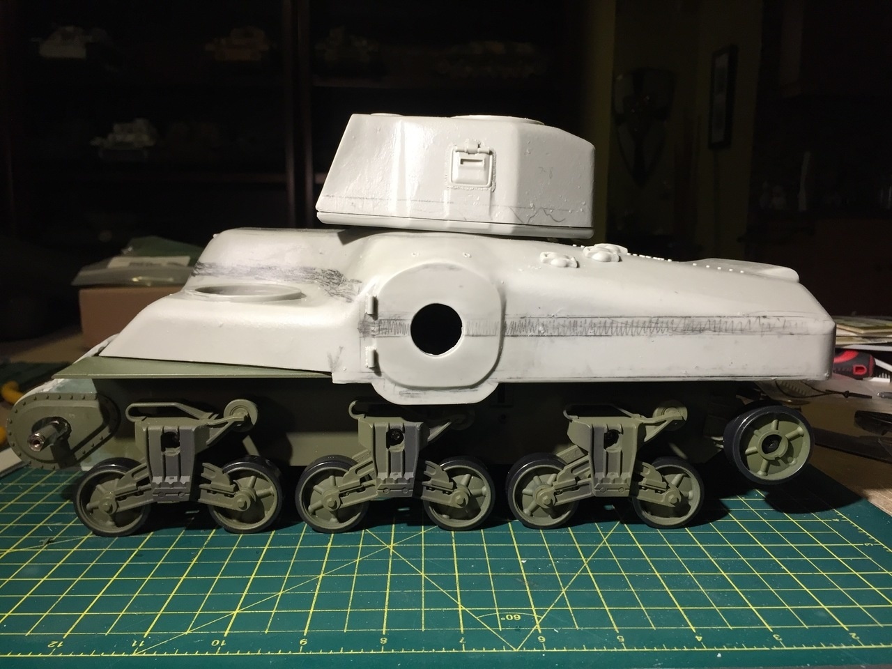

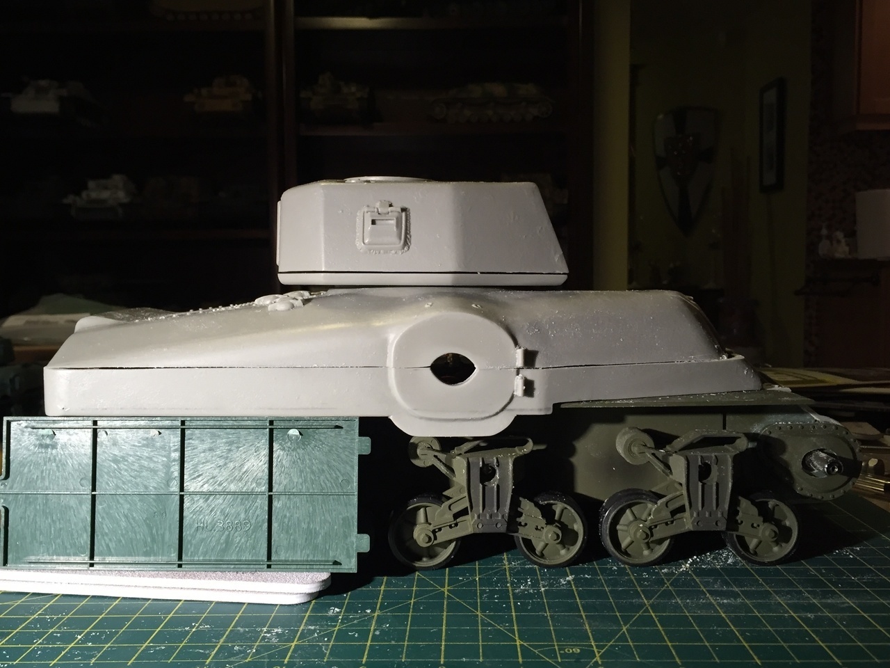

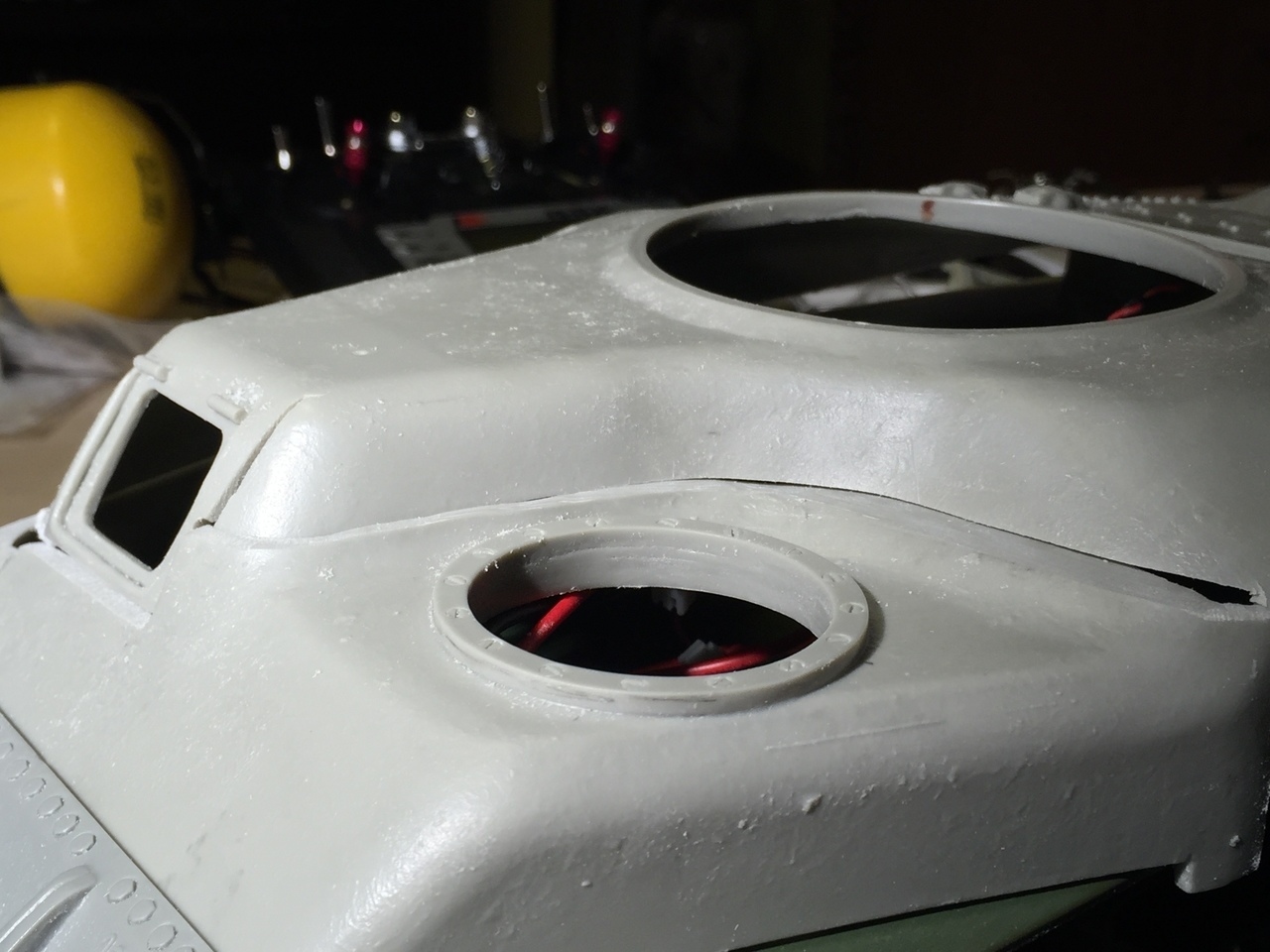

Here is a quick surgery update on the Ram.
Here the cutting process has started. To keep resin dust away, the heavy lifting was done outside in -24C (-10F) winter weather, which did not make it very pleasant.
I earlier decided to use the Sherman Gearbox instead of the lower Panzer III. I have determined it is just ok. I hope I will not regret it later.
Dry fitting of the various components.
Looks better already.
Man, it is starting to look like a Ram tank.
Next big tasks are; try to get another mm, lower top front section a bit with a light slope forward, fine tuning everything, gluing parts at the remaining joints, reinforcement and plugging of the gaps with plasticard, reshaping the joints, filling with putty, redoing the cast effect.
It is definitely not going into the garbage. I think it will be a good looking Ram.
Regards, Louis
