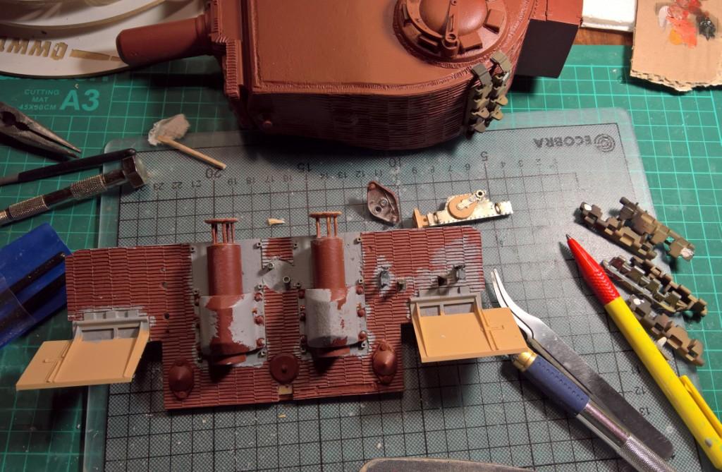

Added the Jack mounts and made the Jack almost complete. Testfitting and tarted on the spare Track Hangers for the turret. I will take the Regular Taigen pieces, but try to add the locking hook on top, also the lower mounting piece is now correctly mounted in the higher position on the back side of the link not on the lower front side. As on the regular Taigen tanks.

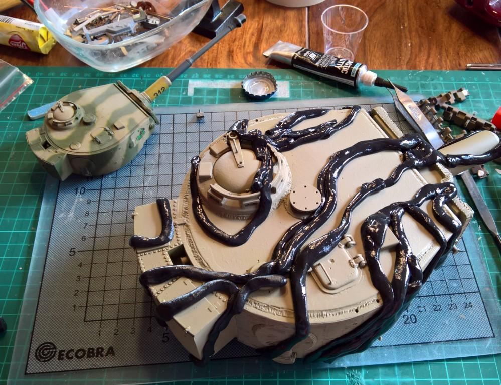

And here the infamous chocolate snakes from outer space strike again. Wonder what they have in their minds this time :think:

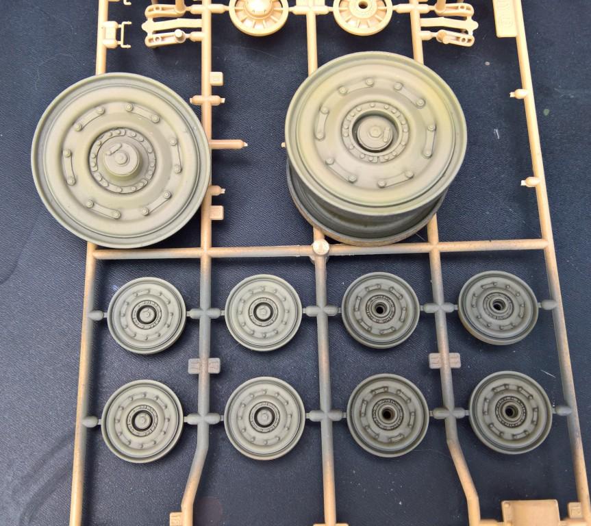

The wheels are now basepainted as well. Only the outsides got the final lighter treatment.
I tried a different step approach for painting the wheels this time. Always with thinned paints
1) Primed in dark gray, then Vallejo Hemp.
2) Filter/Wash of MIG Tan Filter with brown wash
3) Vallejo German Camo Beige with 20% of Revell sand, gives a yellowish tinge
4) Vallejo German Camo Beige
Next would be varnish and the real pin-wash/filter followed by maybe a mist of lighter colour again, but I will see that.

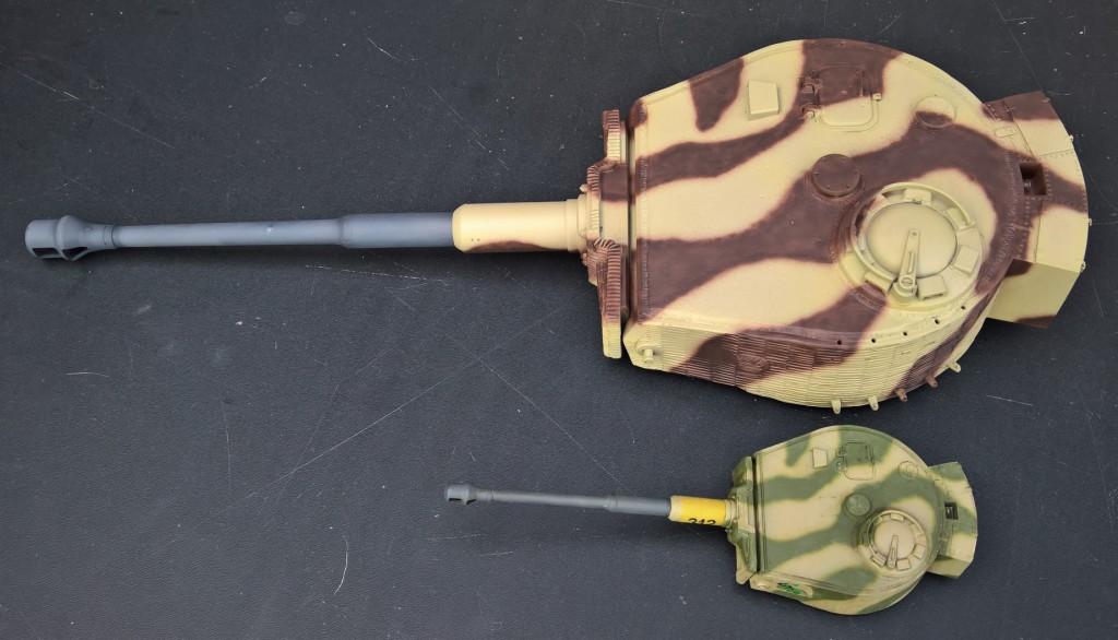

And this is what it looks like with brown stripes.
"Ludwig, tarn den Tiger!"
"Jawoll!"

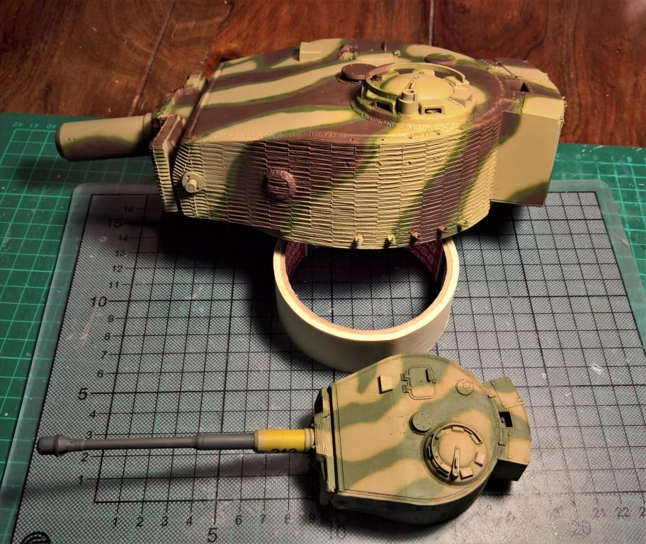

I still had to add the green.
