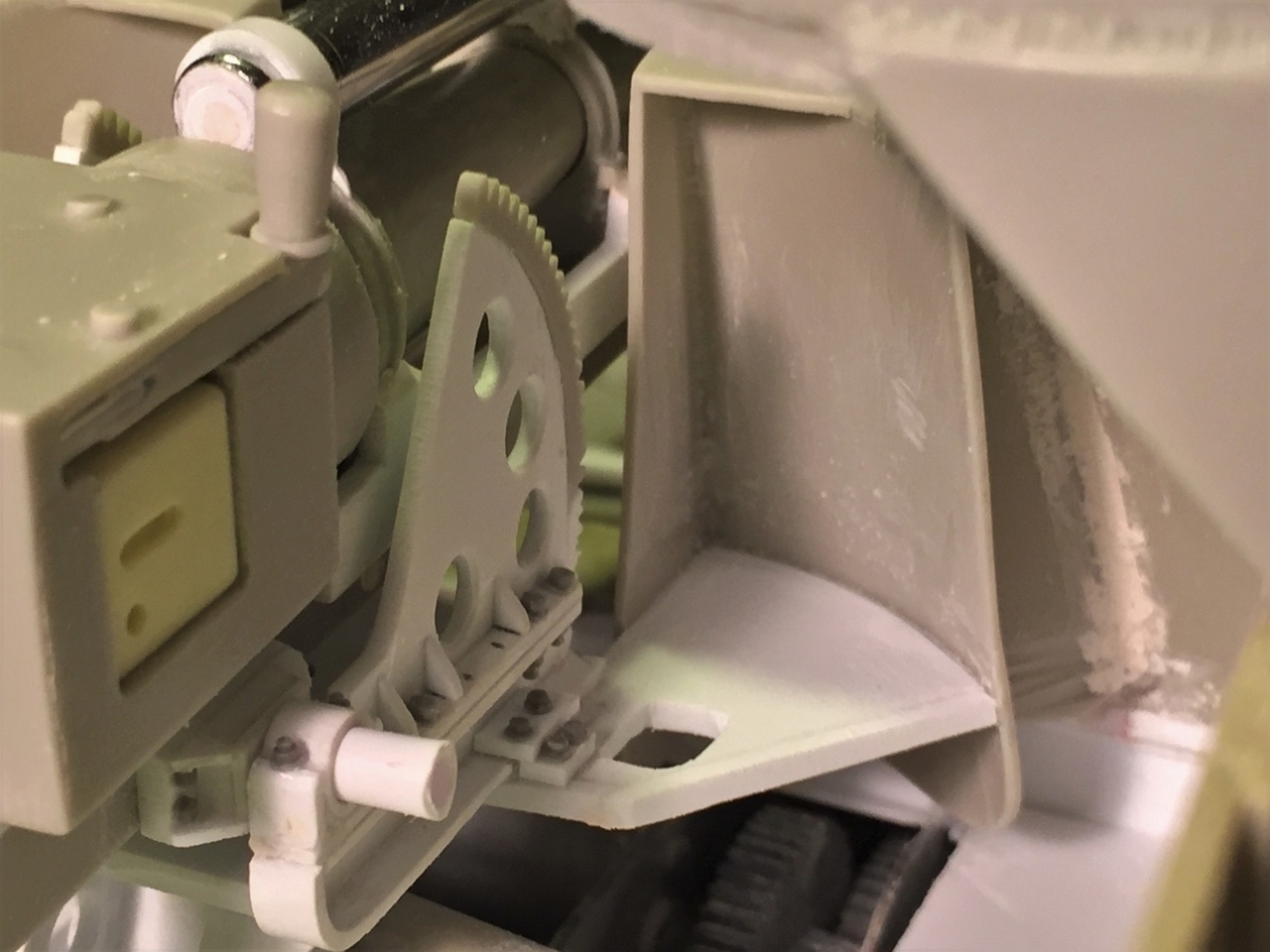

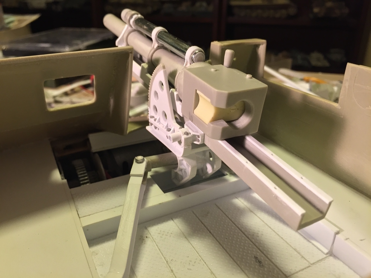

The upper and lower parts in test mode. The gear dents from the resin kit were reused as I could not make better ones, extended by mine where they won't show much. The final detailing with bolts and other items will come later in following posts. At this point, you just need to make sure the main parts dimensions are good.

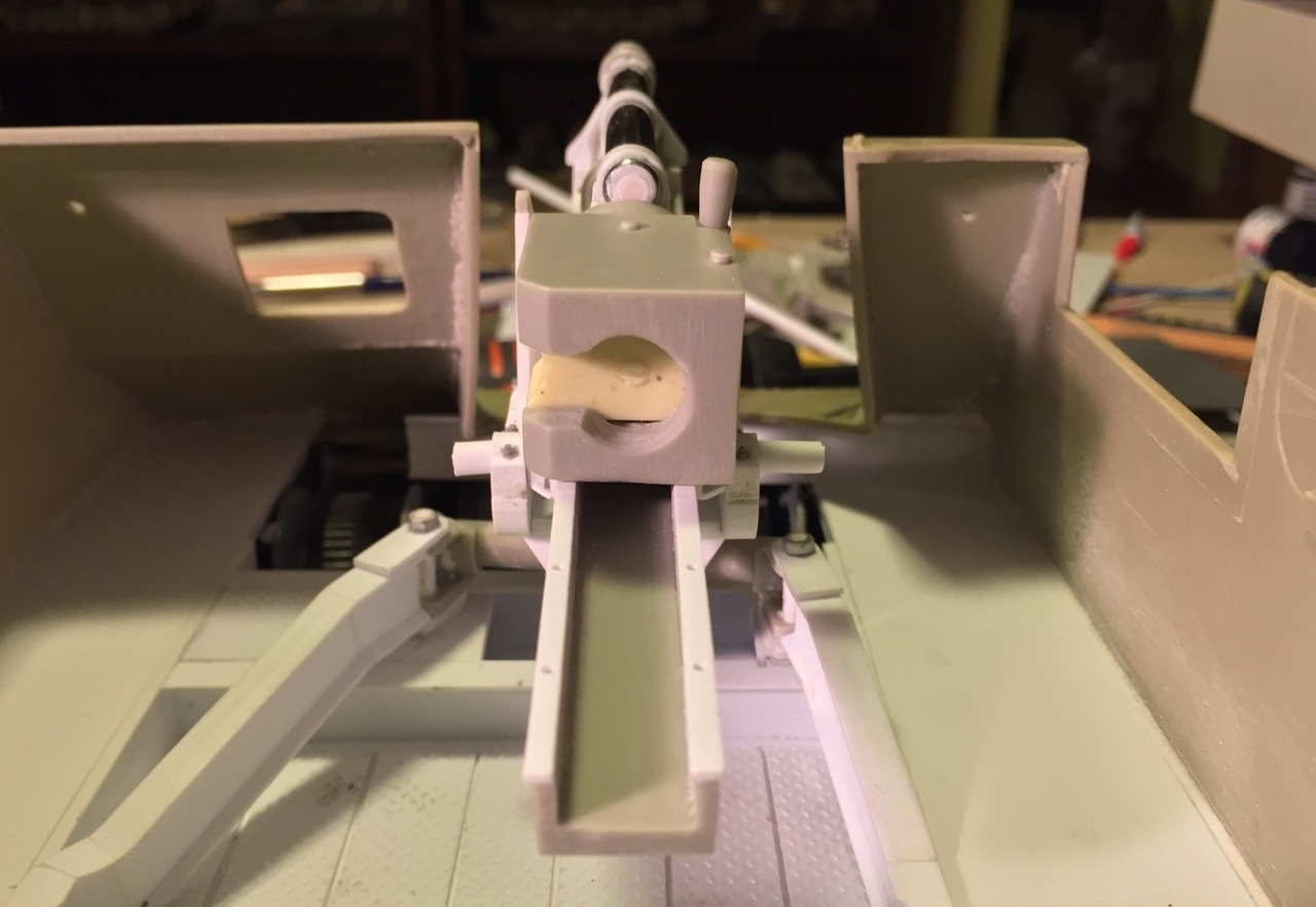

Interior views; The gun mount is assembled and mounted on the shaft/axle. It rotates as per specs for gun rotation. Because the M7 gun can turn in the right direction more than on the left, now I fully understand why the shaft was created at an angle.
The gun and intricate mount are the highlights of this SP howitzer so I wanted to do a good job capturing the shape of the real gun mount. The whole thing took me 10 hours to build. I had to constantly check dimensions and positions against references. View from the right side
View from the front on the rotation mechanism, quite simple. Temporary installation as it should have a brass tube. This won't show later once the gun is installed. The tube is going all the way down under the floor and a gun rotation system connected to it will be brainstormed later. The center of the tube will carry a pushrod for elevation. Maybe its too simple... well, that's the plan anyway.

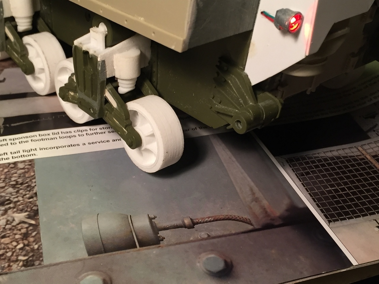

Here is the M7 Priest trialling its new M3 Lee modified Shapeways suspension. These and the spoked road wheels are really nice. Too bad spoked idlers are not available.

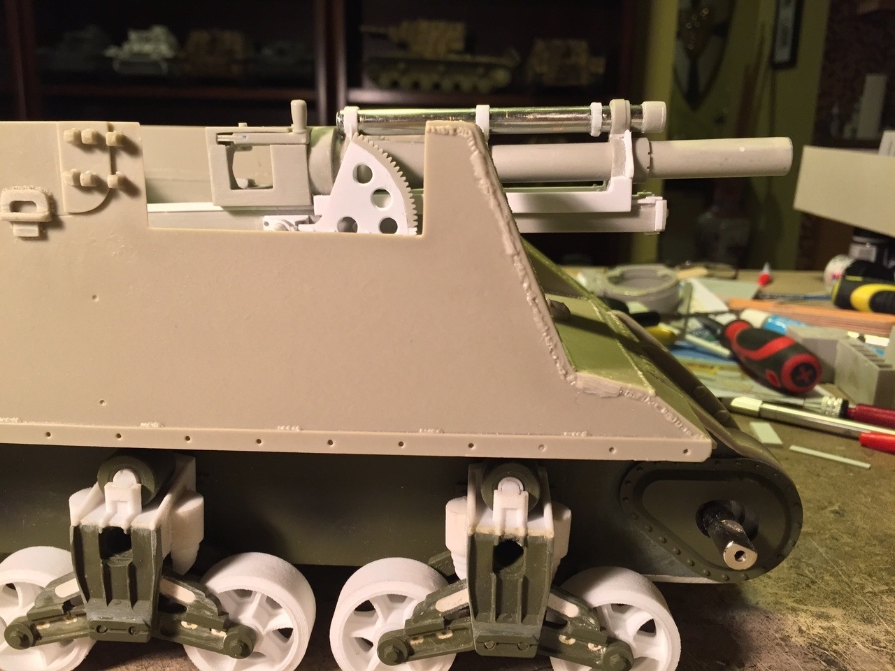

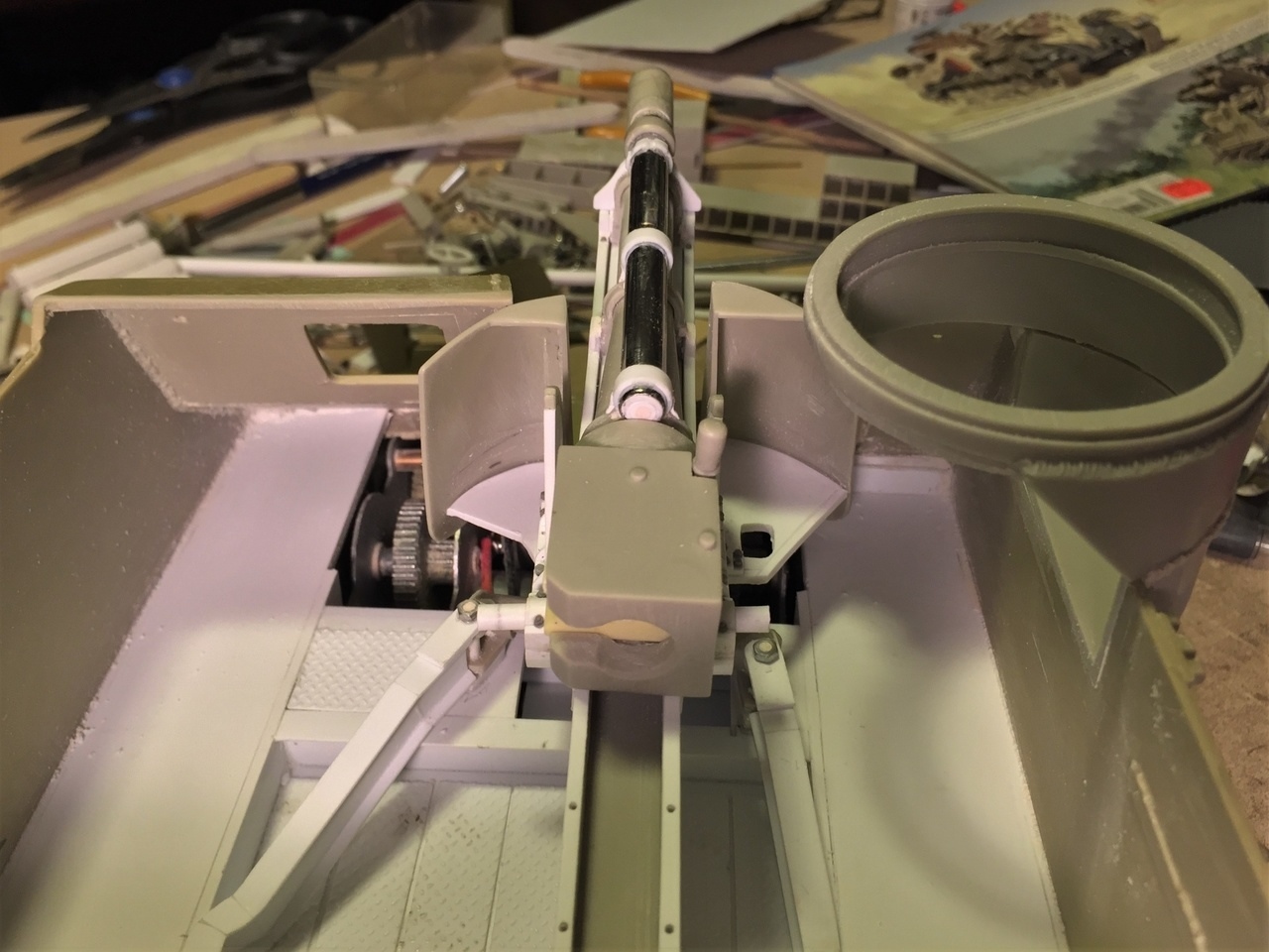

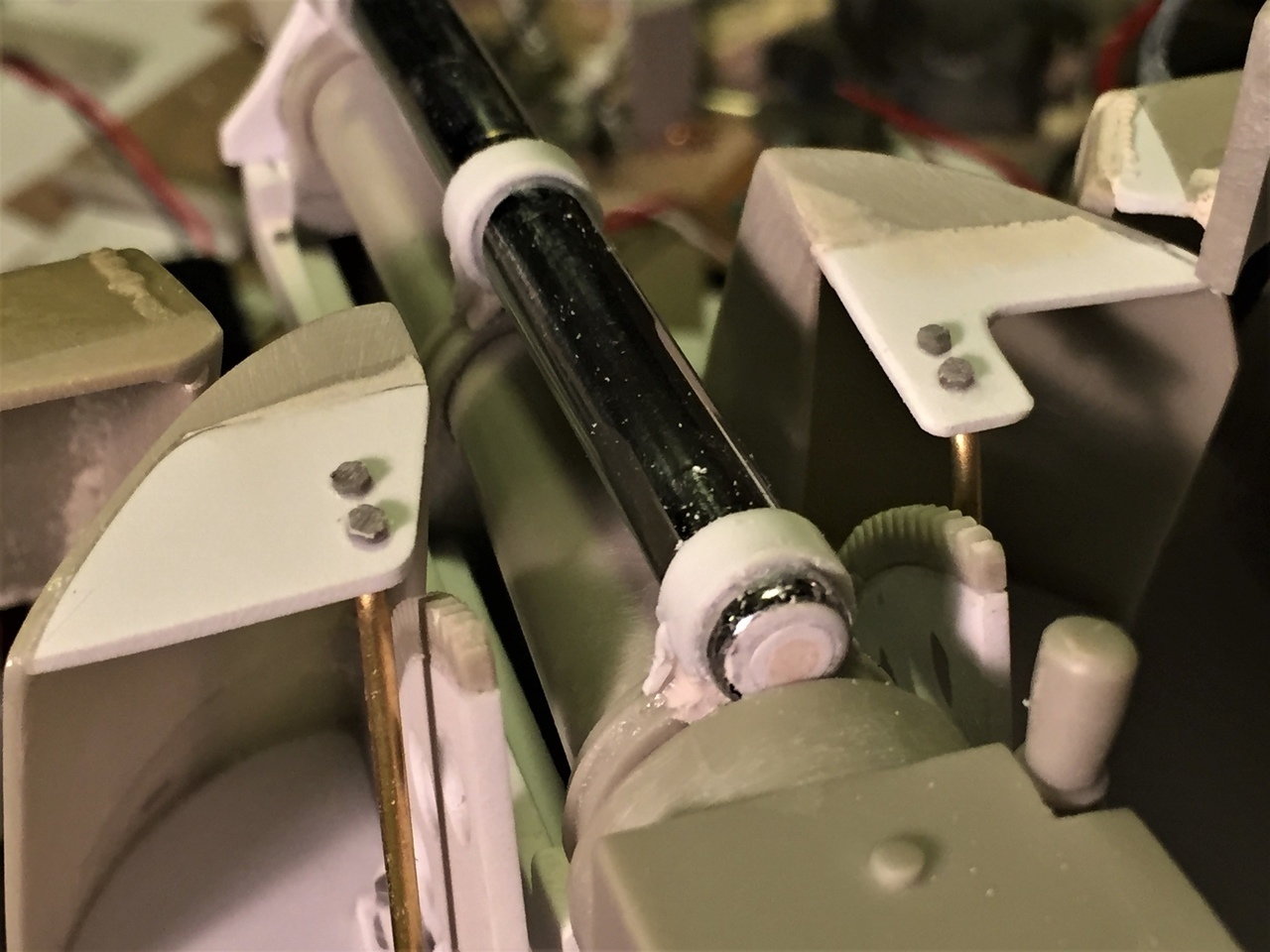

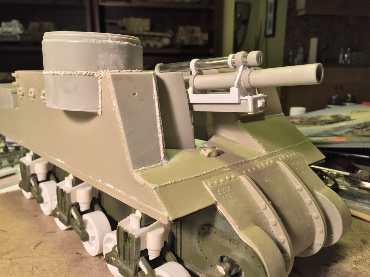

Here the gun is installed and held in place with temporary braces. At this point, its is better to kept the gun/cradle removable from the gun mount until the gun shields are installed at least.
The Meng nuts and bolts (small and large) are fantastic to work with. Although advertised as 1/35 scale, the large ones actually fit 1/16 scale armor perfectly and even the small ones are useful. Highly recommended. Here some nuts are installed but are not cleaned up yet, they show some residue. I found it better to clean them once glued in place, using a sharp knife and magnifier otherwise they will bounce around and you will loose half of them.

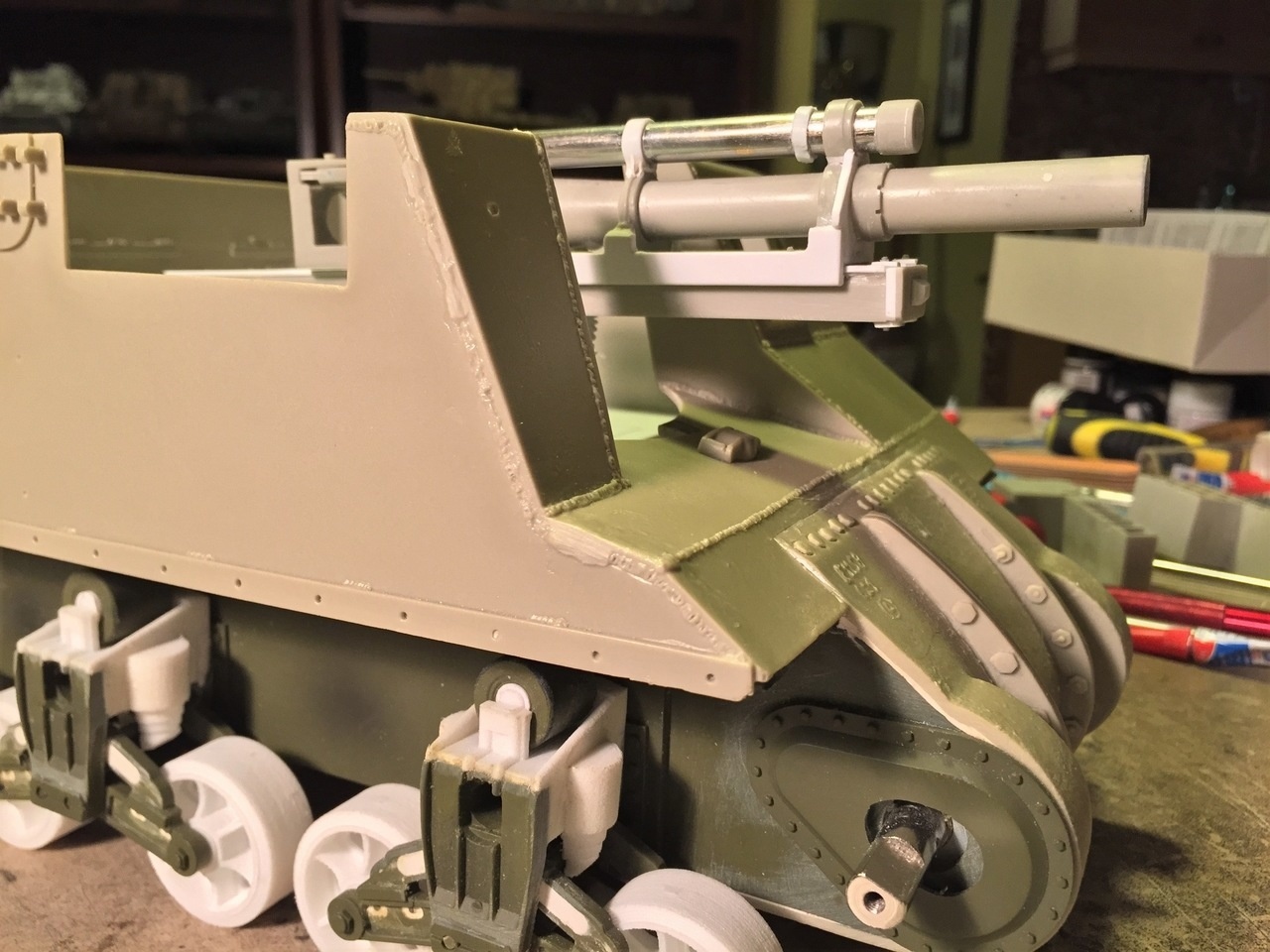

Exterior views, the height of the gun is good. That is a relief.

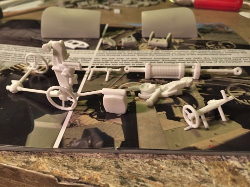

The shapeways M7 gun parts are being prepared. They will require some polishing. It does not seem it will be too complicated to make them fit the Vandra gun. They can also be further detailed once installed. For the elevation spring that goes under the gun, I am thinking of creating a brass spring but it could be complicated. The shapeways plastic is hard to work with. I'll see.

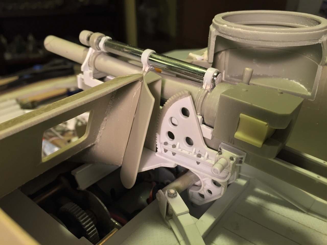

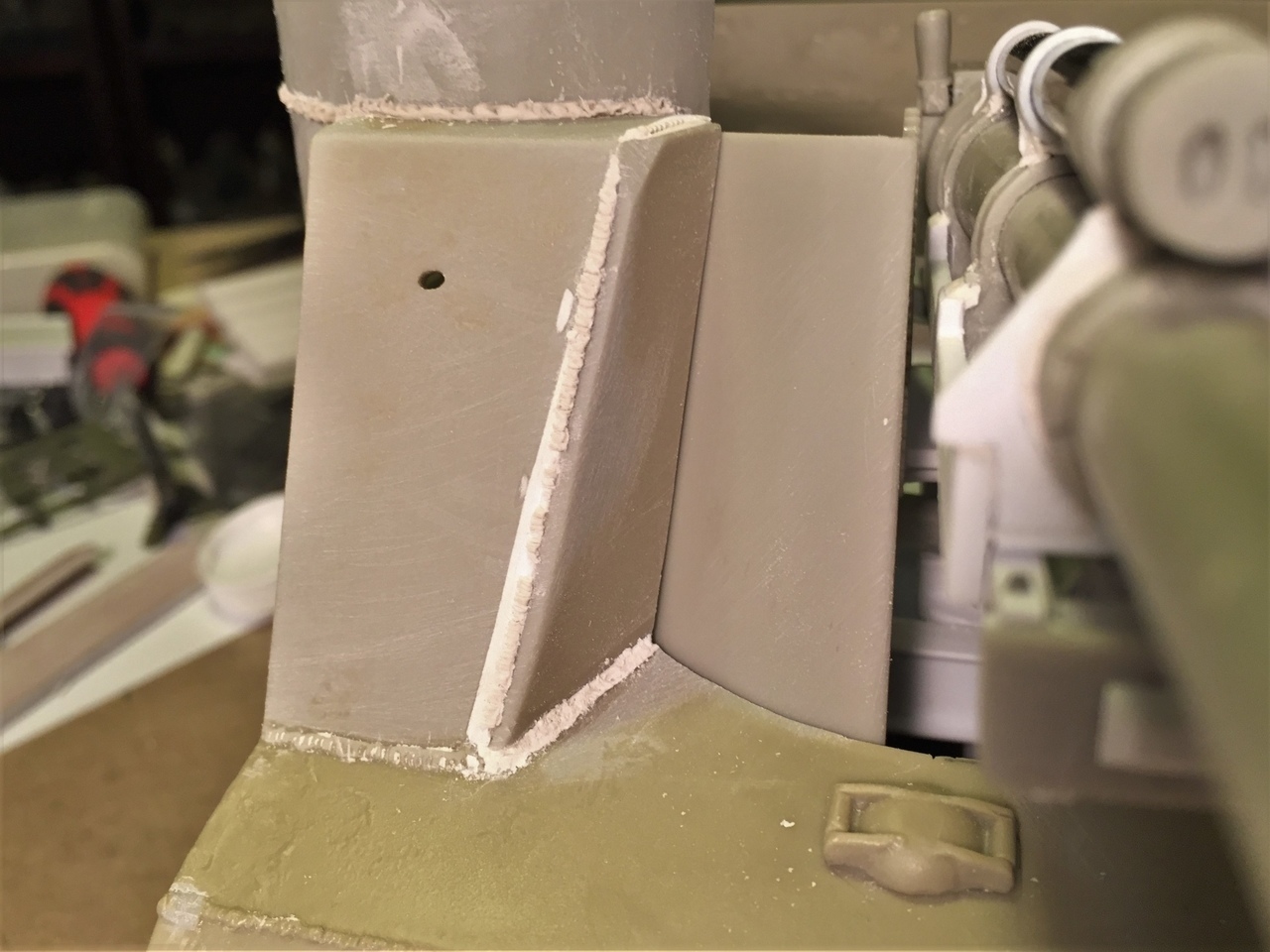

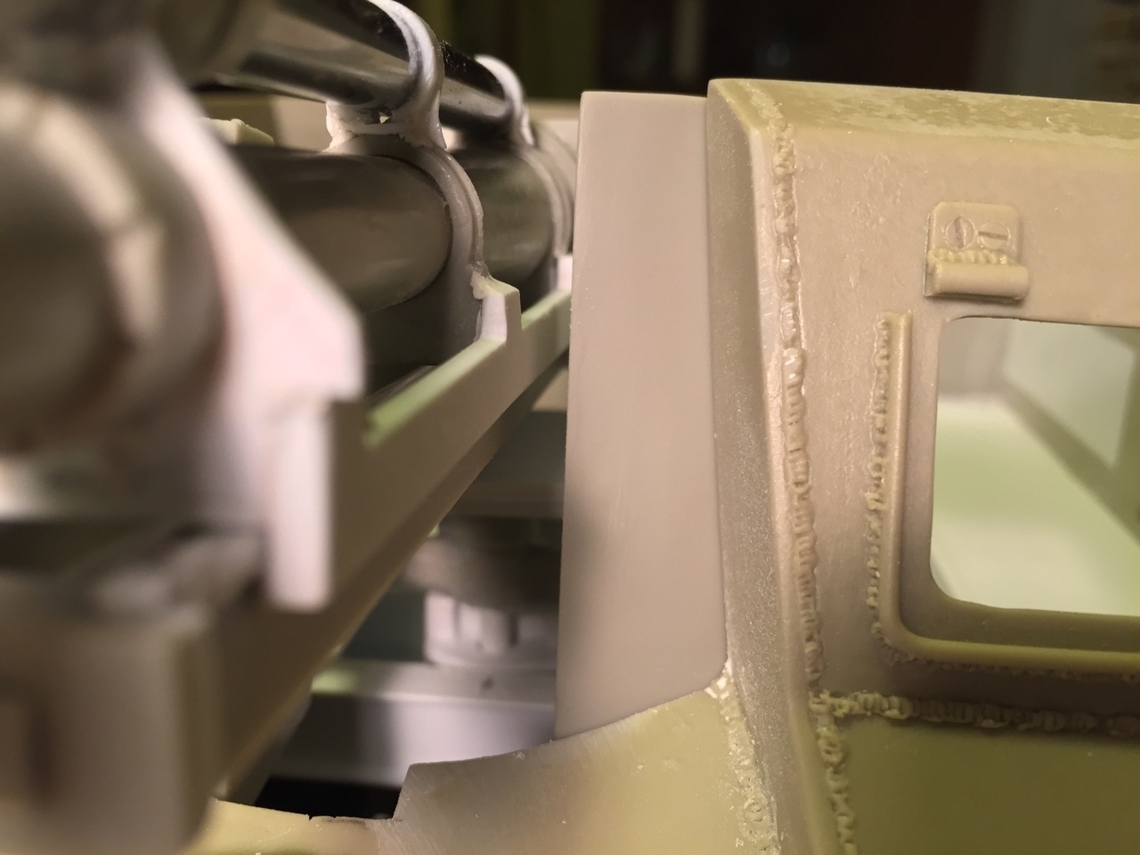

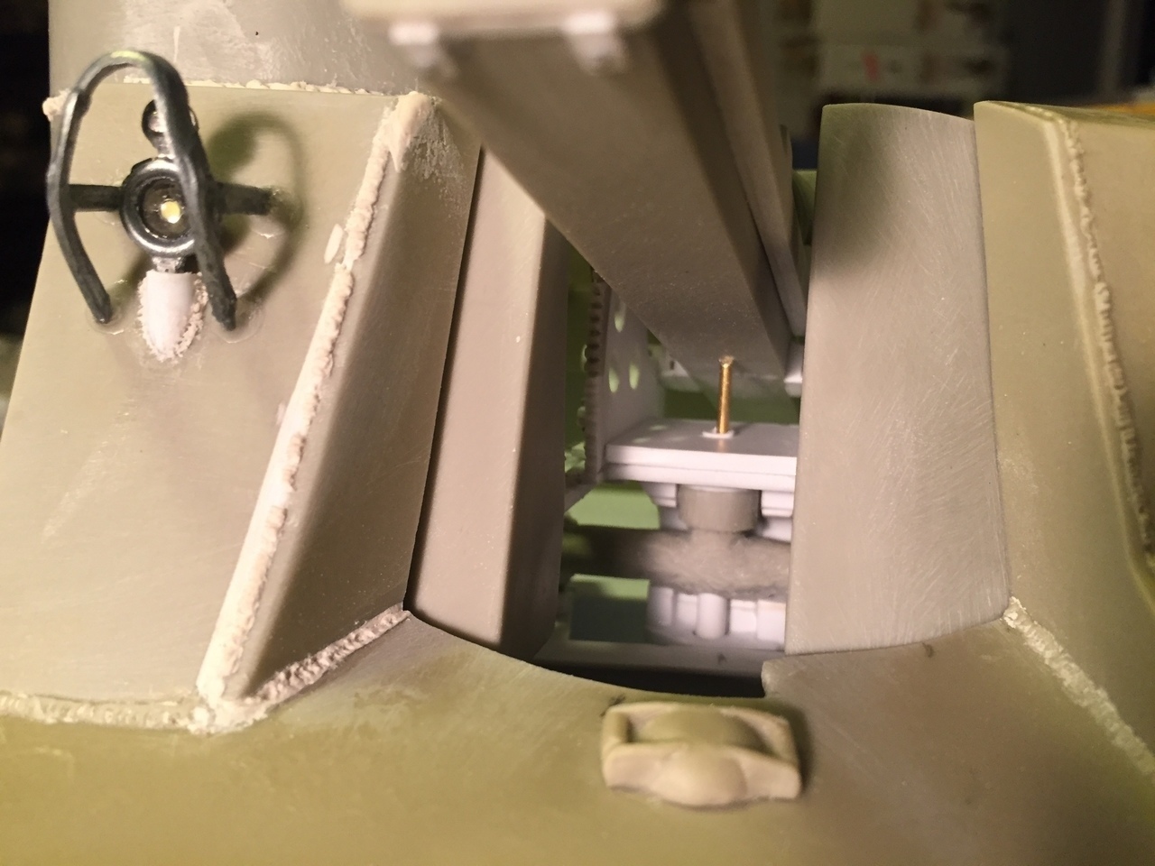

It took me 3 hours of trials and errors but the gun shields are finally in place. I have achieve the best results possible considering all the variables.
Be aware that the upper pulpit kit part is 3mm too high and was reduced in height at its bottom.
Much patience is required to get to this result. Keep in mind the gun has to rotate as well. You will also notice that the hull armor plate on the left has been repositioned at the angle indicated in a earlier post so that it matches with the corrected gun position.
The other side
Views of the interior. The mounting for both shields had to be redone because the ones moulded on the parts were too high, too small and did not fit my new gun mount. There is a lot left detailing to do. The gun as provided with the kit is pretty naked.
Now that all the main parts are all in place, the fun really start where I can detail the rest of the model without so many big concerns.
Regards, Louis

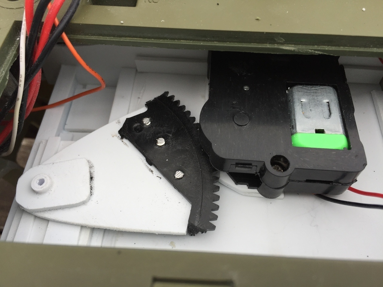

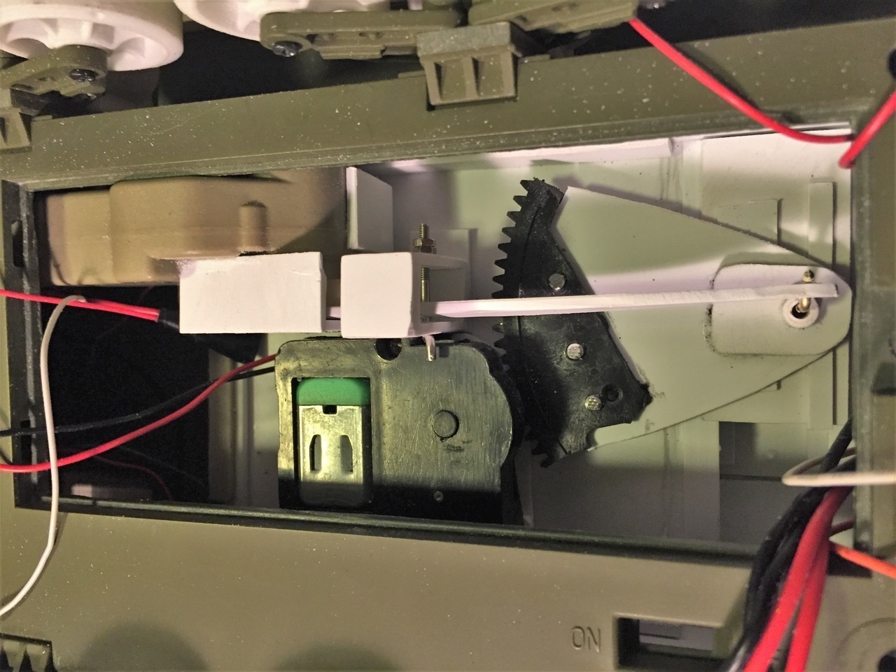

Here is the gun rotation system. A bit similar to my Nashorn build, it is the Heng Long rotation unit coming with the Sherman that turns a portion of the Sherman turret round gear. It is mounted on a plasticard piece linked to the shaft fixed to the gun mount above. I will put some blocks on both ends so that I do not rip the gun mount by travelling to far right or left. With such (no cost) primitive system, it is only to play around with the howitzer. No one is going to dog fight a Panther with an M7...

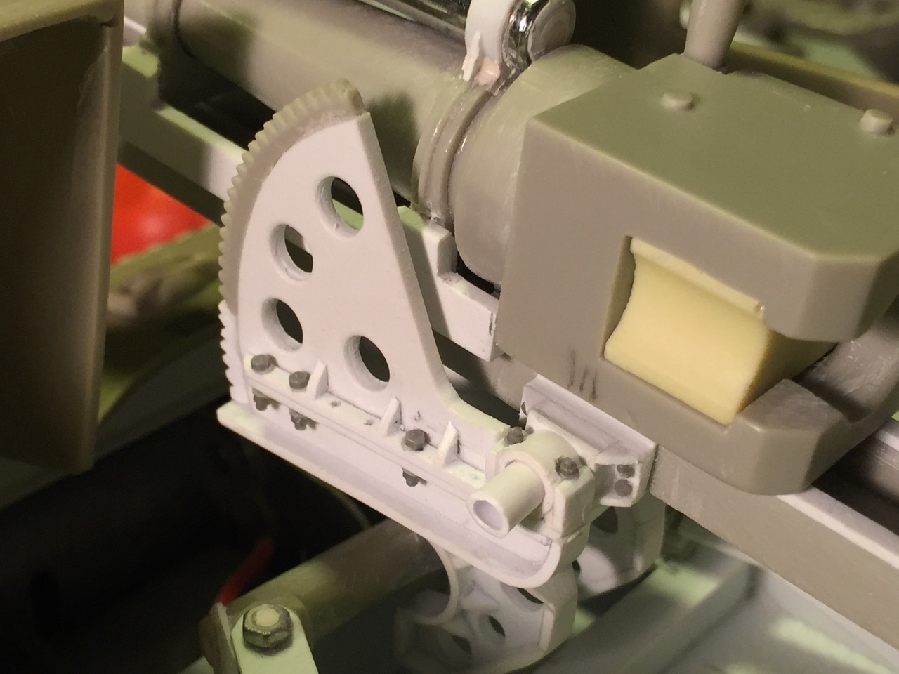

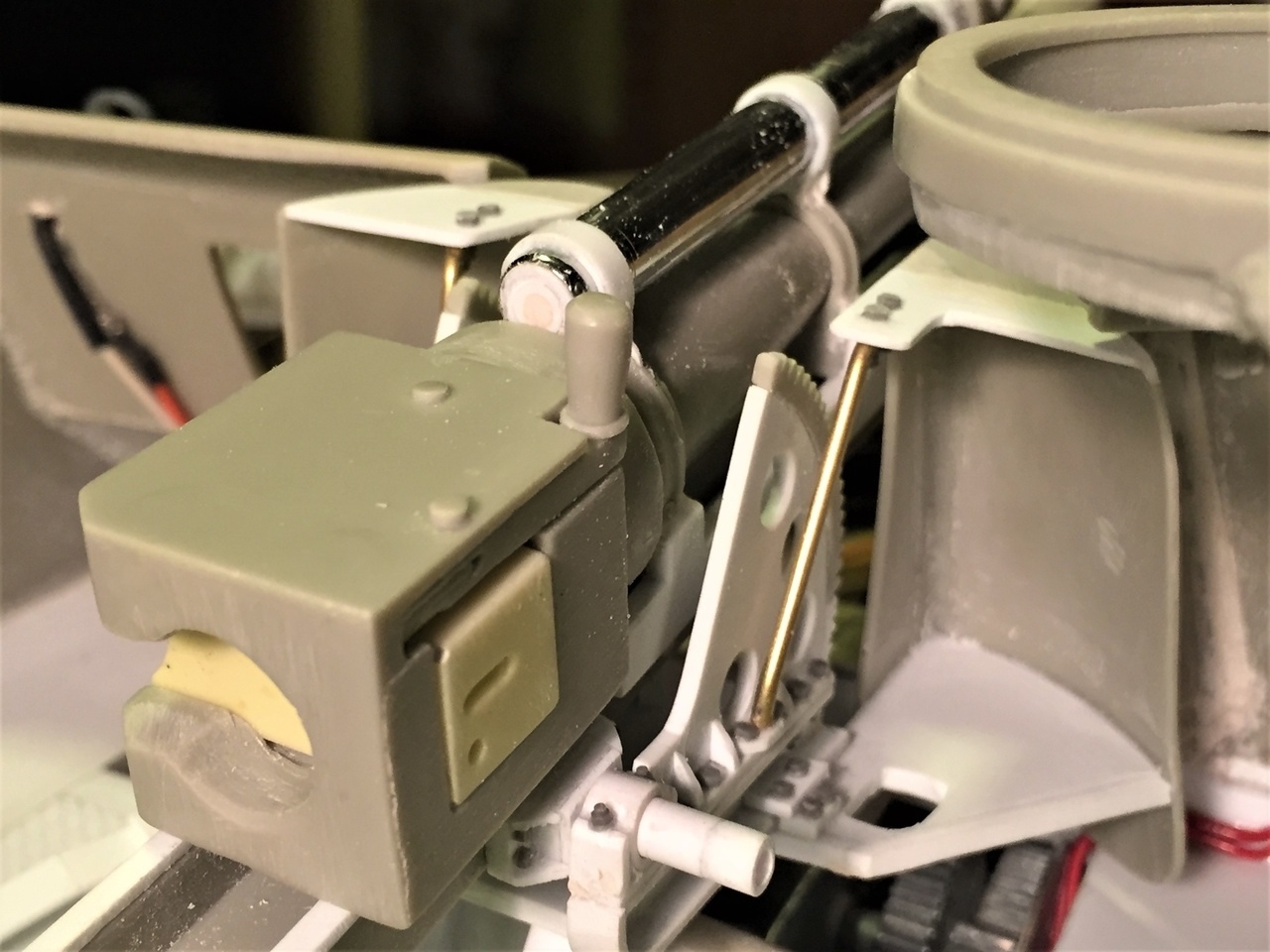

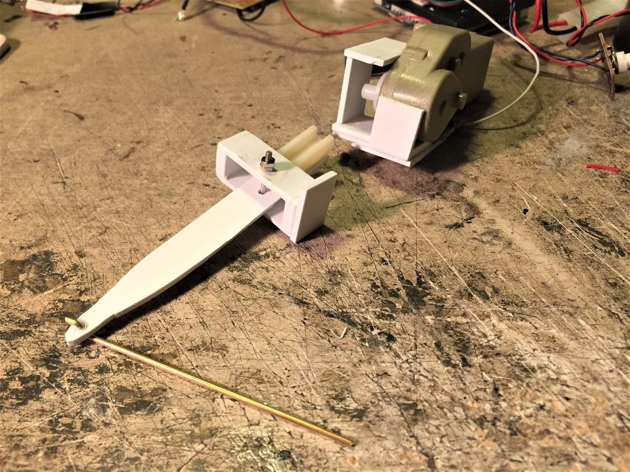

Here a gun elevation system has been built mainly with plasticard and a brass rod, and needs to be integrated with the Heng Long Sherman elevation unit. You must be wondering what is this but see the picture further below
Temporarily in place next to the gun rotation without a single mm to spare, the Heng Long unit is tied to the arm ahead of it. Turning the elevation gear makes the push rod go up and down through the rotation shaft. I have not done extensive trials yet because the gun and the electronics are not yet ready to be fixed in place.
The M2 105mm gun is muzzle heavy but light, and the natural position is down. The push rod from below pushes on the cradle to make the gun go up and down. This view will be hidden by a central gun shield section that has not be built yet. Notice the Mato lights and metal frame.

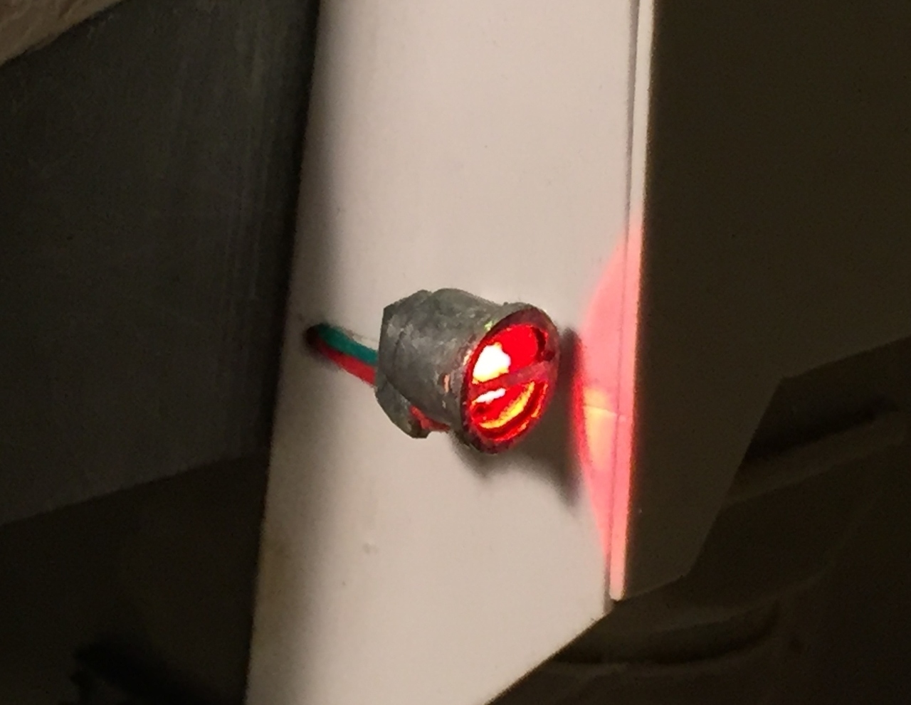

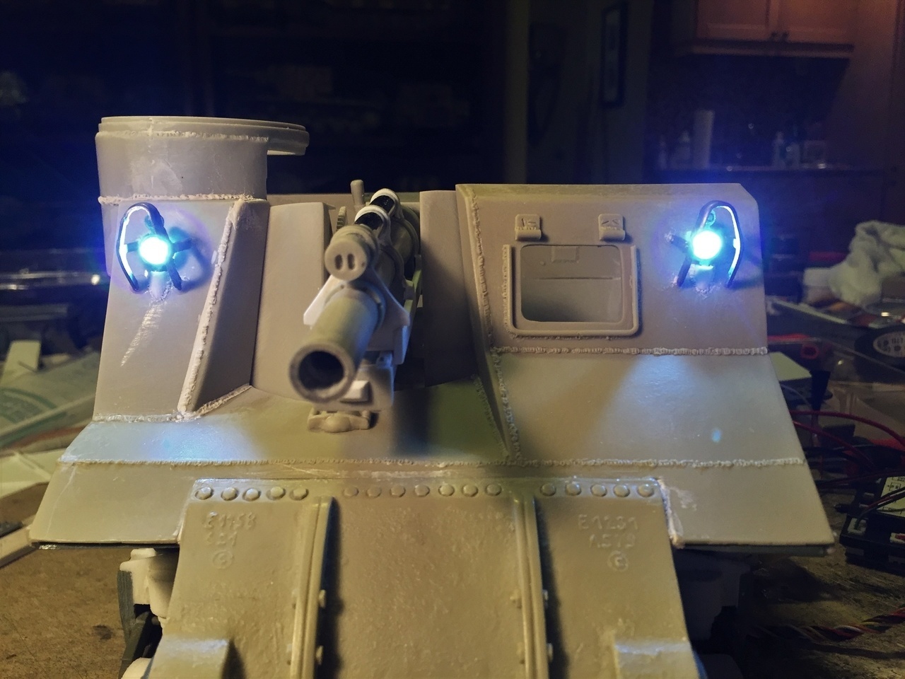

I initially wanted to reuse the Heng Long lighting units but once cut and taken out of the Sherman upper hull, they became very fragile and the wires were not long enough with the new setup. So, I ordered brand new Mato metal Sherman lights from Forgebear. It is a rare luxury with this build. They were easy to install but the metal is difficult to alter, the metal will break instead of bending. You have to be careful not to ruin them when doing alterations to make them fit the M7 hull.
Same treatment at the rear with Mato rear lamps. Again, the Mato metal is difficult to work with, there is not much that can be done to remove excess material without damaging the wire and lights.
I would have normally put the wiring strait inside the hull sides but references show the wires going externally forward before entering the hull. If I had to redo it, I would have put the Mato wires strait inside and put a single fake wire going to the front to simulate it. Too late now, I won't redo it.
