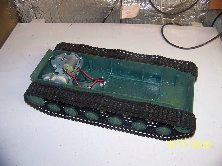

gutted the hull then cleaned the upper hull and moved the turret ring forward

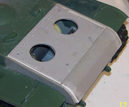

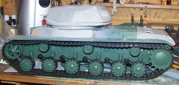

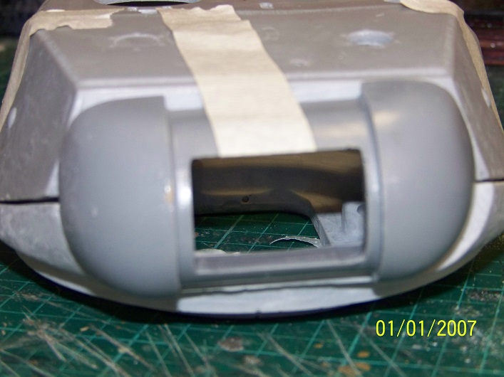

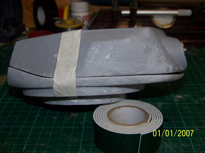

the engine deck, first issue sides do not fit , so the top and bottom wont close, so fettled them in. then found the engine deck and rear plate are too narrow, so had to add fillets to both to get to fit :-< :-< 2 evenings later I think I've got it.Also started to on the turret fit heres a first look as it will look

My deepest condolences Dragon.....That IS a rather awful turret ....kind of makes me think it came from the Mr Potato Head factory 8O
With that said....It'll be fun to see how this one turns out...if worse comes to worse...you can always add it to your Flinstones Tank Collection ;)
