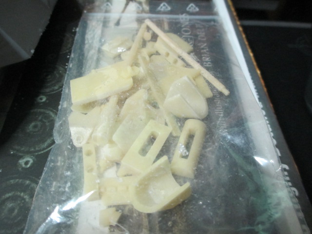

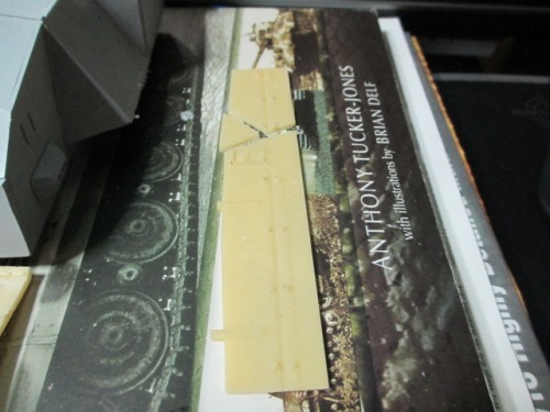

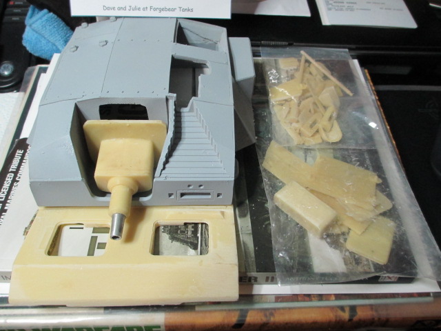

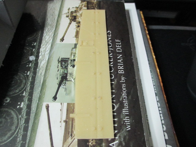

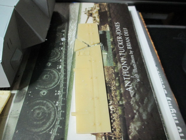

So after mooning around waiting for parts to repair my Pershing 'B-12' , the first major part of this anticipated build arrived today. Sent along by Forgebear from Asiatam, the Profiline resin kit for the StuG III B is everything I expected and more. Even after all of the shipping, only one resin part was broken and a few seconds spent had it back in one piece. Now, I need to decide whether to go the ( expensive ) metal route with a Taigen lower hull and suspension or pick up a HL StuG and dress it up a little with the better tracks, suspension and running gear. At any rate, the next thing that I am looking for is a Tauchpanzer upper deck. Pictures:
- Almost everything to turn a StuG F into a StuG B, detail - wise
- Almost everything to turn a StuG F into a StuG B, detail - wise.JPG (91.67 KiB) Viewed 15244 times
- Resin components and a metal barrel
- Resin components and a metal barrel.JPG (96.18 KiB) Viewed 15244 times

Looks like Asiatam did a bunch of work there Painless...all your hatches are independent except for the loaders ...but that's cool ...they even made recessed liners for the transmission covers...and also freed up the barrel and replaced it with a metal one....Very Nice...good score
Let the metal parts shopping list begin!!!!!!!!!!!!
PS...I'd mate that with the Mato Lower...you get more bang for the buck with the Mato

I was worried about using resin after that imbroglio you got into over your last effort to make use of a kit. I am pleased tho' now that I have seen how cool this one looks. Without a lot of scratch building, this is about the only way to get a large scale RC early StuG B put together. It's fair to say that I am more excited about this than I am my Tiger kit. I've got a couple of sacks of Mato metal accessories for the StuG and Pz III already. I will want to make the aerial trough out of wood and use brass for the exhaust grills. I will want another working Convoy light in front and will use one in the rear instead of tail lights. Exciting stuff!

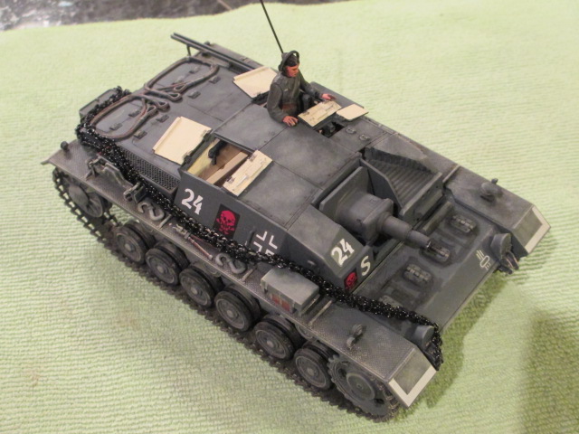

Thanks for the heads up on the hull hatches. I'm going to pretty much copy the 1/35 Tamiya version I built last year. It is a beautiful little assault gun and should look Aces when up scaled into a running version. Taigen and Asiatam should be very close. I am looking into all of the options this morning. ;o)

Yeah that was a bum trip for sure...and its still tricky because of the nature of the resin... looks like yours is the good stuff ...hard to say just by looking at the color...feeling it is the best way as the weight is a dead give away ...with that said...I like all the improvements on yours... though not really necessary for the way I build ...for someone who enjoys the detailing like you do it will suit you great ...the metal barrel will make it easier for you to make it recoil...I have to drill mine out ...PainlessWolf wrote:Alpha,
Just wondering why wood for the trough ?......I did use plastic first time around...and they are pretty strong...super easy to work with as well...but I'll probably be using brass or sheet steel for mine...it's just stronger you know
Anyway good luck on your search for parts ...for some reason I think you will have more fun with this than the Tiger...so you should wait till after the Tiger
