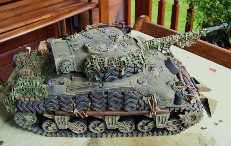

Nice FF.
Cutting the hull was a bit of a chop and pray moment but it seems to have worked.
