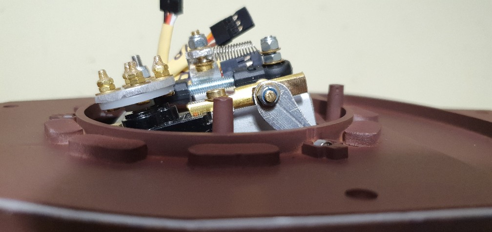

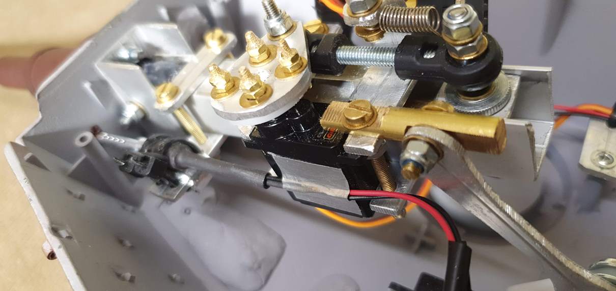

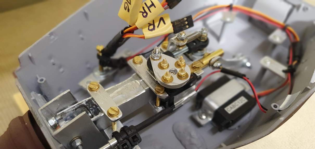

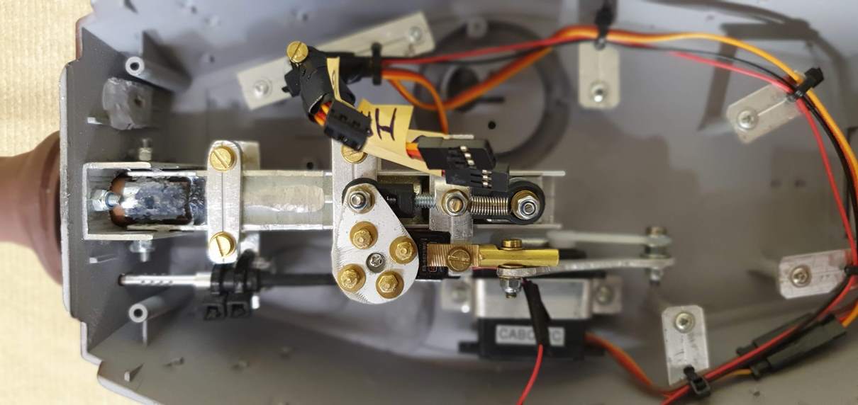

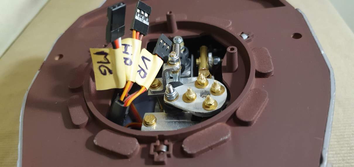

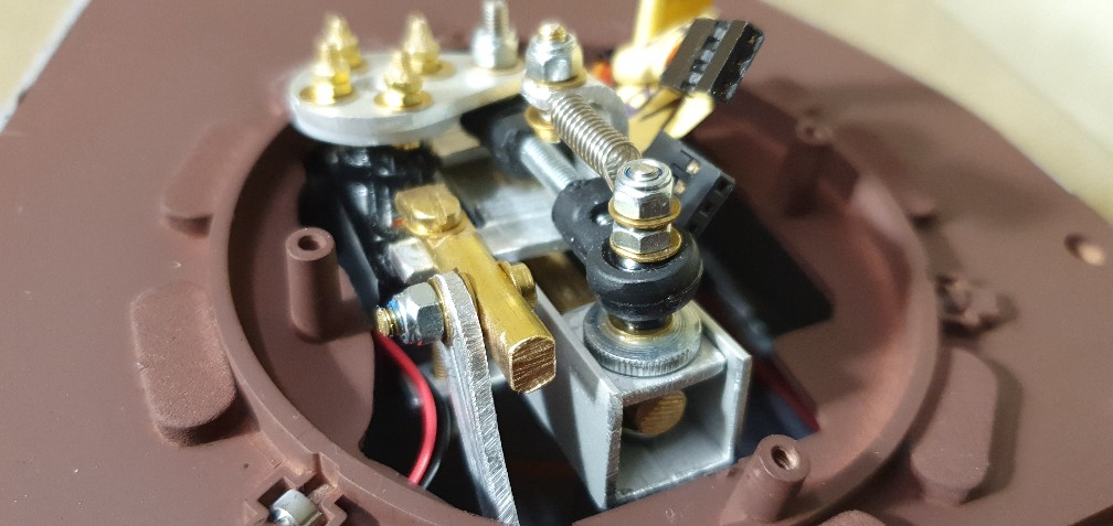

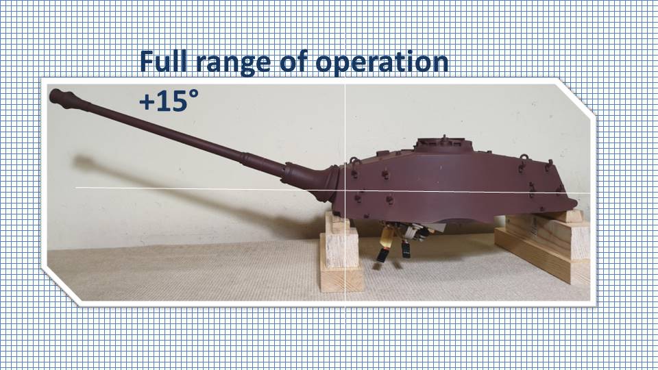

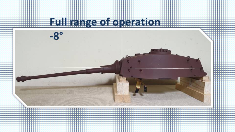

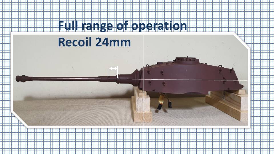

I was not satisfied with the Torro (Taigen / IMEX) Full Metal 1:16 King Tiger Turret and Gun wobble. Resulting mainly from the wrong gun attachment pivot points, which is about 25mm out from the correct scale position.
Therefore I spend some time to fix this issue with a full metal Gun elevation and recoil upgrade.
Part 1 of 3 (original build)

Thank you for the motivating replies and comments

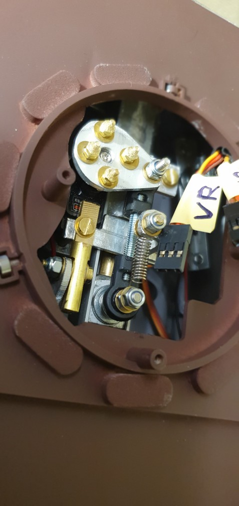

The main challenge and problems I encountered, was to develope an assembly which is small enough to fit through the turret bottom cover plate, but at the same time optain the gun's full range of operation up and down, with an at scale recoil possible at any angle position of the gun.

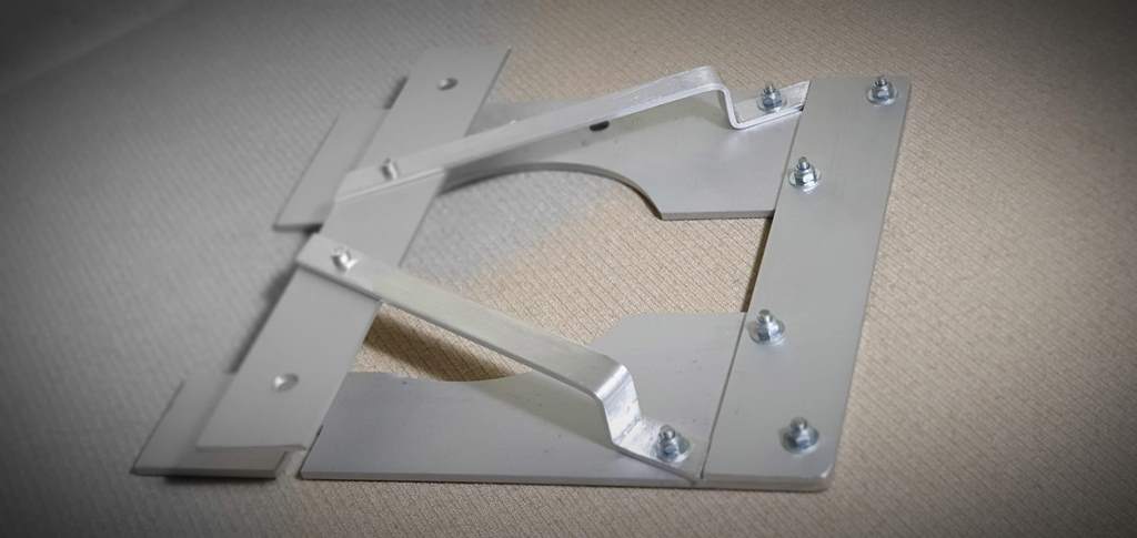

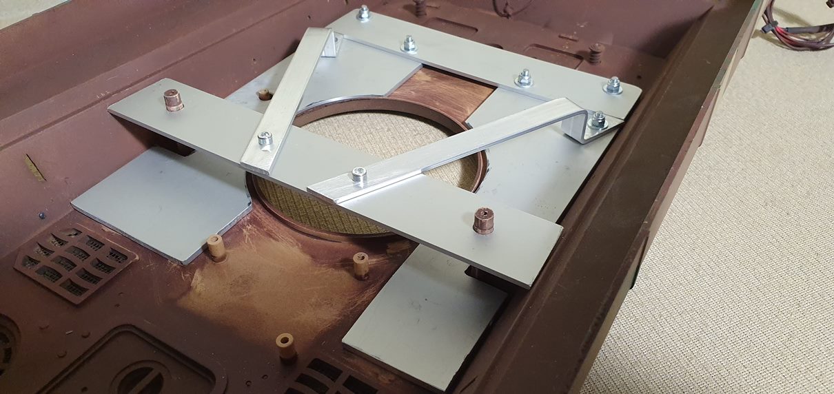

Re: Torro Full Metal 1:16 KingTiger Elevation and Recoil upg

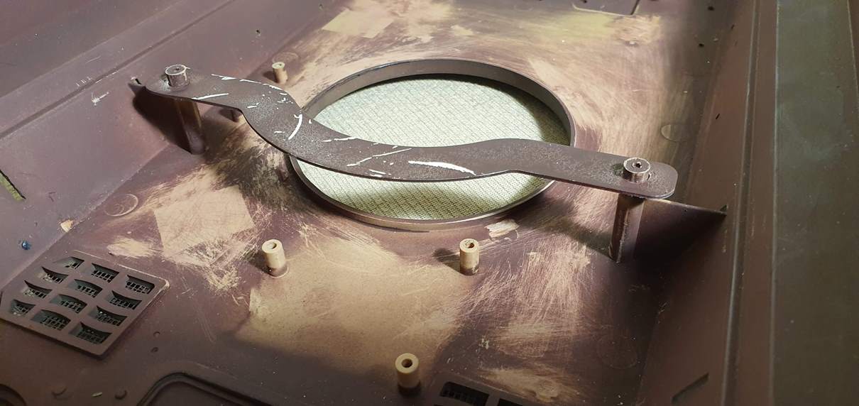

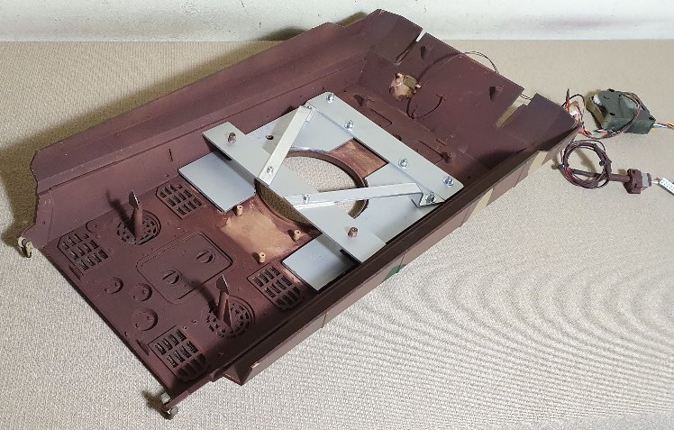

The upper hull is too weak to carry the weight of the metal turret (1,2kg) , because the turret is swinging back and forth when travelling over uneven terrain. This comes for the wall thickness of the upper hull which has only a wall thickness of about 1.0mm.
I have built an aluminum metal frame to strengthen the upper hull, and solve the undesired swinging issue.
The aluminum frame is fixed with 2 components glue to the upper hull.

Once again, a neatly conceived and executed solution
There are some members here who were once bitten by the 'metal turret' bug, but then reverted to the plastic option. There are two reasons: (1)
it's easier to modify a plastic turret, and (2); the sheer weight of the metal turret can lead to torsional problems in the upper hull, and even the model itself- as you've discovered.
'Full metal' (Turret, Upper Hull and Lower Hull) offerings from the likes of Mato offer great rigidity; but also provide a real challenge for the motors, transmission, and e-controller- because of the added weight.
We mustn't forget the increase in postal charges, either...
