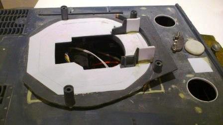

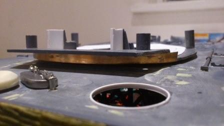

3. The turret ring is too far forward beneath the turret and the corresponding opening in the hull top is thus also too far forward in order to compensate. This means that the turret sits correctly (more or less) when the gun faces forward, but once it is turned it starts to look wrong – e.g. the rear turret stowage bin sticks out over the side of the tank when it should not. The only way to fix this is to move the turret ring and hull opening back, a job which is not for the faint-hearted. This also has important consequences for those who wish to retain the bb gun because it was presumably to accommodate the bulky mechanism that HL chose to move the ring forward in the first place. It is less of a problem for those who wish to install a recoil mechanism;

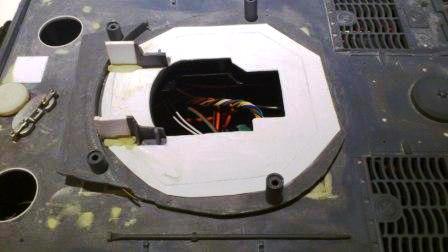

Turret base after major surgery to move the the ring back.JPG (21.48 KiB) Viewed 36176 times
And here's the corresponding carnage to the hull top before I infilled it with Milliput.JPG
And here's the corresponding carnage to the hull top before I infilled it with Milliput.JPG (24.55 KiB) Viewed 36176 times

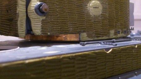

4. A related problem is the undercut at the rear of the turret. This shouldn’t be there but, because of HL’s mis-alignment of the turret ring, had to be incorporated to allow the turret to traverse without fouling on the tow ropes and gun cleaning rods. Once the turret ring position is corrected this problem disappears and so the cut-out portion can simply be restored;
Close up of restored under-cut to turret rear.JPG (76.8 KiB) Viewed 36176 times

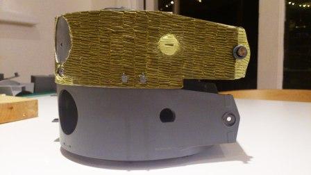

6. A less obvious defect concerns the front of the turret and the mantlet. The front of the turret actually sticks out slightly too far. Meanwhile the main gun – on the HL Tiger it sits bang in the middle of the mantlet – should actually be off-set slightly towards the right (i.e. the co-axial machine gun side). This is the sort of thing which only the most ardent ‘correctors’ should consider because (quite apart from being a pain to alter) to my eye this is hard to spot - unless you're actually looking for it!
Heng Long turret sitting atop the Tamiya one - note difference in length.jpg
Heng Long turret sitting atop the Tamiya one - note difference in length.jpg (17.48 KiB) Viewed 36176 times

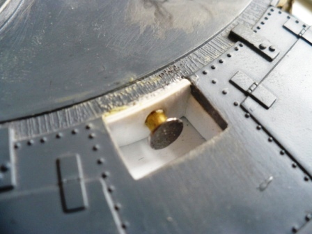

8. The side trunnions at the front of the turret sides will also need their lifting pegs added (and the one at the rear added altogether);

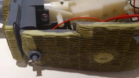

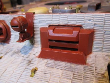

11. The driver’s vision port is moulded in the closed position. Luckily, since the glacis plate is attached by HL as a separate part it can be prised off so that the port can be more easily modified from the front and rear. Again this is a job for a little patience and plastic card;
Close up of opened up driver's visor.JPG (81.13 KiB) Viewed 36172 times

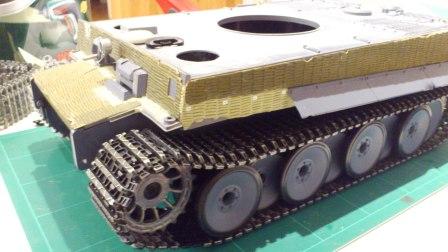

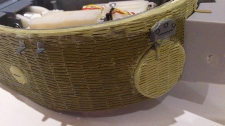

If you leap forward in this blog you will see how I improved the zimmerit.jpg
If you leap forward in this blog you will see how I improved the zimmerit.jpg (38.04 KiB) Viewed 26832 times

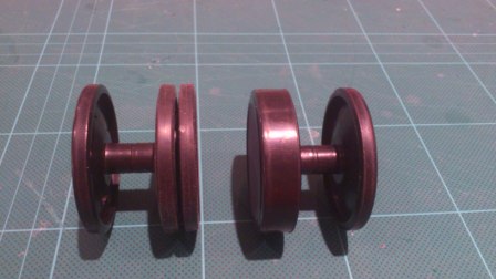

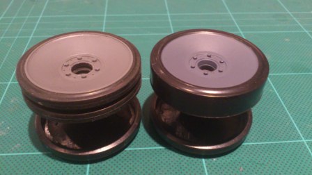

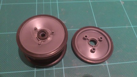

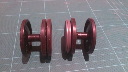

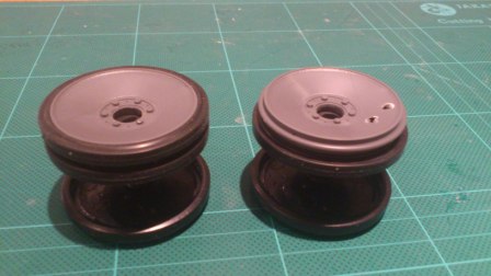

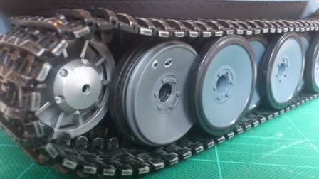

Since this is going to be a mid-production Tiger 1 the road wheels are the same rubber-rimmed types used on the earlier models.
One of the less obvious simplifications of the Heng Long Tiger (at least until you notice it!) is the use of single dish road wheels along the central track run – these are the road wheels which are sandwiched between the outer and inner wheels on each side. The real tank used double-dish road wheels at this station, but HL obviously decided that it would be easier (and presumably cheaper) to mould the wheel as a single, thick piece.
Comparing the modified road wheel left with the HL original on the right.jpg
Comparing the modified road wheel left with the HL original on the right.jpg (29.93 KiB) Viewed 36092 times
Another comparison from the side.jpg (29.39 KiB) Viewed 36092 times
Although this is almost completely hidden by the tracks (and the sprocket at the front) there is one place where it can be seen quite clearly – from a rear-quarter view the thick wheel is visible next to the idler.
There are, I guess, two options here. It should be possible to cut into the rim and make the wheel appear to be in two halves, but the fact that the inside of the wheel is hollow would make this a difficult proposition.

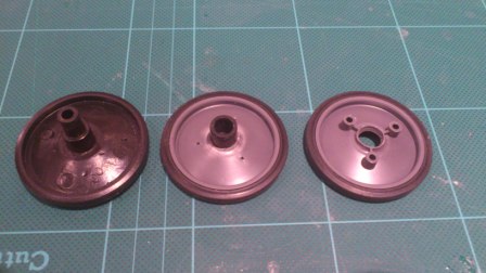

I went for the only alternative (apart from spending a small fortune on up-grading the entire running gear) – combining the inner single-dish of the HL wheel with Tamiya parts.
Single Tamiya sprues are quite easy to find on the net – especially on ebay. I bought a few different ones at the same time to save on postage from Japan so each sprue probably worked out at less than £8 each. For this fix you only need one road wheel sprue because it contains three of each type, plus four rubber tyres. The Tamiya instructions can be downloaded for free from the internet.
The first step was to remove the outer part of the HL axle from the outer wheel. This I did with my trusty rotary tool and cutting disc. However, be warned: the wheels are made from some sort of plastic compound which produces unpleasant fine dust and this should not be done in an enclosed space.
Rear outer road wheel after removal of axle shaft - messy but effective!.jpg
Rear outer road wheel after removal of axle shaft - messy but effective!.jpg (28.22 KiB) Viewed 36092 times
Once the axle was free I sanded it down to fit onto the back of the outer dish of the Tamiya road wheel. The latter then had its centre cut out so that the axle would sit behind it, exposing the screw head. The fact that the screw heads can be seen on all of the HL wheels is not, of course, true to the original tank either – but because they are inset quite deeply this is not an obvious problem and, quite frankly, there is no (sane) alternative I can think of if you are keeping the original suspension!
The three pieces ready for re-assembly side by side.jpg (33.2 KiB) Viewed 36092 times
The inner dish of the Tamiya road wheel has now been installed on the HL axle - the outer dish has been adapted to fit.jpg
The inner dish of the Tamiya road wheel has now been installed on the HL axle - the outer dish has been adapted to fit.jpg (29.32 KiB) Viewed 36092 times
Meanwhile the inner dish (of the outer wheel) also had its centre enlarged so that the HL axle would simply slide through it.
Once I had done this the tyres where slid onto the wheels and a comparison made with the HL original to ensure that the width was the same. The new wheel dishes were then glued to the axle and each other using epoxy glue and left to dry over night.
Both rear road wheels after outer hubs have been replaced with Tamiya parts - one tyre is left off to represent battle damage.jpg
Both rear road wheels after outer hubs have been replaced with Tamiya parts - one tyre is left off to represent battle damage.jpg (30.2 KiB) Viewed 36092 times
Another view of the finished road wheels showing the correct double dish on the outer sides.jpg
Another view of the finished road wheels showing the correct double dish on the outer sides.jpg (31.12 KiB) Viewed 36092 times
Once installed I felt that the effort required was worth it – even if the result can only be seen from a certain angle. There are slight differences when a comparison is made – e.g. the hex bolt detail on the Tamiya wheels is much better than the HL wheel nuts – but overall I don’t think this will be noticeable – especially once I have added some mud...
The finished road wheel installed on the other side.jpg (35.33 KiB) Viewed 36092 times
While I had the opportunity I also added added some battle damage to one of the wheels – quite common from the evidence of war time photos. Indeed, it wasn’t uncommon for road wheels to be dislodged altogether. For the time being I have also left off one of the tyres to simulate one having worked itself lose.

Next:

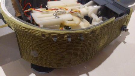

The Turret Fix
As mentioned above, the Heng Long Tiger 1 turret is split along its side to allow access to the inner workings. This is not as logical as the Tamiya turret which, like the real thing, has a separate turret roof. I can only presume that the people at HL designed it this way because the bb gun pivots between extensions which reach down from the roof and up from the turret floor - and is also sprung against the roof - so the whole thing relies for its strength on the top and bottom of the turret being held firmly together. Anyway, it works.
Unfortunately it also means that there is a quite arbitrary line where the two halves join which stretches around the the sides of the turret. It's not especially noticeable on the unmodified tank - partly because the split lines up with the undercuts at the turret front and rear. However, once the rear undercut - which shouldn't be there - is filled in (see above) it starts to look more noticeable. Then, if you want to add zimmerit, it becomes a real pain.
So why not just forget about it and entomb the whole thing in zimmerit anyway? Because (knowing my luck) something electronic or mechanical would quickly go wrong inside and I wouldn't be able to get at it...
The solution, which came to me gradually, is simply to move the join between turret top and bottom to underneath the turret by cutting the lower side portions free of the turret base and attaching them to the upper sides. This is made possible because what actually keeps the top and bottom halves together are the long screws and their mounts which stretch up inside clear of the sides. It's thus relatively easy to cut along a line between these screw mounts and the lower sides and leave the turret base a little naked - but intact.
Close up of right front of turret with lower & upper sides now attached and zimmerit.JPG
Close up of right front of turret with lower & upper sides now attached and zimmerit.JPG (18.33 KiB) Viewed 36013 times
Close up of left front of turret with lower & upper sides now attached and zimmerit.JPG
Close up of left front of turret with lower & upper sides now attached and zimmerit.JPG (19.62 KiB) Viewed 36013 times
Underside of commander's corner of turret.JPG (18.75 KiB) Viewed 36013 times
Underside of loader's corner of turret.JPG (18.53 KiB) Viewed 36013 times
Rear underside view showing restored undercut and new stowage bin.JPG (14.75 KiB) Viewed 36013 times
The remaining turret floor after the lower sides have been cut away and attached to the upper sides.JPG
The remaining turret floor after the lower sides have been cut away and attached to the upper sides.JPG (19.27 KiB) Viewed 36013 times
View of turret floor from the other side.JPG (17.25 KiB) Viewed 36013 times
This I accomplished with my rotary tool and a cutting wheel. It's messy and I admit I could have done a neater job, but once it's finished you can't see the ragged cutting line anyway because it's hidden beneath the turret. Well, actually - as I soon realized - there is one place where you can see it - along the curved front of the turret base beneath the mantlet. I scratched my head about this for a while before I came up with the solution - a strip of metal which overlaps onto the side of the turret and thus conceals the join.
Copper strip added to underneath of mantlet to conceal the join between upper turret and floor.JPG
Copper strip added to underneath of mantlet to conceal the join between upper turret and floor.JPG (15.52 KiB) Viewed 36013 times
Reunited turret top and bottom with copper strip concealing join.JPG (19.26 KiB) Viewed 36013 times
It seems to have worked pretty well. One side-effect of all this surgery is that the turret bottom loses some of its rigidity (not that it had that much in the first place). The metal plate added to the rear lip in front of the stowage bin (of which more below) is one attempt to add some strength.
