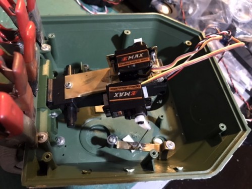

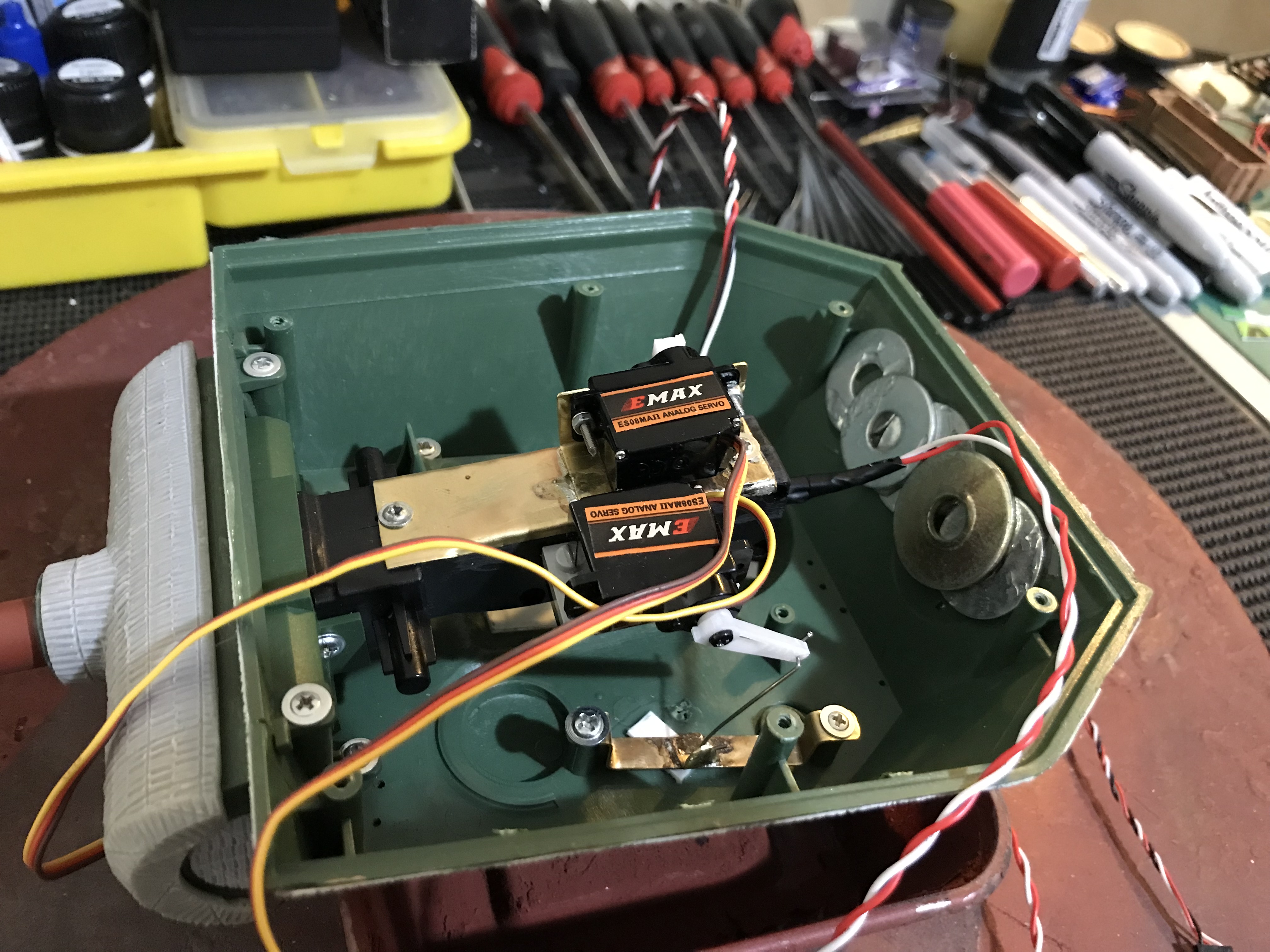

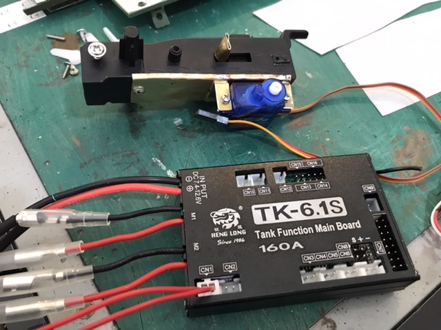

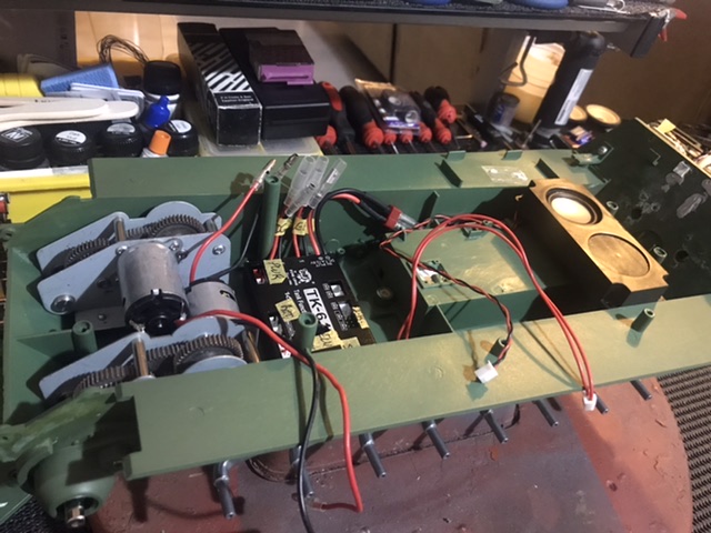

Trying to post a bit of catch up.

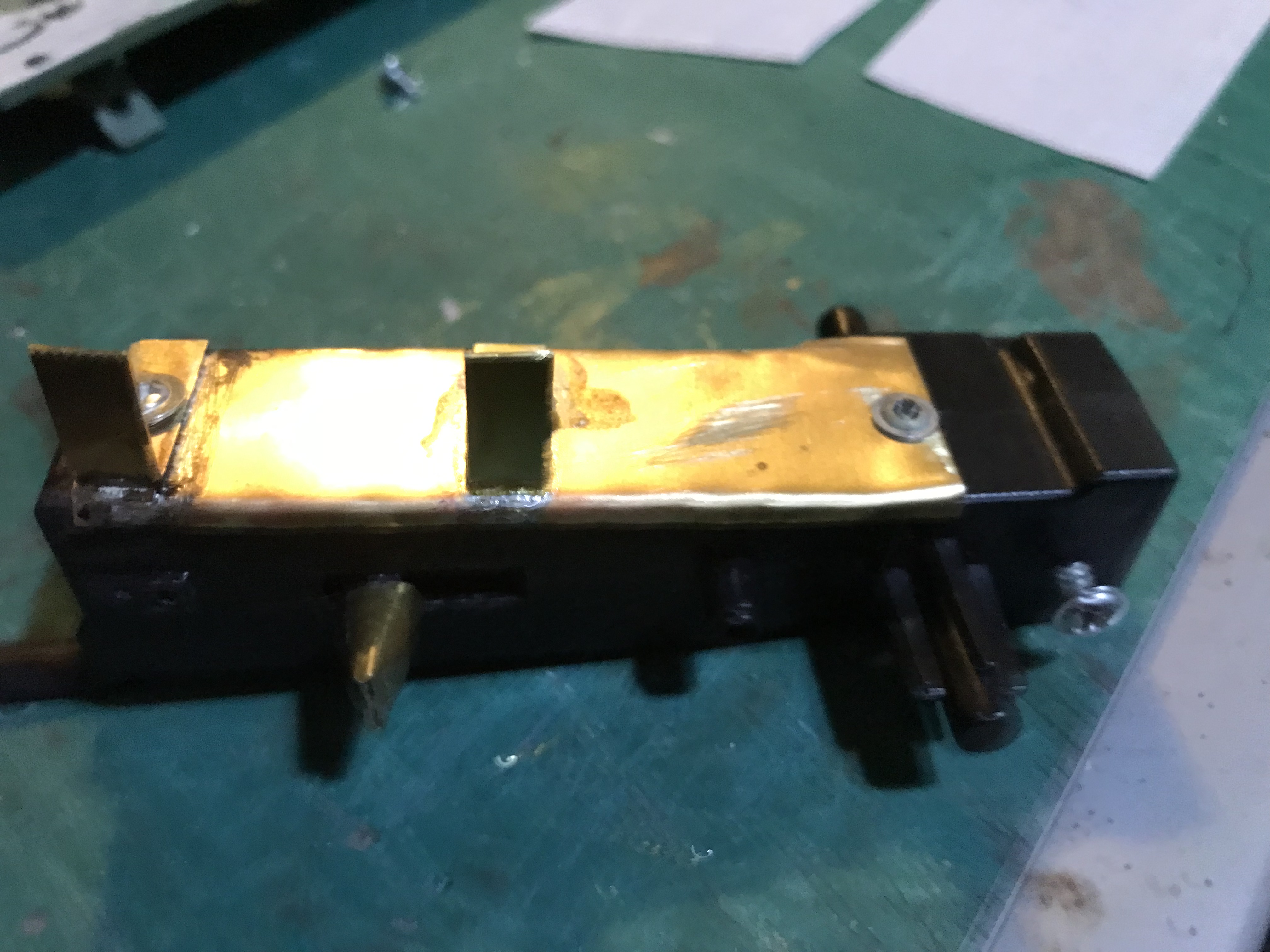

I sliced the lower mechanism off the HL recoil unit and plated over it with brass, secured by lots of epoxy glue and a screw.
To this was soldered a rudimentary mount for a servo.
That provided a strong foundation for the recoil servo to cycle the barrel.
On the other side I used a lego piece to mount a servo for elevation.
Using a 6.1s control gave me the ability to use a simple & cheap set up.
The pivot area that the mantlet is secured to is very tight, that is it functions well but has no slop. I cant stand that wobbly barrel syndrome.
It was a bit of trial & error to get the link lengths right and which servo arm to use, and within that which hole in the arm to spot the link, but I got there in the end.
Also had to epoxy a row of washers onto the rear of the turret to get the balance right.
I would normally use a stick on mag wheel weight, but rather than go & get some I used what was to hand. A Rough but effective alternative.
Those familiar with using servos get this as a basic thing as simple as wiping your ass BEFORE pulling your strides up, but to others like me it requires a more careful approach in case I get a poopy outcome
Im sure as I do more of them it will become a subliminal function.............
Tested & works a treat.
Thanks to an insightful Mr 43rd Recce, getting the 6.1s to make the right noises was easy and I thank him & others for that.

- tankme
- Posts: 1949
- Joined: Tue Oct 31, 2017 3:51 pm
- Location: Elgin, TX
Re: PANTHER 111, 116TH WINDHUND Dv, HOUFFALIZE 1944
I recently added a servo recoil to my T-72 using a 6.1 board and the servo would recoil forward instead of backward. Since there is no way to fix this on the radio I had to place a "servo reverser" inline to fix the issue.
