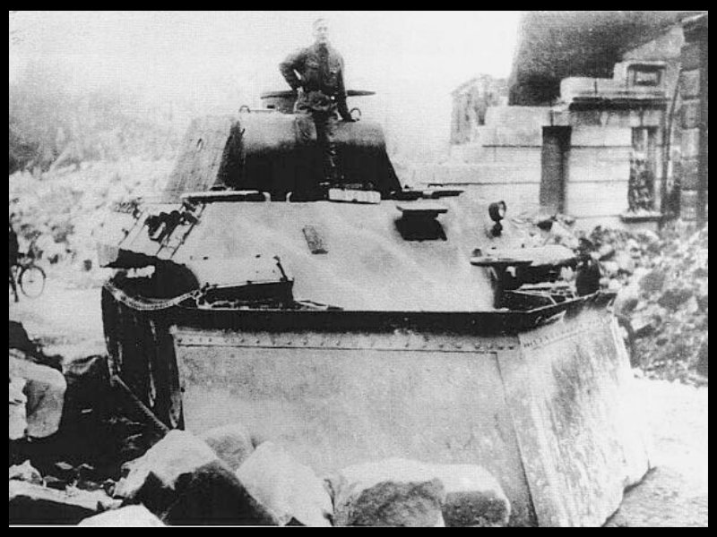

Evening folks, had an H/L panther G for ages just lurking on the project shelf.
Going to make it into an early 'D' turned into a bulldozer used in the rubble strewn streets of Nuremberg.
Its a rare beast indeed, not only a D, but the only ever photographed Panther version fitted with a bulldozer blade device.

Herman this is another example of you bringing something unusual and exciting to the forum! I will watch your progress closely.
BTW is the blade simply fixed and welded on or is it articulated with cables and steel arms?
Good luck with this complex project

Good morning Mr Rainford, yes it is a lot of work relative to the outcome of no gun tank !
But it’s just so odd that it’s worth doing just for that.
The blade is attached by I-beam arms , the top ones off the towing eye points, the lower off mounts from the transmission cover plates.
There is a large handwheel that is allegedly for adjusting the blade height that runs on Pz1 road wheels which I have a pair from a benefactor overseas.
I will make the blade from brass, and ballast the hull so it can really push without pulling a burnout .
I will admit to feeling rather committed when I sliced the side plates off the panther !!
