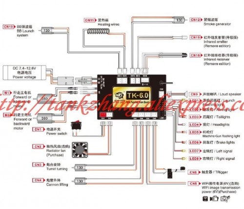

And this is the stock command board: (Heng Long TK-6.0)

The TK-6.0 is the improved vrsion of the RX 18,more faithful sounds,rolling,accélértion,etc.Possible plugged more Leds for lighting,etc.Perso i would say that the for le the Radio (TX ) is the same,just that it ill have to the " Binder " paired with the new platinum :D
Schéma TK-6.0
Schéma RX 18

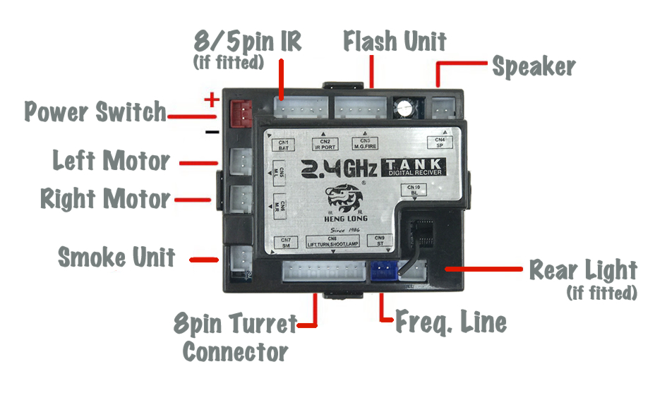

Reading the post,then again to reread,I was wrong an the TK06 motor son used are with mâle pods,idem Tamiya ??you wild find this at Norauto,Midas,greens lights,etc,and you can easily reweld new wures on the ngines,do not change anything on TK ? Cause waranty,si problems.Possible also order matching ? but for me first ideal version :thumbup:

The motors you have purchased simply have the old 5.3 version mfu plugs on, the tk6.0 has bayonet fittings for the motors you need to simply fit male (i believe ) bayonet fittings to you motor wires and plug them into the tk6.0 motor female bayonet fittings.
The transmitter as far as i know on the tk6.0 is different from the v5.3 earlier version and is not compatable as it has a totally different electronics board inside (even though it looks the same ) as the tk6.0 has many more functions than the earlier v5.3 activated by multiple combinations of the transmitter buttons.
Make sure you have plugged the power into the correct port on the tk 6.0 mfu.
And pressed the engine start button on the transmitter to wake up the mfu,
If your model came as standard with the tk6.0 version then the old motors will have had bayonet fittings didnt they ???
