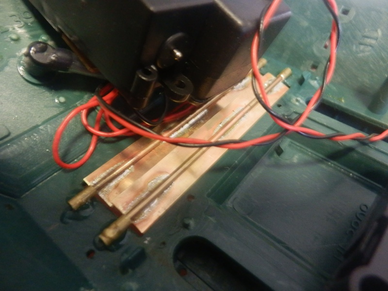

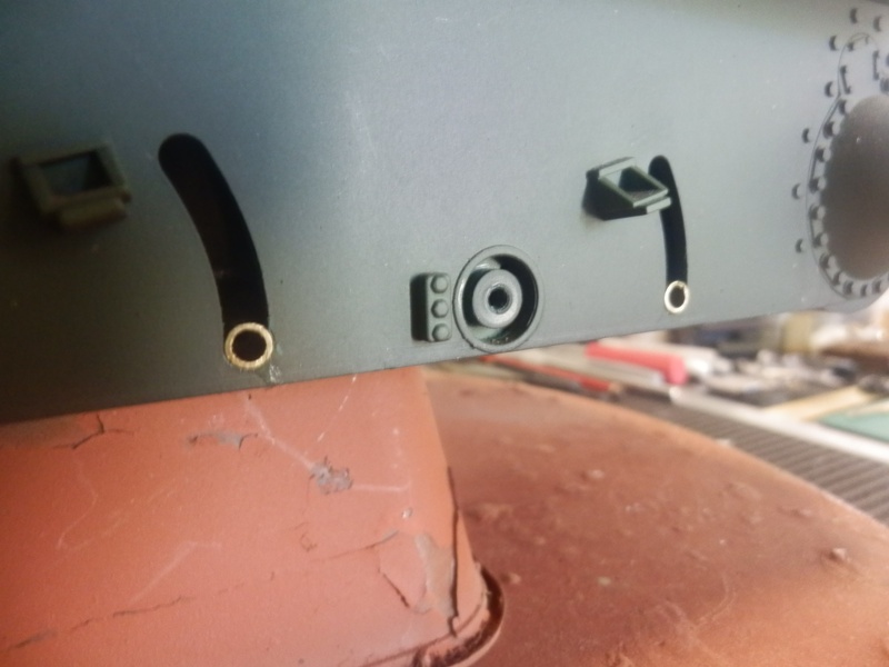

First I cut all the mudguards off (ya just cant give me anything good), took it apart & removed the engine deck rear hatch. Then the lowering of the suspension sit using short bits of 5mm tube(toob to you left-hand-drivers) superglued into the travel slots to lower the suspension arms & give the tank a better poise.

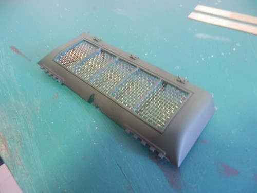

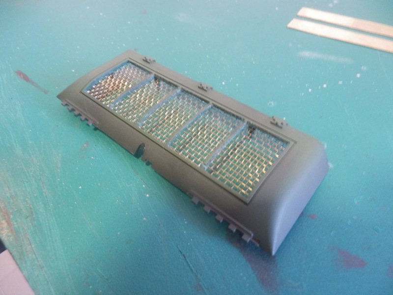

The engine deck cover is a painful yet necessary mini-project to get rid of the all plastic mesh that isnt mesh, and replace it with actual mesh inside actual open sections of deck cover. :/
On my Bedspring version, I use this access to lube the gear boxes. This one will be the same, although I wont go as far as making the louvers that should be under the cover.

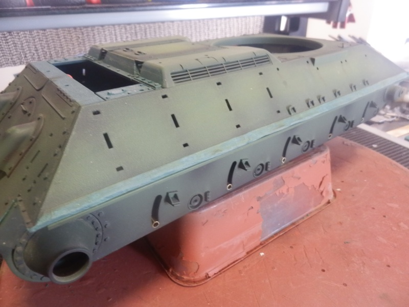

I did decide to add the louvers under the engine cover.
Mainly so the gear boxes can be lubricated.
Even though this is going to be a simple & cheap/free build, I need to predict the future.
I went through my boxes and boxes of 'snot' parts & found some metal drive sprockets & idlers(no idea where or when they were procured :/ ), so I will put those to use.
ENGINE DECK LOUVERS
ENGINE DECK LOUVERS
RIDE HEIGHT SPACERS
RIDE HEIGHT SPACERS

It is turning out very well. Phil Upton would like that upgrade on his suspension tweak muchly. He may still be here on the forum and can chime in some appreciation. Super neat job on the louvers and grills.

Thanks Mr Painless, the suspension lowering is just a mandatory for these things out of the box.
The engine deck cover mesh is also a must-do. The filled in plastic just does not cut it.
Getting all the infill out is not a quick process, but its well worth the effort.
I will not hinge the cover though, thats a bit unnecessary for this cheap & cheerful version.

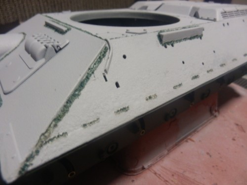

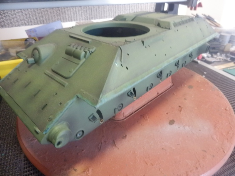

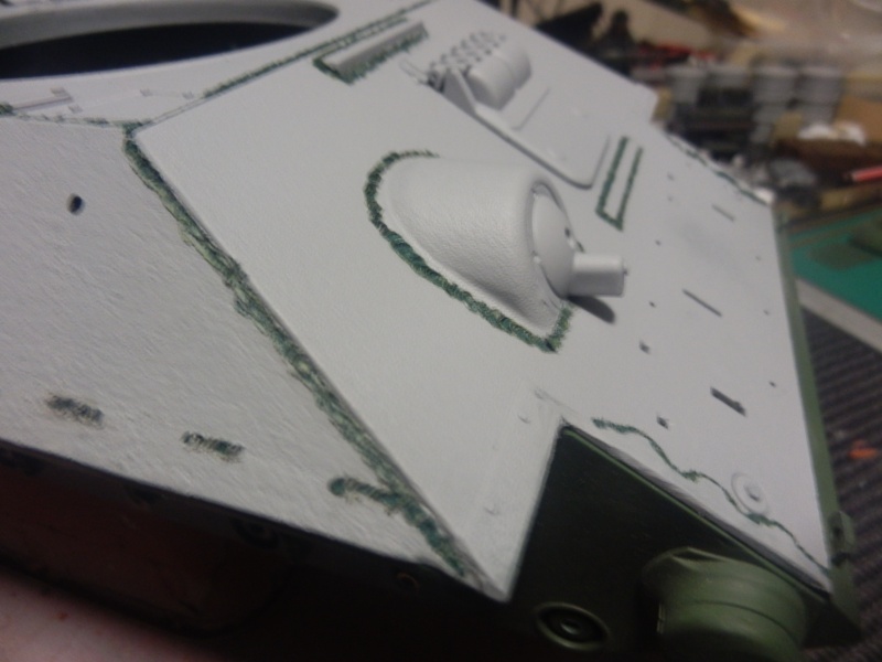

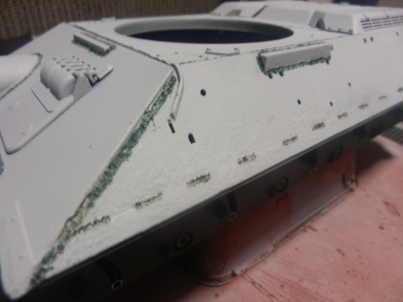

Tonight I've added putty on both sides and stippled a stiff brush over it to give a bit of texture, but more importantly to blend the surface together after cutting the mudguard runners off.
The real things were stitch welded to the sides, not bolted like German tanks of a similar size.
Pictures show they were only stitched on the top edge, not underneath as well, so if levered upwards enough, or enough times, they do break off.
Once the putty is dry I will hit it with Mr Surfacer 500 to further add to the texture of the armour.
Downside of removing all the mudguard runners is now I have to simulate weld along the entire hull where the sides meet the sponsons ! :/

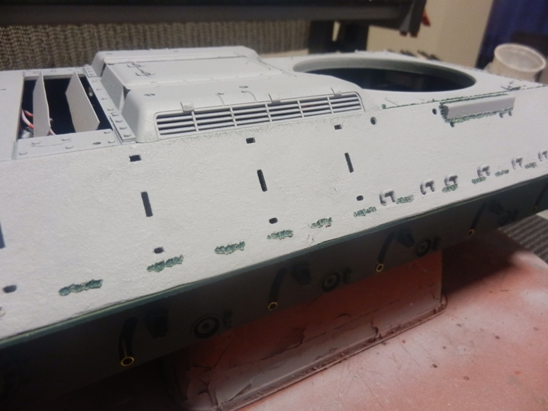

Got some welds on.
Used my melt-method to get the rough look of welded joints in the relevant spots.
Its very liberating to know that rough-enough is good-enough !
Just like the real ones. ;)
I can feel myself sinking into the abyss that is "do it properly,load it with metal parts,get the details right"
But I'm trying to resist !!
missing guard welds
missing guard welds
