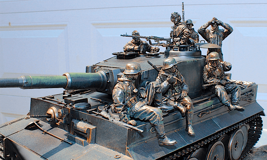

Hi Jon! Did pretty much the same thing with Merit/WSN parts and barrel moved over to a Heng Long turret. I also used a Mato cupola for a friend's "controversial" commission piece using Jeff Shiu figures. Worked perfectly for his needs. He didn't want any zimm though.

Some of my fellow modelers and especially figure painters thought the bronze "statuary" treatment with green patina was an unacceptable use of the tank and the Jeff Shiu figures (about $300 worth of figures!) despite the multiple stages of dry-brushing and washes. Not necessarily my cup of tea either, but I was happy with the result...in the end. This was designed as a sort of war memorial tribute to German tank crews. And I had a blast doing it. Besides, it led me to you guys here at this site!

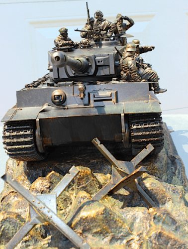

I did not intend on taking more pics before I primed it but I want to show how to fix the bulges on the bottom of the WSN Tiger.
You can see in the pic above of Jumpugly's WSN Tiger he used on his war memorial diorama that it has two bulges in the front lower plate which is incorrect for a Tiger I. They are there to accommodate the gears but the bulges themselves are unnecessary, the gears only actually go to the plate, not beyond it in the front so I cut off the bulges carefully without damaging the gears.
