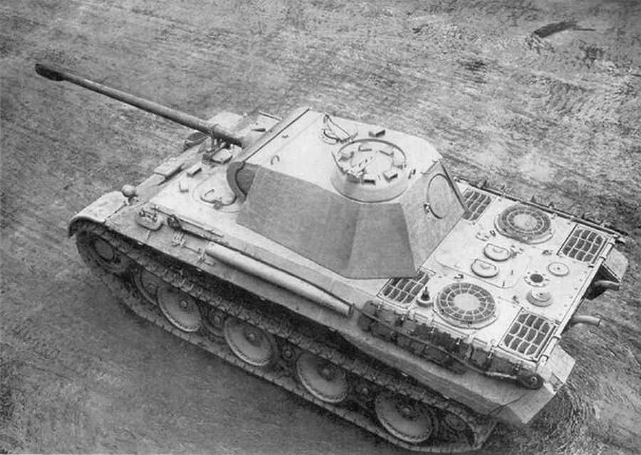

My next tank had to be a Panther, and if I had to pick one, I’m going to do an ‘A’. There are several reasons for that. Firstly, I don’t like the asymmetrical rear deck and mantlet chin of the 'G'. Secondly, I don’t like the letter box MG and old-style cupola on the ‘D’. Lastly, and probably most importantly, making an existing Heng Long into an ‘A’ is enough to challenge my skill-set.
Panther A
Panther A
panzer kampfwagenv_ausfa.jpg (68.91 KiB) Viewed 6325 times
What makes an ‘A’? It depends on the field upgrades really. It seems legitimate for an ‘A’ to have:
• rounded mantlet chin
• no mantlet top debris shield (some were field installed)
• no close defence turret ports
• no smoke launchers
• rounded cupola
• stepped rear side sponsons
• sloping sponsons and hull rear to match
• hull MG Kugelblende
• fixed hull periscopes (3 as the fourth was deleted with the Kugelblende sight)
• single headlight on left side of front hull
• skewed front hull hatches
• matching rear fan vents
• wavy rear deck louvres
• central engine vent has no cowl
• dished road wheels
• left exhaust with/without triple pipes and no flame suppressors
I don’t want to make a rivet-counter’s delight, but I do want to make it close enough to please me. There are a few ways to go about it, including accurate bespoke parts from Ludwigs Hobby Seite, but I’m happy to do it on the cheap and not be scale perfect.

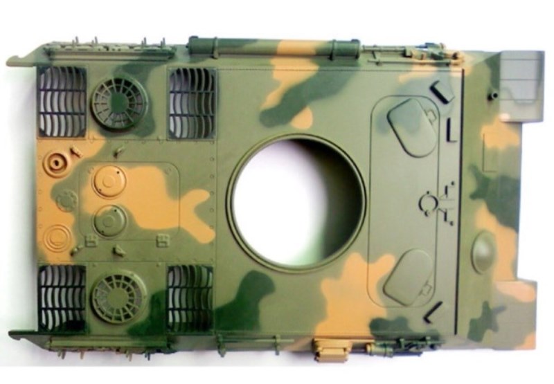

I also bought a Pantiger upper hull from Aliexpress, as there a bunch of bits I can use to make the required changes.
Pantiger upper hull
Pantiger upper hull

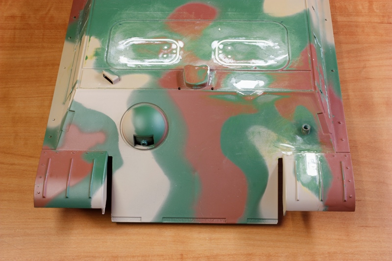

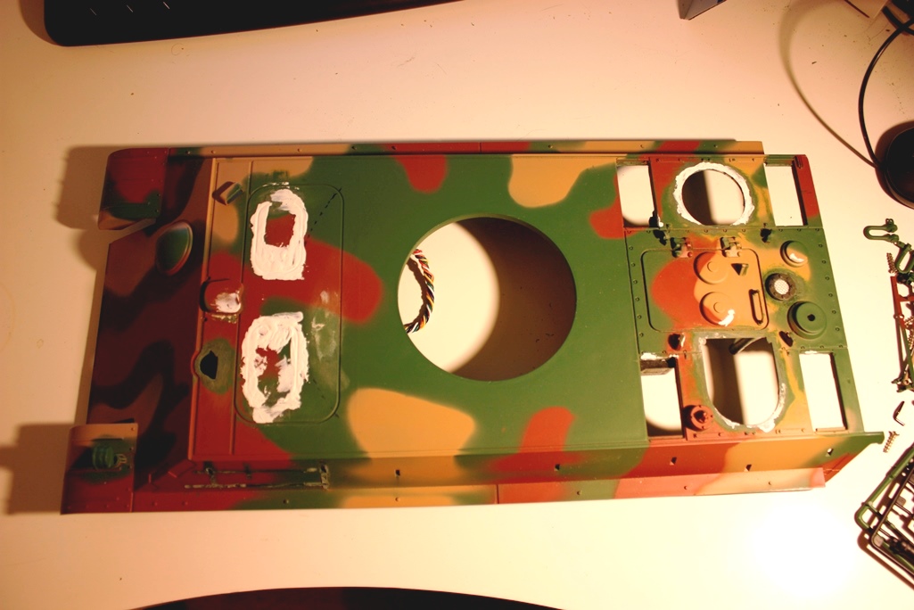

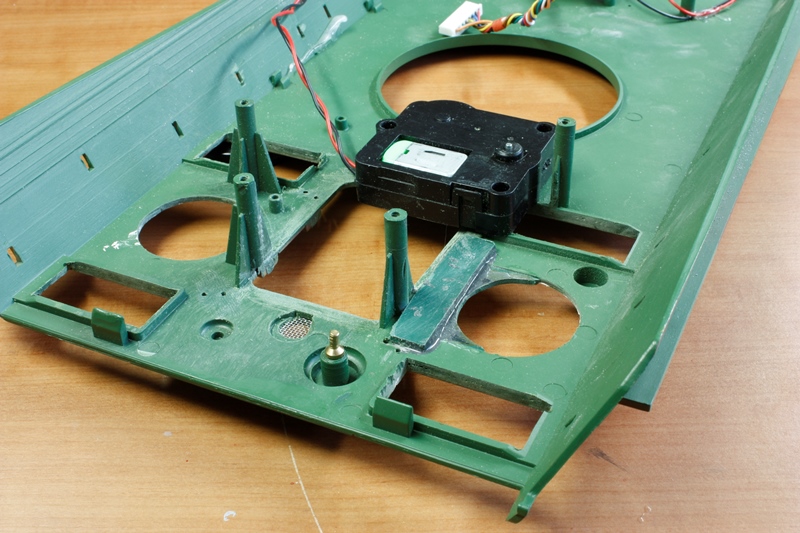

So here is the latest:
Mostly its cutting and drilling, with a couple of fill-ins.
The front has the ‘G’ periscope and old hatch lines and hinges removed. I also scavenged the head light post from the Pantiger and moved the mounting point from the mudguard to the hull.

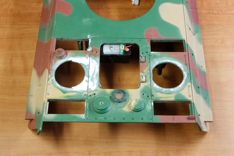

The rear has the old grills, engine cover, engine deck hooks and engine vent cowl removed. A new vent grill has been installed and the hole for the left fan housing filled. As you can see the turret rotation motor projects into the engine cover space, which is inconvenient but not surprising.
Here is what it looks like from underneath. The body posts pop up everywhere and their bracing also had to be trimmed but not as badly as in the Tiger, so I don’t think I’ll reinforce them. I’ve braced the infill for the fan housing with off cuts from the Pantiger hull and JB Weld.
