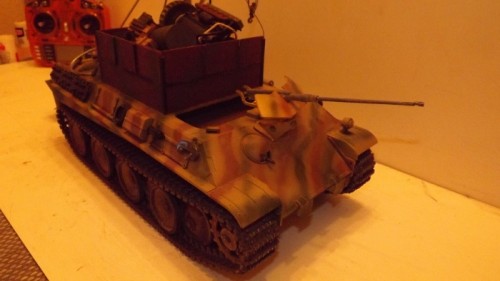

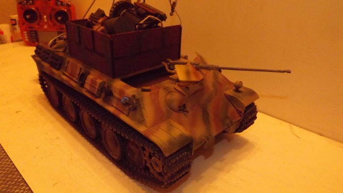

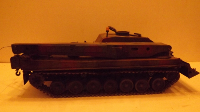

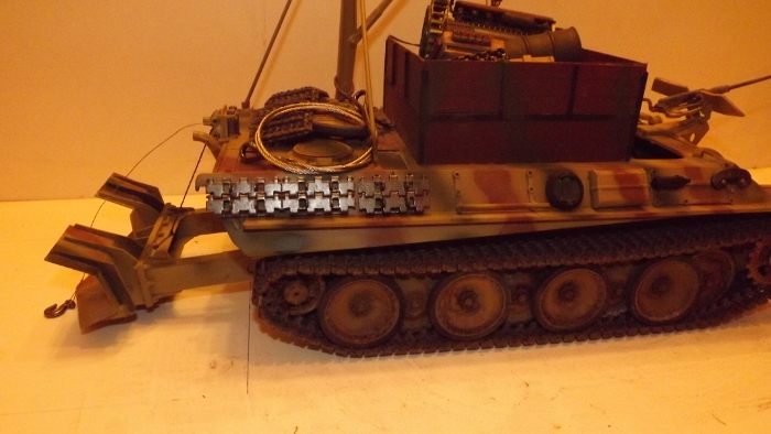

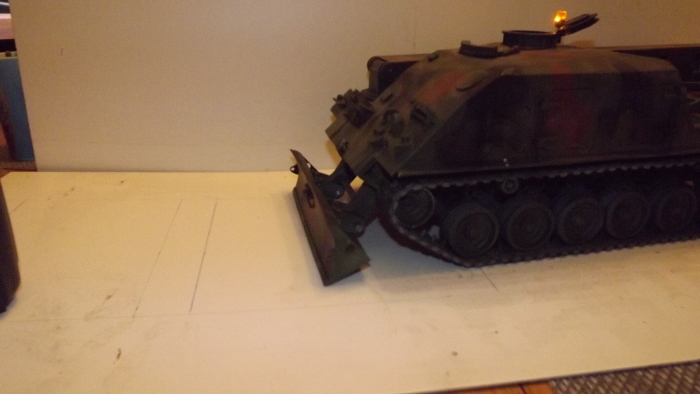

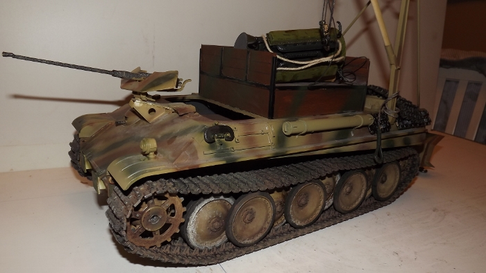

Hi Guys been struck with berg madness , not built one berg but two first is Bergpanther second is a Bergpanzer 3
take a look at photos its taken me 12 months to do both of them.

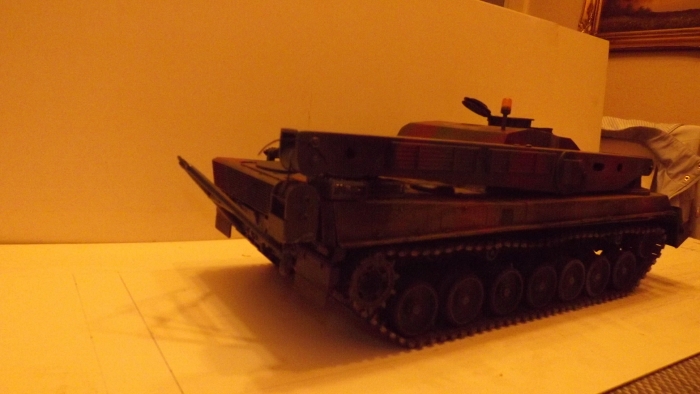

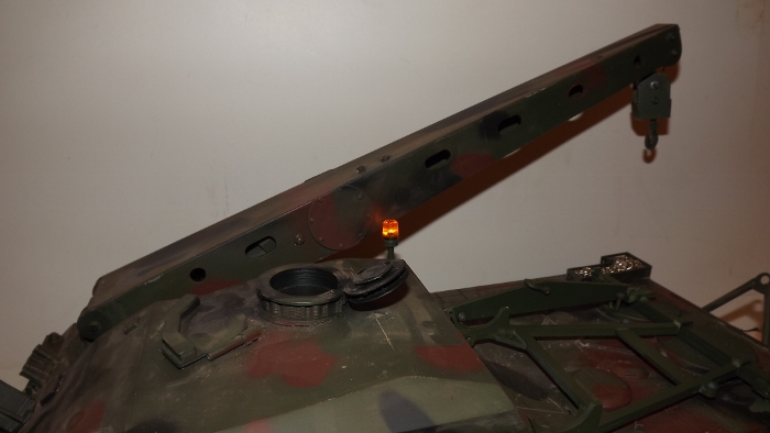

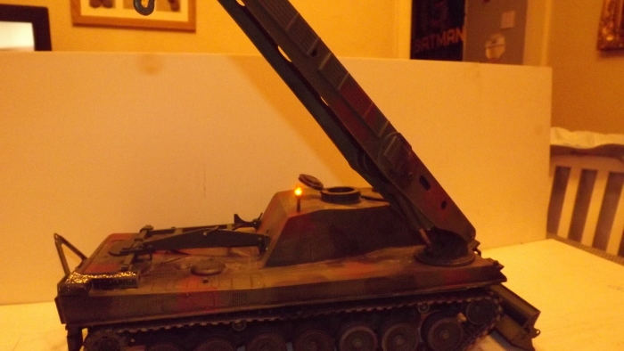

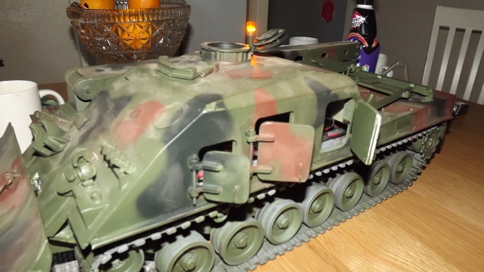

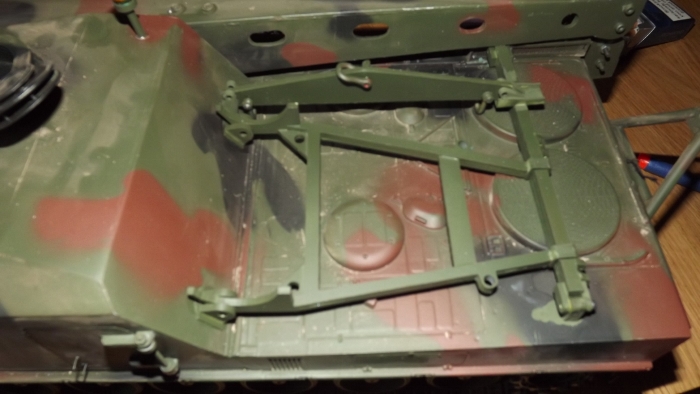

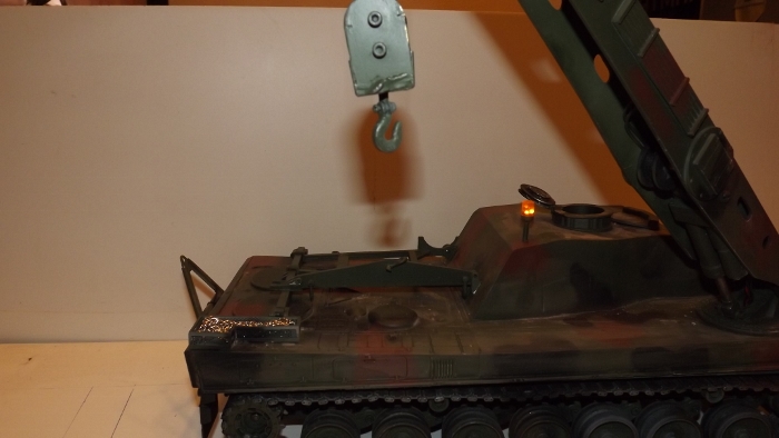

Here are photos of Bergpanzer 3

Hi the bergpanther has working spade and winch ,The bergpanzer 3 is full 8 channel dozer blade ,winch, towing arm , crane takes 3 channels traverse , elevation and crane winch , plus two channels to drive.
regards pete

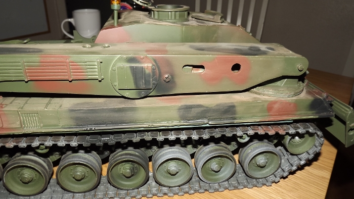

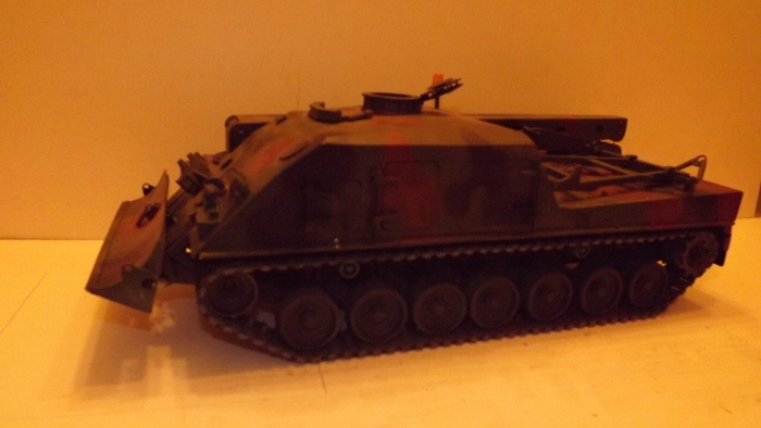

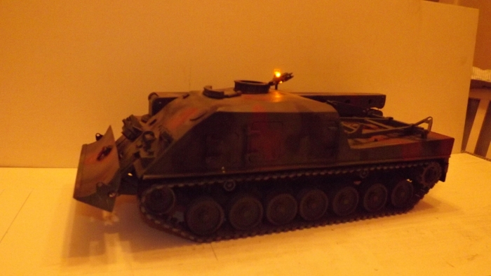

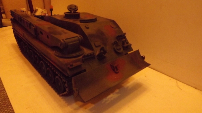

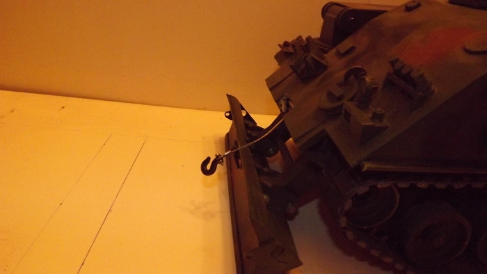

Hi Rob its slightly different from the one I got from you , Had to put metal tracks and suspension, reinforce the lower so it doesn't twist, that was the start point, first made the crane work winch and boom then the traverse (which proved to be the hardest to get it working), bought the dozer blade on a few bits for the back from Ludwig , made the ram for the dozer ,fitted a winch at the front and also fitted a winch to rear to operate the towing arm cut doors in the side, then sorted the electrics out, IBU plus 5 other ESCs and fitted yellow flashing light. Then slapped some paint on need a big muddy puddle now to weather it .
The upper you made is so strong, in fact had to cut away some of the frame work inside to make room for the bits needed to go in. and its still very strong ,the crane has lifted a Tamiya Tiger up to an angle of about 45 degrees , it is still very strong. Good design Rob and well put together, couldn't have made it without your upper .
regards pete

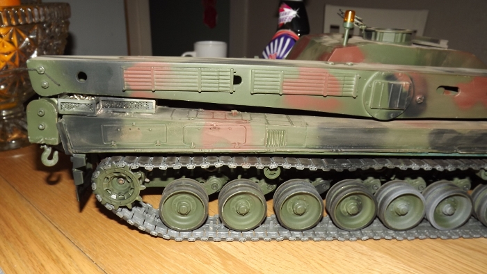

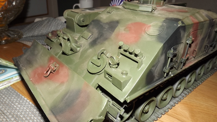

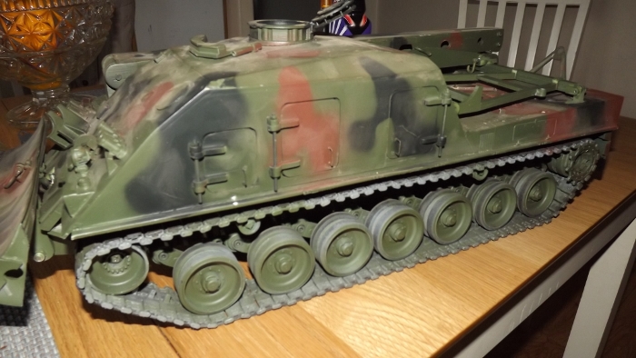

Hi Here are some more phots of outside

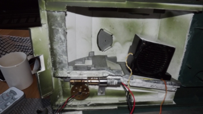

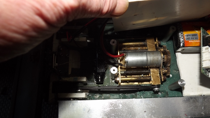

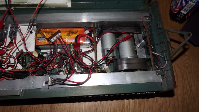

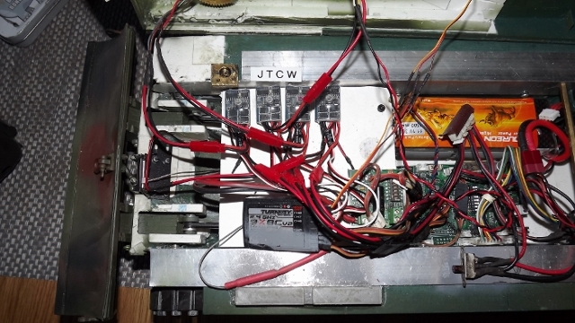

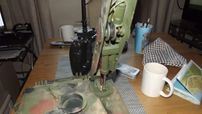

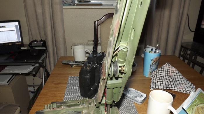

Here are some photos of what makes it work.Took a while to get some of it working right traverse being the hardest because it such a tight space and trying to find worm gears that are correct size is donkey work.
regards pete
