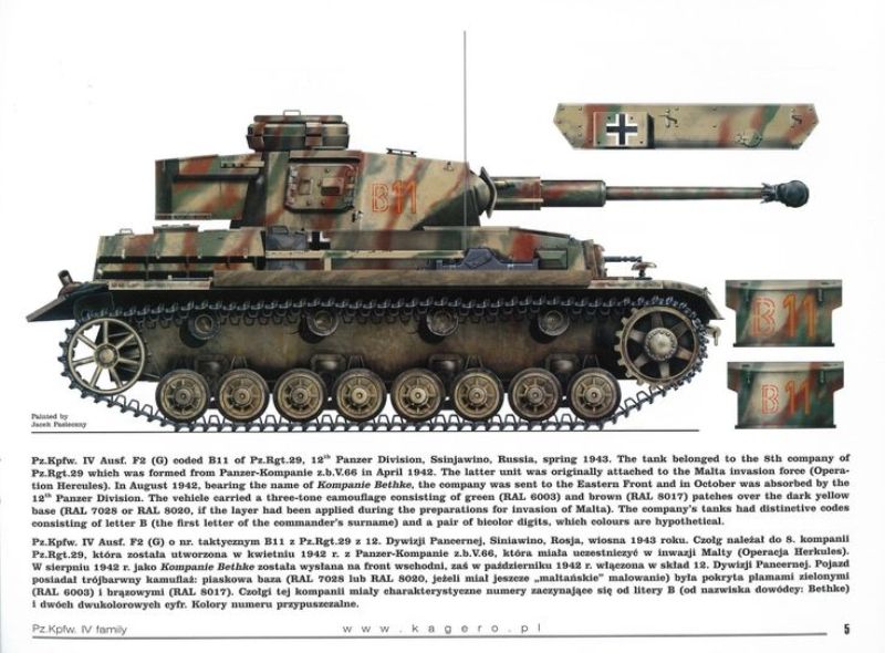

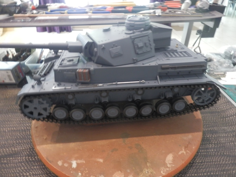

Well lads, its time to return to my roots & build another German tank !
I've had this IV F2 for a while now and been looking for a suitable subject to get after.
There are a few high quality IV conversions on the go now which offer so much great how-to info, so it would be silly to cover the same ground.
Lots of research and learning on the many variants that the IV went through leads me to dub it "The German Sherman"
Ongoing improvements, up-armouring, upgunning, reliable, and versatile the Pz IV is everything the Sherman was.
Workhorses and grafters................no show pony's here.
Along the meanderings through the well populated pictures of these machines, a few facts surfaced.
- the F2 was a very low production model before a few changes made them into 'G's.
- F2's were the first transition into the L43 75 main gun to counter the T34 threat.
- F2's went through various upgrades on the fly to enhance their combat effectiveness, and to standardise them with production G and H models.
- F2's were tagged for the aborted invasion of Malta (operation Herkules) with a strong possibility that they were camo painted over a base of desert yellow when landed in Russia.
Its these machines that ended up in the 29th rgt, 12 Pz Div, in Russia 1942-43.
I intend to try to reproduce one of these Malta Invasion machines, B11, and its colour scheme in Russia, retaining it as a base F2 rather than a G.
Turret Schurzen might be in order as at this time the added armour fit out was well under way.
Perhaps the only strictly non-F2 thing I would like to add is a 'G' muzzle brake...............The globular one is awful !!!
Anyway, here goes............

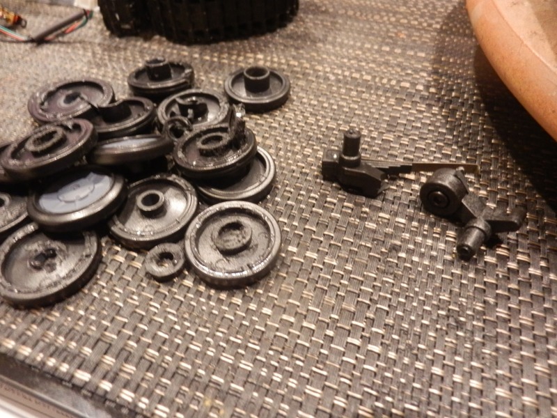

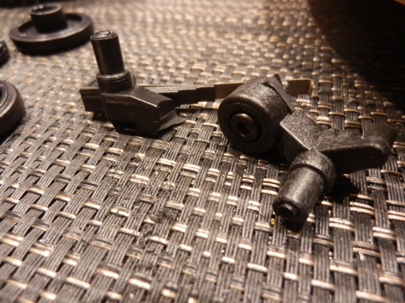

Got to say, this one aint endearing itself to me at all :problem:
The suspension is a pain in the proverbial to get removed, tough if I wanted to re-use the plastic suspension arms because one I broke in half completely getting the roadwheels off.
The ole HL glue masochist strikes again !!
I have a bad feeling about the state of play once I set about removing the final drive mouldings, and the return rollers.
Can just see the carnage unfolding because of that damn glue........... :-<

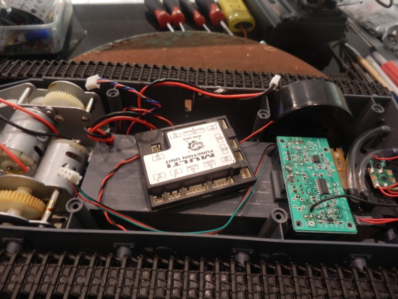

The standard electronics have been gutted & will be replaced by a 2.4 G set , once they come back into stock.

Just a note Herman...on the suspension...if you are going to change them out for the metal versions...make sure you save those stock springs...I think you will find the stock plastic HL units work much better than the metal...Ask Arnie :haha: :haha: ...I mentioned the same mod to do on his Taigen when he modded his...he had a devil of a time finding the HL springs which actually work better than those on the metal cousins ;)

Yep, I have the standard single leaf springs, but three of the arm assemblies are busted.
The roadwheel retaining screws were retained by the HL glue inside the wheels bacause of the inner hubs, so I had to cut the wheels with side cutters to access the retaining screws.
Then to get them out of the suspension caused the breaks.
Not the end of the world, just annoying.
The standard leafsprings will go back into the metal assemblies as recommended, on the way from
