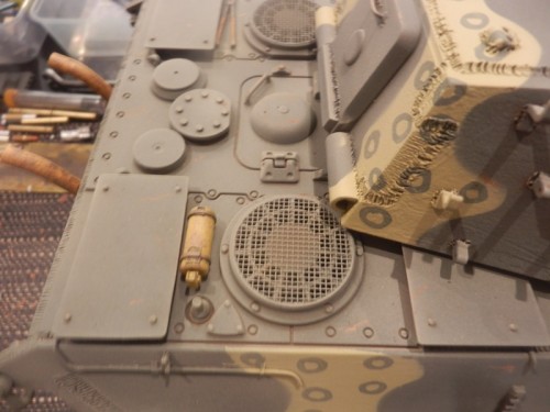

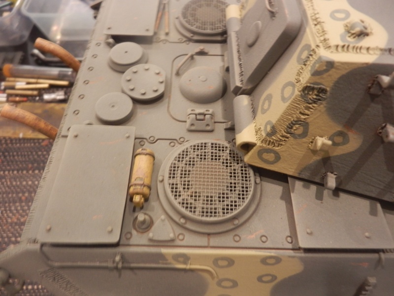

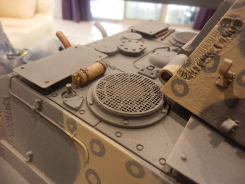

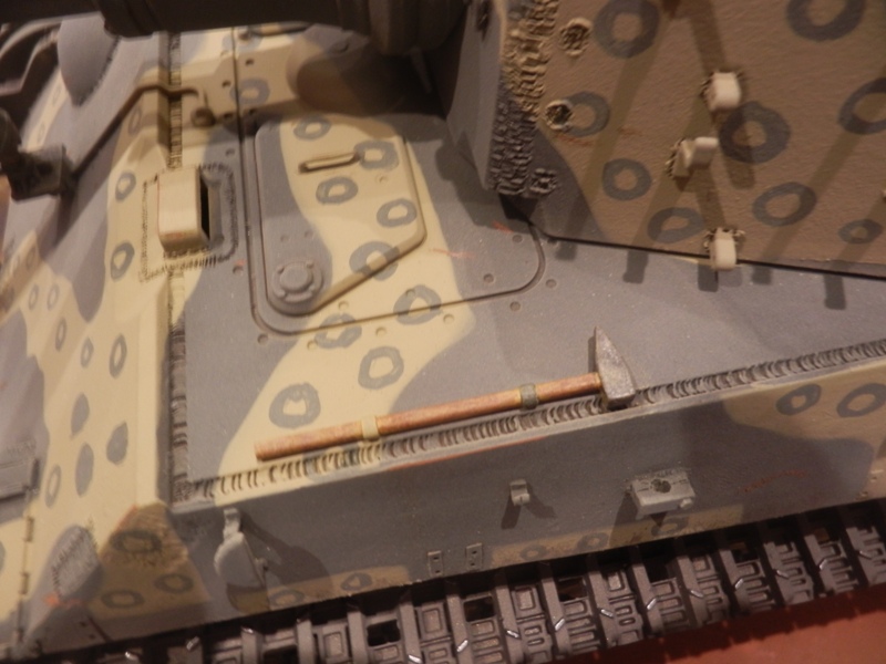

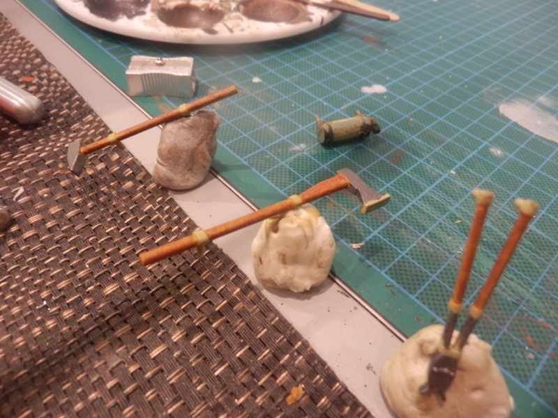

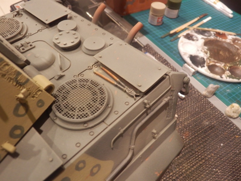

Got on to the tools. Used the serated edge on a swiss army knife to score the wood grain into the handles. Use oil paint raw sienna as the base coat. Put on pretty thick so as to use the brush to create texture. Then a dry brushed coat of burnt sienna to bring out the surface. Seemed to work.
Match painted the mounting brackets to the hull & used gun metal base with a flat black dry brush cover on the tool heads.
Very light dry brush with buff to match the dusting & thats all.
Did the fire extinguisher in an acrylic yellow base with a desert yellow cover & a dry brush buff over top.

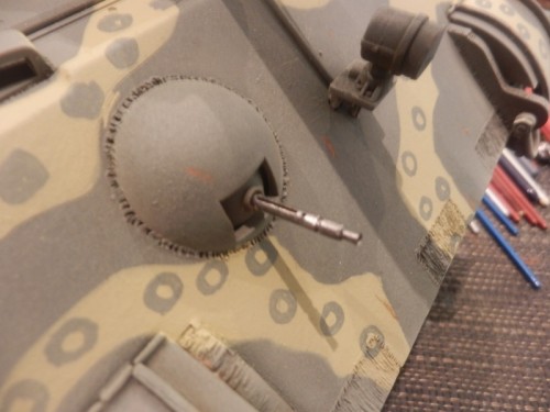

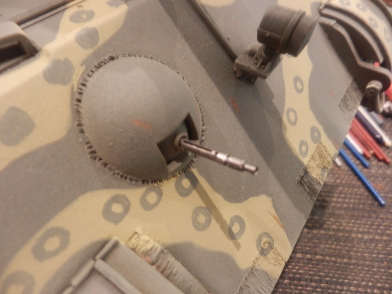

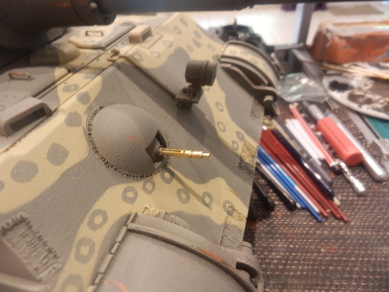

Looked at my Aber MG with remorse as I got out the saw
Had to shorten it to fit into the ball mount.
Opened the hole in the ball slightly by spinning the drill in my fingers, then heated the end of the Aber MG with my burner.
Melted it into place. Jobs on.
Gun metal base, but I just cant bear to cover such a nice accessory with the green like it would have been.
The fire ash that got into my clear coat was picked out by blade & the red primer shows up nicely.........another accidental bonus.
Every primer 'chip' you see is a bright-white ash spot removed.

Looks really good Herman, the welds on the top of the hull and cut marks look really nicely done.
My only constructive comment would be the jack, jack block and jack holders were deleted from King Tigers around December 1944.
