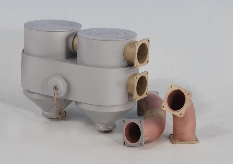

- modified Feifels to early two drums type
- Added wiring to the smoke grenade launchers, and smoke grenades
these are the main components:
completed smoke launchers
and then the Feifel modification:
