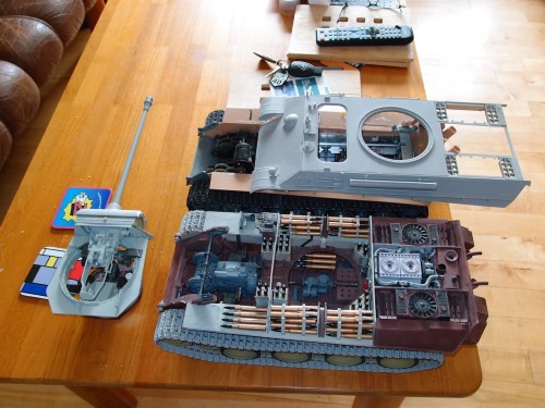

Today I spent 3 hours deconstructing the Trumpeter King Tiger. I know RC enthusiasts may not appreciate it but I love the detail of the Trumpeter models interior portions. Tearing it down was harder than I thought it would be but now its ready for the ATAK Zimmerit coat.
ImageUntitled by jon newsom, on Flickr
Much more to come 8)

Postby Jnewboy » Mon Aug 03, 2020 7:25 pm
Estnische wrote:That’s great Jon. I’ve always wondered how much of these Trumpeter interiors could be retained in a RC tank. Thinking about a T34.
It would be interesting to try, very difficult though to have both. Take a look at these pics of my King Tiger, not a lot of room in there for a gear box & electronics.
