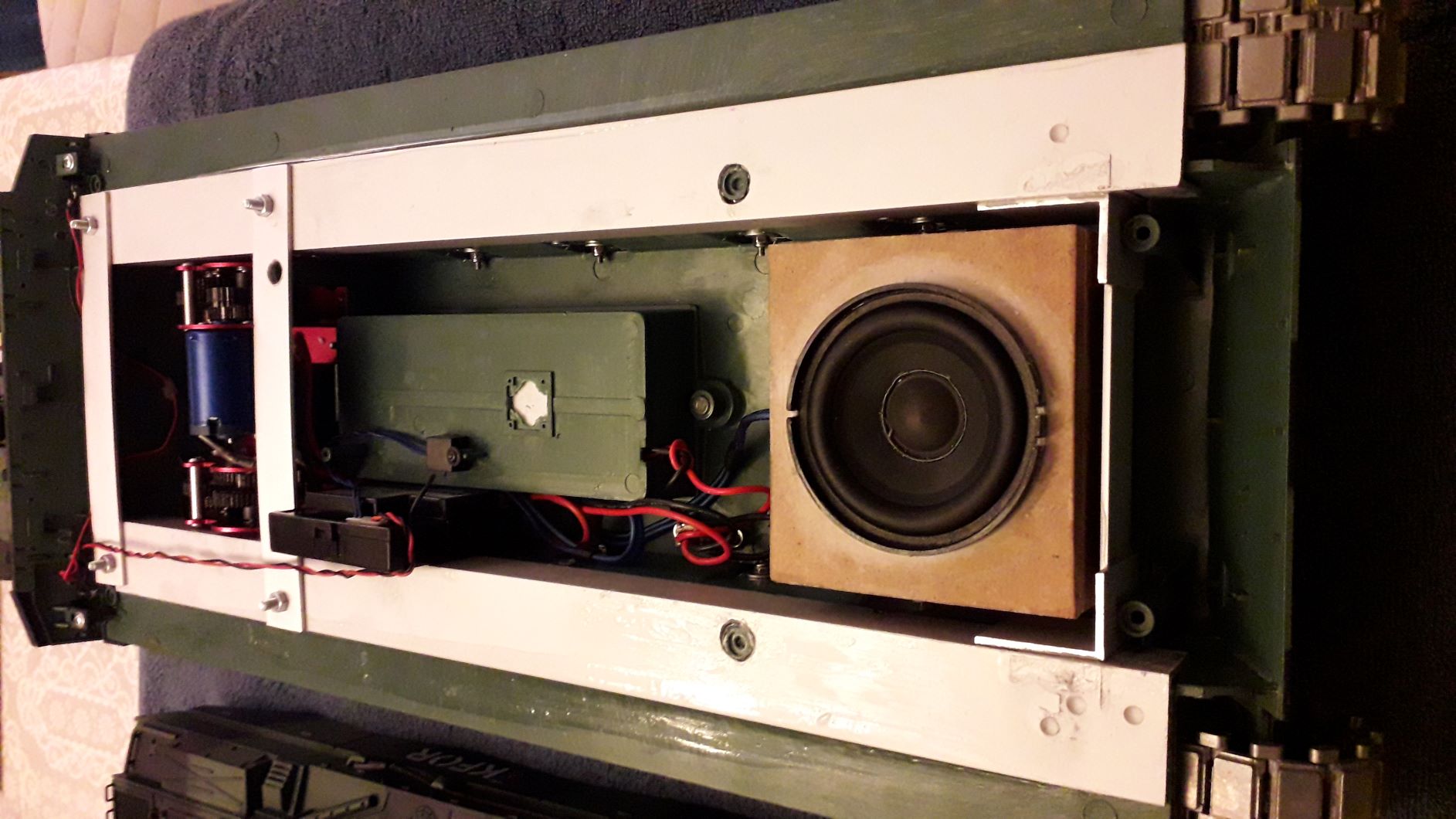

Have done my first round of improvements!
I've done the chassis bracing with just the one error! I tried cross bracing the front end to then find the lid wouldn't shut. Still a very slight gap and I think it's due to running the angle all the way to the edge! Not much I can do about the additional drill holes but I worked out an alternative method in the end. Fitted the HL U2 box/motors which I bought used from black knight, fitted driveshaft support bushes from tankbear and also made a speaker box and used a BMW speaker I had lying around. Sounds great now and drives along nicely in the garden.
Will look to do the 360 conversion at some point but for now it's going fine. I'm not sure if a bit of grease might quieten down the plastic turret ring and gun elevator. They're very noisy!

Cracking job mate!
