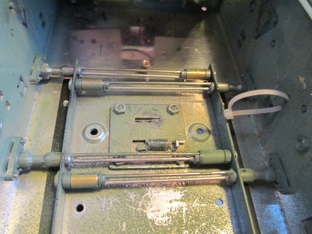

HA!! I figured out the suspension. Real simpel really.
The suspspenion arms are turned to an vertical position and then you wiggle it a bit out of the hull, then the suspension system can be adjusted and the arm is wiggeled back into place.
The hull rides way too high right now, but I'm pretty sure it will look more natural, once the motors and tracks are installed. Time will tell ;)
Here is what I did
Suspension before
And now

I think that may ride too high after the bits are added but hopefully its ok. Although there is adjustment in the suspension, its too coarse to be of much use - the other option is to gently twist the torsion bars where required to get more/less spring force at each suspension arm. I am going to try and modify the suspension on mine to make it adjustable. I will post some pics if successful.

It rode way too high, even after the rest was added, so have moved the 4 center arms, back to their original position, leaving only the front and rear arms tighter. This seems to work :)

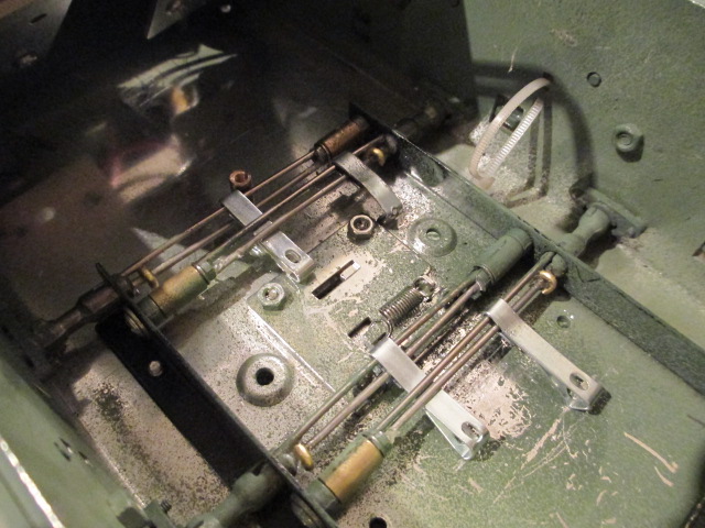

You were looking for the 'Crackerbox Palace' build. ;o) I corrected the suspension by mounting an extra arm on the back four mounts under the gearboxes. I got the tip from Alpha ( who is being too modest ) and adjusted it by adding an arm brace made from spring steel as well. It was rube goldberg-ian but it raised the arse of my 25 lb Capture KV-IIA right up to level and keeps it there to this day. Following along on this build, Arnie. I do love a well done KV-2
augmented by the trailing arm clip and brass spacer idea I dreamt up
Alpha's double torsion bar suspension upgrade

Arnie_DK wrote:HA!! I figured out the suspension. Real simpel really.
Here is what I did
Suspension before
And now
8O Arnie! ...you supposed to do the rear only...that's the part that sags...especially once you put the gearboxes in :haha: :haha:
Another suggestion for your suspension is to take out those rods ...and find appropriate length Tamiya "flat" torsion bars...and swap them out...I used torsion leaf from the Tiger I for my Panzer III :D
