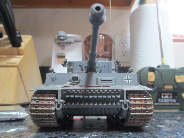

Jimbo, that's a great tank all around! I will follow your updates closely as I have one of those that I did a minor detail buildup on.( grill screens, metal barrel, new tracks, etc. ) It's about time to upgrade the gearbox in it as well after many years of motoring around on countertops. Following along!
