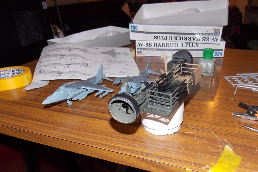

cut up a couple of the original roadwheels today to use as spares on racks. Drilling out the bolt holes was a bit rough but looks ok... :shh:
Was going to attach them to the racks on turret sides but ended up attaching them to the ends of the rear bustle rack with a very small cable tie (thru the handy slot in rear rack end!)
here's a pic...

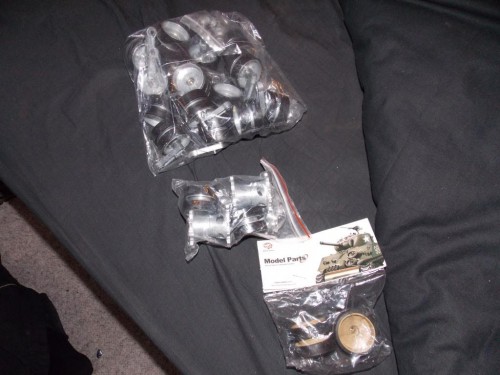

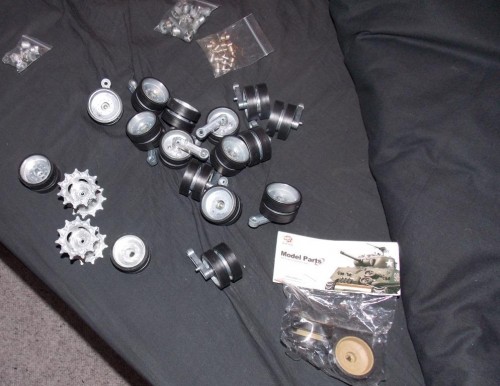

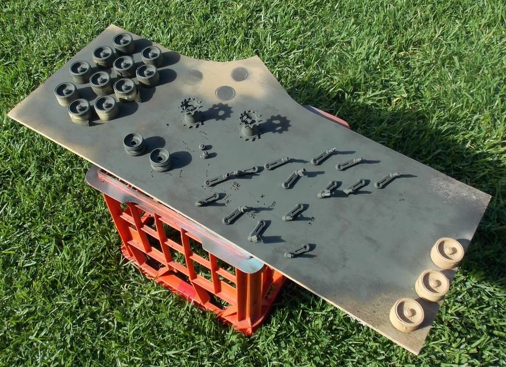

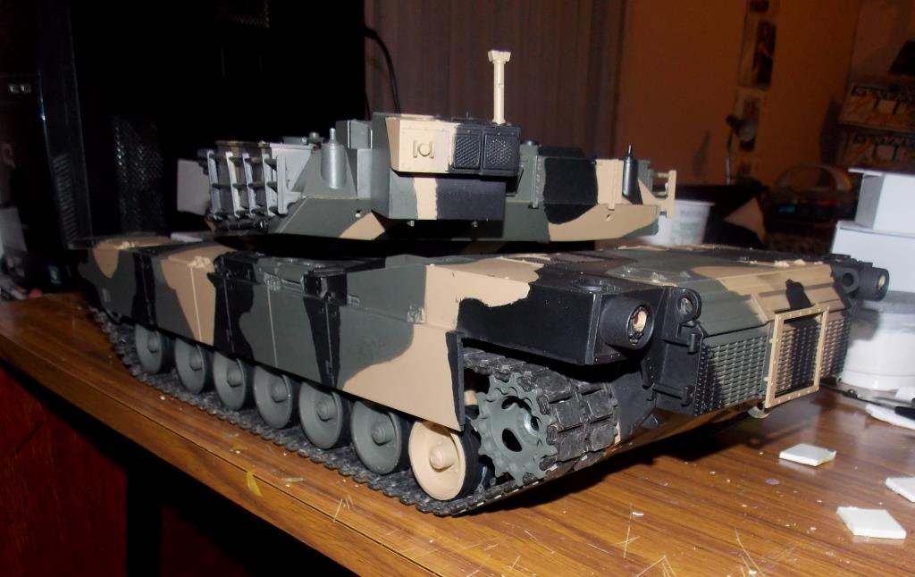

Off sick today with chest cold, but got presents from the postie! Roadwheel's,two sets of idlers..., sprockets and suspension turned up from tankarmy :thumbup: :thumbup:
So I set about taking the suspension arms off the roadwheels and the masked up the rubber parts and axle ends. Painted 3 wheels tan just to be different (most Ozzie tanks have all green wheels from the pics I have).
Will fit em' to hull on weekend.....definitely a lot heavier than the plastic wheels!! each plastic wheel and suspension arm weighs 16grams the metal ones are 84grams!! over 1.184kgs!!
Question!! is there a particular order/method to fitting the suspension/springs that makes it easier?? and do you grease the bearings or just some light machine oil??
Bruce

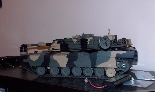

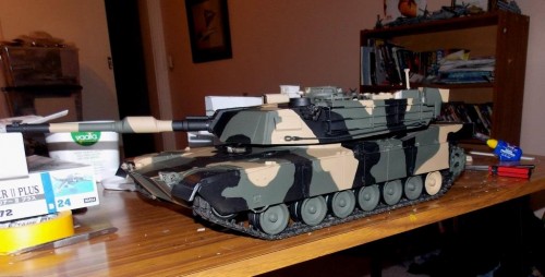

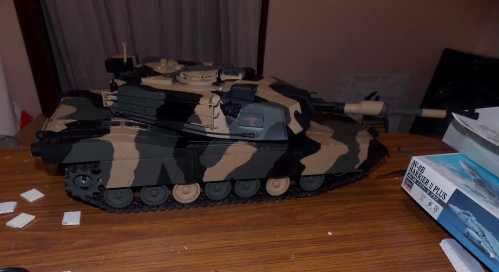

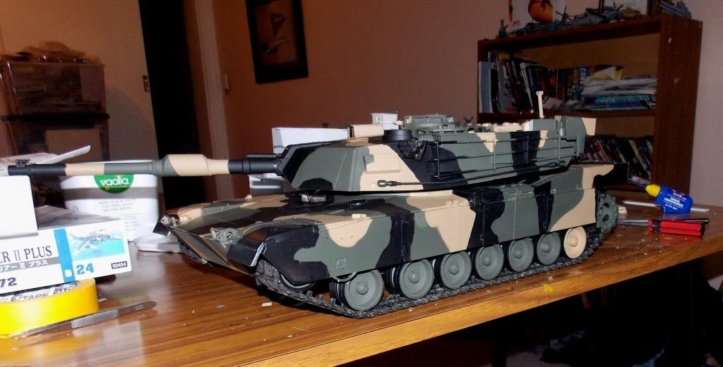

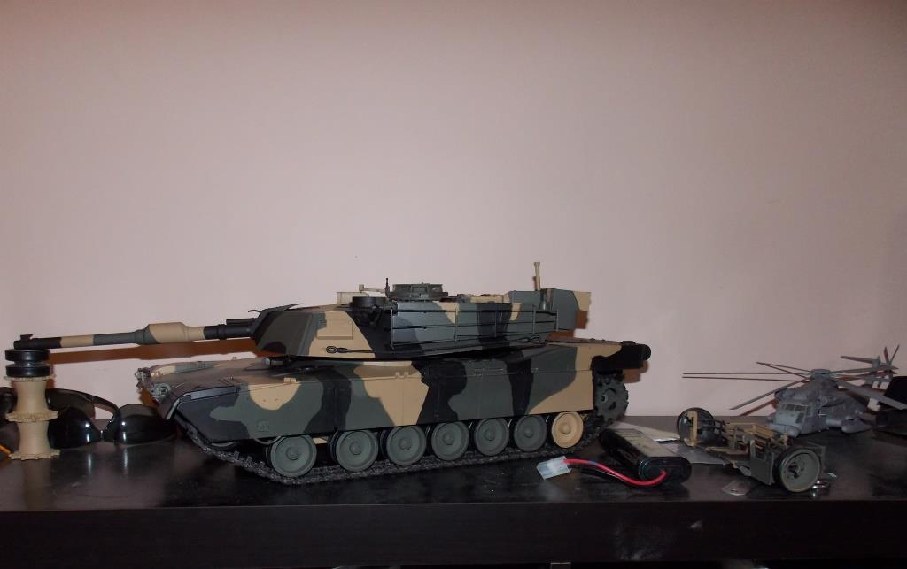

Did a test fit of the metal roadwheels, sprockets and idlers tonight, certainly adds a bit of weight to the beast! (just over 1kg actually 8O 8O ).
Won't be doing much else for a bit till I find some spare $$$$ l :haha:
Bruce
rear rack is just chocked in place with the offcut from one of the plastic roadwheels...
going to swap the tan wheels fwd one spot each so they match the camo on the skirt...
