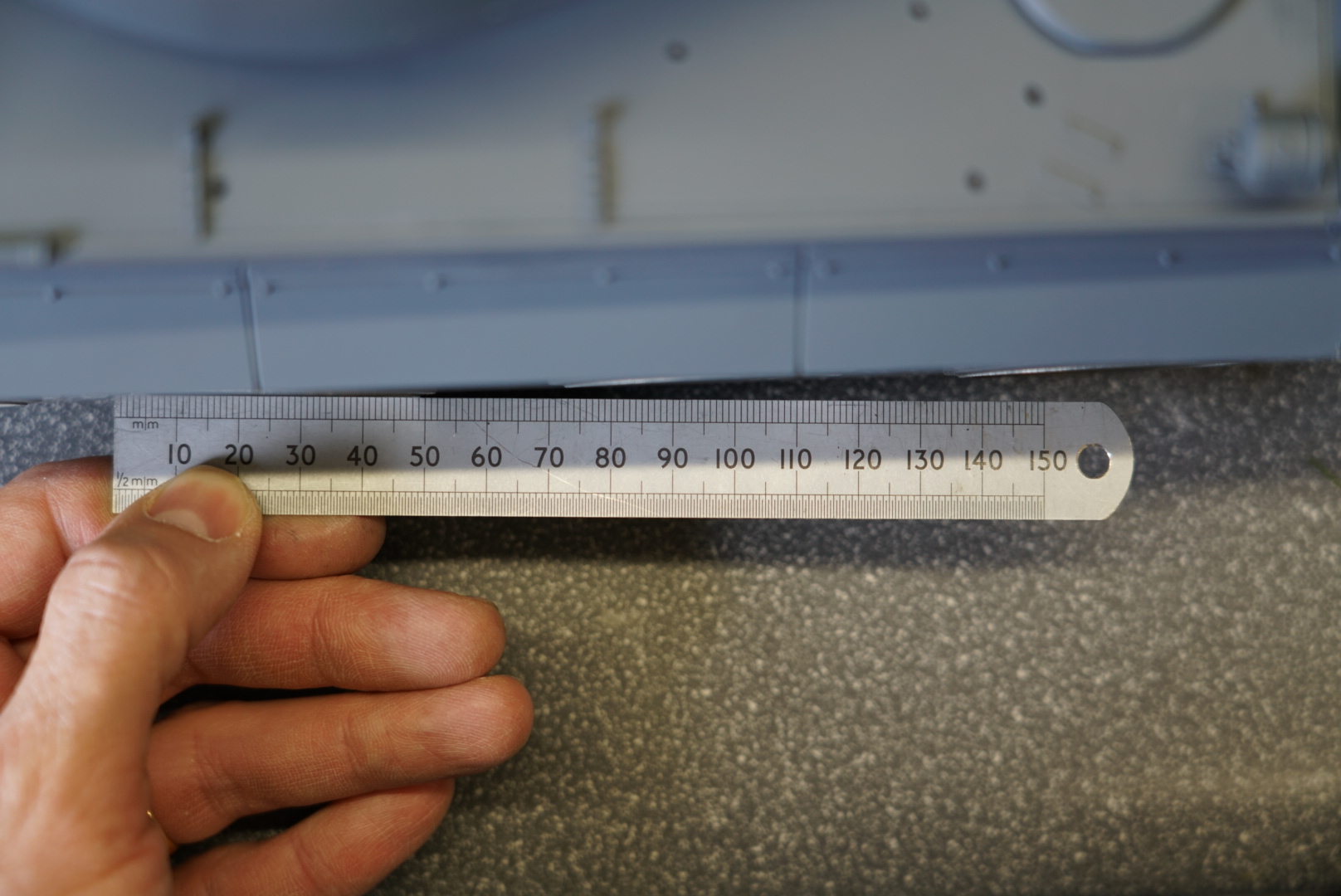

Some investigation and inspection identified, “it ain’t straight”, see straight edge on the wheel:
Wobbly wheel
Wobbly wheel
(The edge of the rule is on the face of the problem wheel. Other wheels are mostly square and true)
I checked it’s tight and can see no obvious problem as it appears to spin true, the metal suspension arm it’s mounted on must be the issue? :S ???

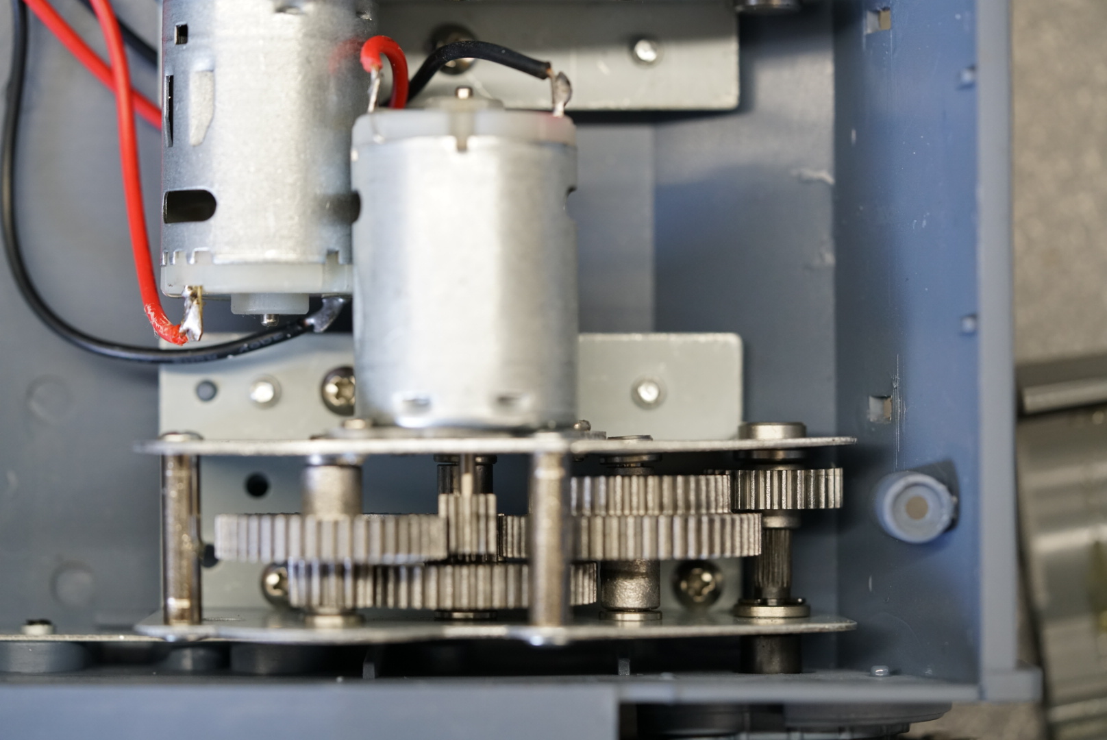

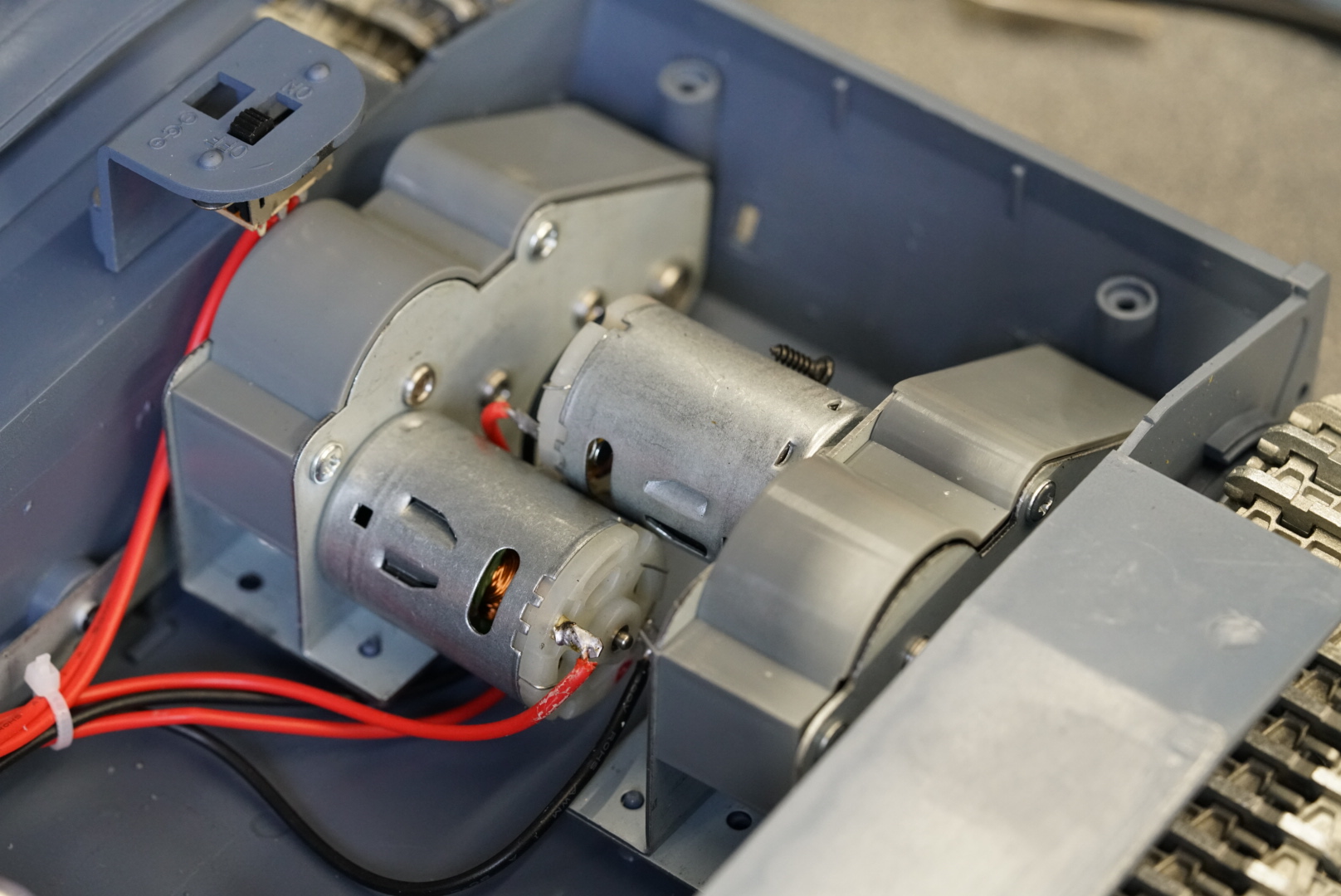

The gearboxes are indeed metal, with a plastic cover looked pretty decent, but removing covers there is a lot of play on all the gears on their axles, the axles appear to be in bushings not bearings - again not complaining at this price point just observing!
I noticed though that the right gearbox has a really loose gear set, it looks like the bushing in the gearbox wall is not parallel, and this shaft has a lot of movement, generally eccentric movement is not expected in a gearbox is my experience, the shaft to right of motor before final drive to track sprocket:
Gearbox
Gearbox
Hard to photograph but the bushing is in focus if you click the image full size you might see how it’s “on the wonk” I believe is the engineering term. Not sure if this is factory issue or caused by the bad road wheel yanking on the whole drivetrain that side.

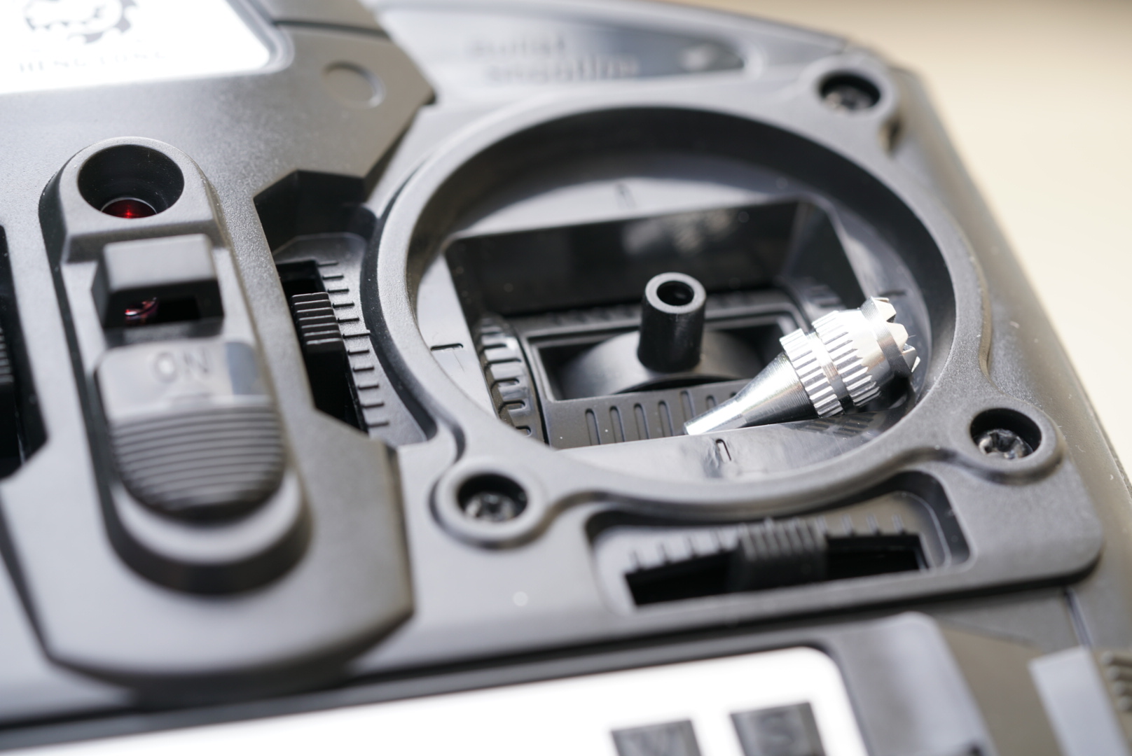

Oh, and just to add to the complaints, the controller sticks keep falling out - with the very poor slow speed control as well it seems I likely will be wanting to upgrade controller sooner than later…

It is very possible that the suspension arm has a wonkey hole for the axle, or a bent axle. If it is the later, you'll have to remove it from the arm to straighten, the arm wouldn't take the stress and would likely snap. It is also possible to purchase spares. Although, if you're staying with the Heng Long chassis, it will need stiffening.
The Taigen/Torro metal suspension arms won't be the same as the Heng Long ones you have.
As for the gear boxes, the gears haven't been blackened, and they look a bit light for steel, are the actual gears magnetic? To me, they look like the soft pot metal variety, it may just be due to the lighting etc of the photograph, but a magnet will tell, because pot metal isn't magnetic.

The road wheels “axles” are screwed into the suspension arm, the screw/axle itself appears straight so my money is on the arm - more likely factory cross threaded than bent? (Unless by axle you mean the part through the HL Hull, which is also possible I didn’t check that closely but it’s not fouling the chassis as far as I can see).

son of a gun-ner I didn't think to try a magnet, they are not black they are silver, they seem "OK" for a PRC product, but I would not say they are made from steel more "Chineseiuem". You can see that the motor pinion does not sit in good mesh with the drive gear, and even though this was 10 minutes on hard surface its already showing wear. The box and advertising only claims "metal gears". I am not overly worried about the gears stripping through material, more because that shaft is moving all over as the bushing is bad.

The controller is OK (I have other models with cheap plastic controllers) but my crawler has a higher quality radiolink and its not just the build and feel but the control on the potentiometers/encoders etc is much more fine and precise. If you try to do a reverse turn, it works OK one way, the other way it likes to suddenly spin turn the opposite way - which is annoying and going to get you killed if Oddball is coming the other way :/

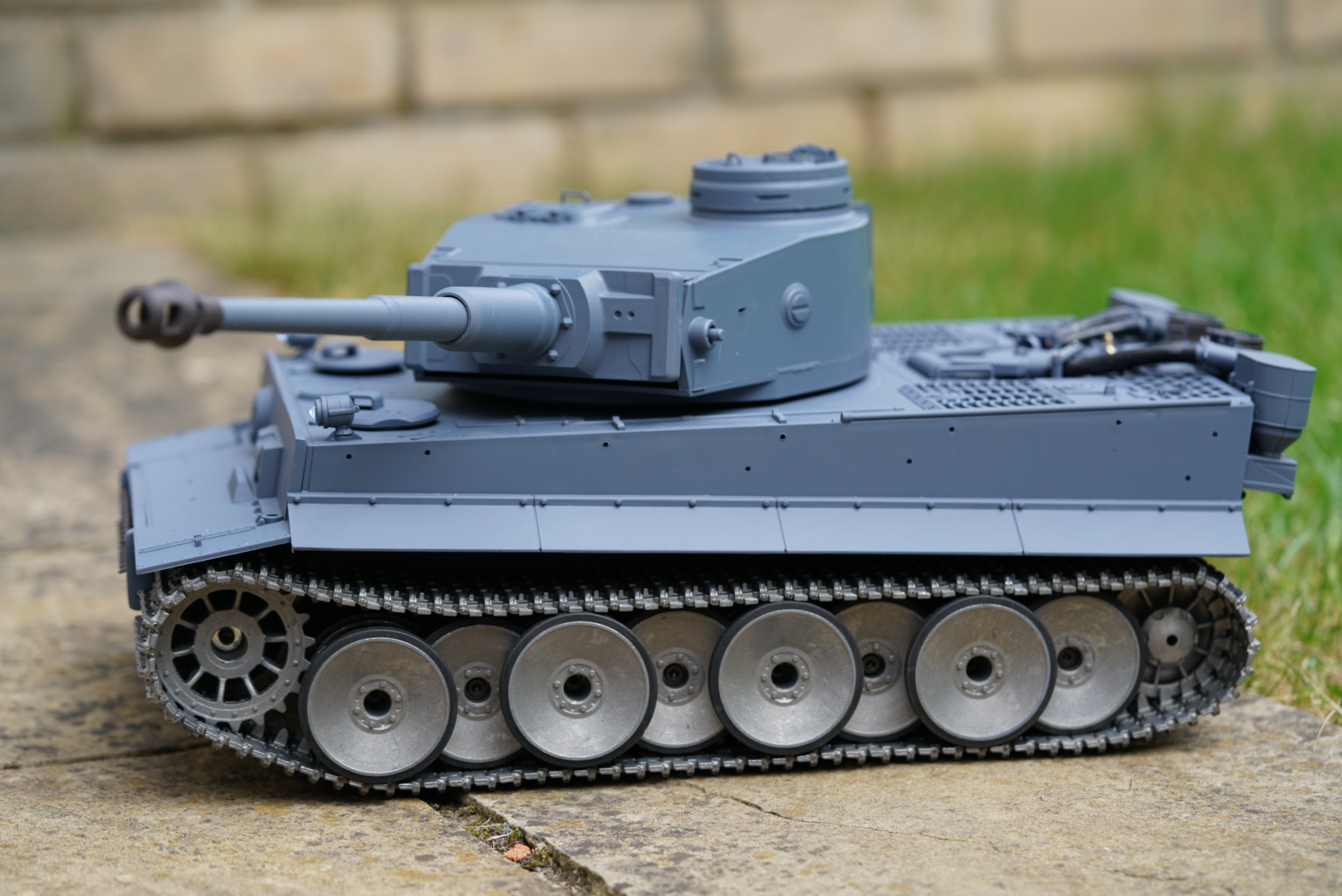

It’s the “latest” (as every Chinese product always is :/ ) pro version, so metal gearbox, wheels and tracks included and 7.0 electronics:
Tiger
Tiger

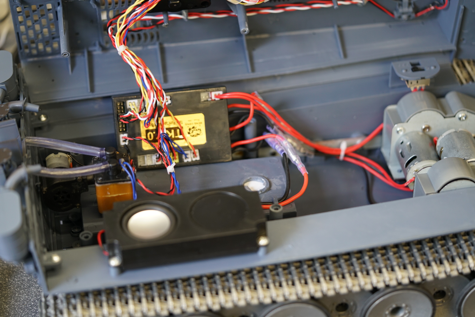

It does seem to have a lot of functions in the booklet, the 70% speed was a welcome option, sound volume adjustment is useful as well. 7.0 electrics:
TK7.0
TK7.0
I am wondering now what current the 7.0 supports and if I can upgrade the motors as the ESC is built in.

Gearbox

Ok found the problem, the suspension arm hole is not straight and true, maybe cross threaded with a power tool at the factory.
Hard to Photograph, but it’s about 15 degrees at least of level hence the wheel rubs and crabs.
In any case could try to tap it straight (re-thread that is) but I want the taigen lower hull anyway for more strength and easy access and it comes with new arms it seems so that should solve the problem.
Will have to see if I can find HL arms as spare so this chassis is useable in future if needed.
