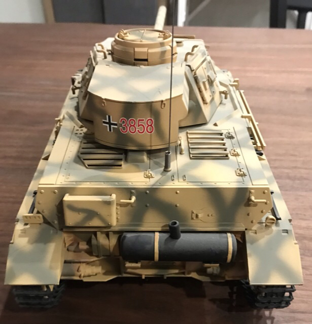

very old 27 mhz Pz IV with channel selector on the hull side.

smoke module, rear bottom, 2 transparent tubes

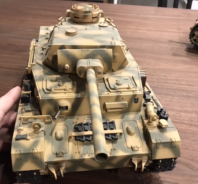

Heng Long Panzer 4 Ausf G Although Heng Long insist on calling it an Ausf F2

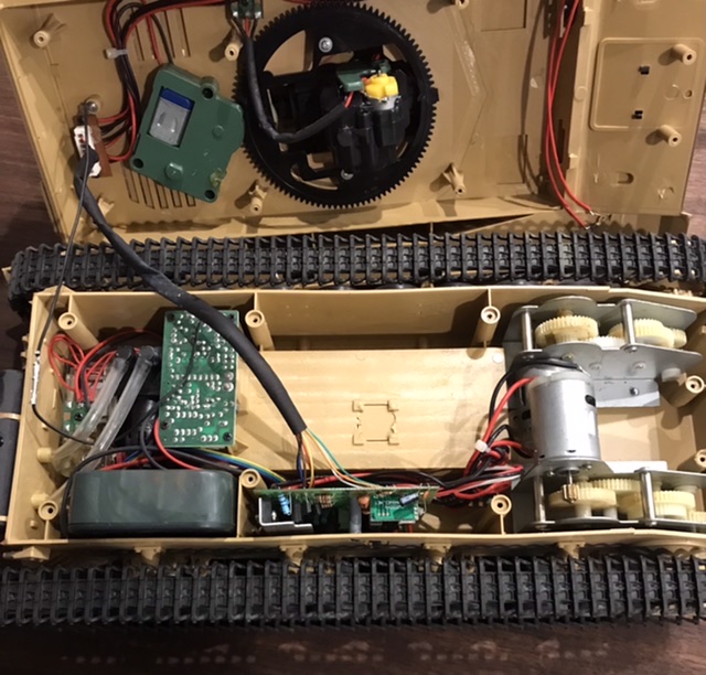

That is a older Heng Long Panzer IV, 27mhz controller. A S&S version (Sound & Smoke). Produced Around 2008-2010.
The control board that is up against the wall is a RX13 MFU (For Smoke and Sound control) and the daughter board sitting on top of the battery box is the 27Mhz Receiver.
Base version with all plastic tracks, sprockets, and gearboxes.

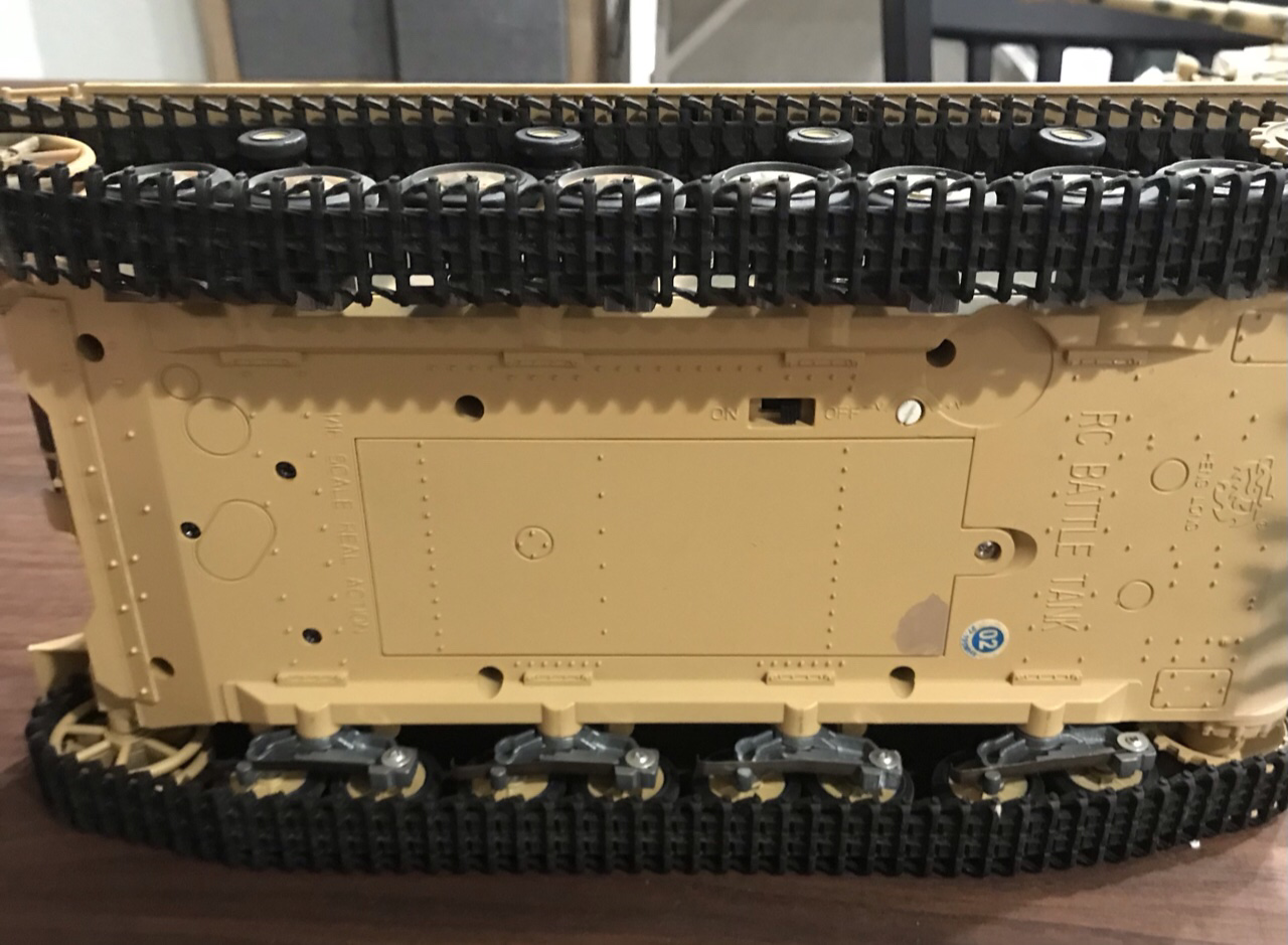

Should be a switch on the bottom of the tank.Cshaffer wrote:How does the smoke module work? I assume there is a liquid needed to make it work?
Main on/Off power switch, Smoker On/Off, Volume control turning knob, and the side wall mounted receiver "channel" switch.
