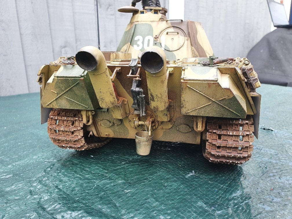

Finally, a big thanks goes out to our own Tom Hugill for allowing me to use his beautiful Panther G to help illustrate what I'll be talking about next. :thumbup: :wave: I know that in May of '44 the Panther exhaust was changed to eliminate the extra pipe of the A model. I also know that the purpose built flame suppressor was implemented in Oct. '44. I guessing Tom's picture would be displaying the temporary, sheet metal covers that started in appearing in June of '44?

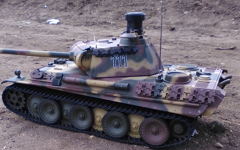

According to Roddy McDougall and Martin Block's book 'Panther - External Appearance and Design Changes' (Anyone interested in Panthers should consider getting it, it really is an excellent resource), The 3 colour factory scheme was used by all 3 manufacturers involved in the Panther G, each had their own unique pattern, which also evolved over time - it is possible to tell the manufacturer and date simply by the paint scheme in a lot of cases after August 1944.
Road wheels were painted on their own in a single colour (brown, green or yellow), and then randomly fitted as they hit the assembly track. They were not sprayed with a camouflage pattern as this provided a visual aid to enemy gunners to estimate the speed of the tank.
Taking a cursory look at the rest of that book, spare wheels on the rear quarters of the turret shows up from Dec 1944 on Daimler built tanks only - I'm not seeing a whole lot of examples with empty spare wheel brackets either? - But then again the book focus's on Factory mods, not individual unit preferences, so perhaps that's not so surprising.
Ambush on Zimmerit is depicted in the book on an MNH built example, done using the disk stencil method. Several were noted to be with units involved in the Lorraine fighting in Sept 1944. Sadly I don't have many ref photo's from the Eastern front, I guess the authors had better access (or better quality) to the US archives and personal collections in western countries.
These would have the earlier bare tail pipe with the sheet metal cover, rather than the flame suppressing ones on Tom's Panther above. Not a great picture, but here's my effort - basically a couple of pipes from a Pantiger (Daimler and MNH used the forged elbow much earlier than than the fabricated one found on the HL Panther G, which was still being used by MAN much later into 1944), with simple shields made from copper sheet rolled around an Exacto knife handle:
