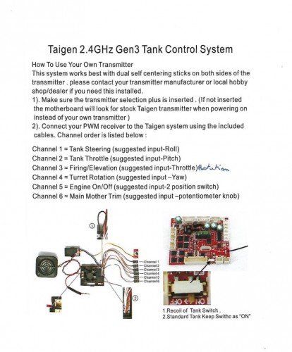

Hi, some news here. My friend is trying to use his new hobby radio with the taigen electronics but for some reason it is not working.
So far, the receiver is bound to the radio and works, 100% sure.
He connected the wires from the taigen MFU to his receiver. He connected the 6 channels.
He plugged that smal plug where he has to.
When he powers the tank, the fan starts spinning and the receiver is powered. We tested a servo on channel 7 and he can control it.
But it seems there is no way to start the tank. He flicks channel 5 and nothing happens. What is he missing? Thanks!

Thank you very much for the intention, friend.Jofaur86 wrote:Hello Rad..
I don't know if I can help I just know that know avlat of problems with this turntable ??
Yeah, we already got that diagram, but for some reason he cannot make it work. I wonder if he is missing something...
- Posts: 1664
- Location: Centre France
Re: How to bind a taigen MFU?
There seems to be a button ? To choose whether or not the Tank recoils from the shoot
