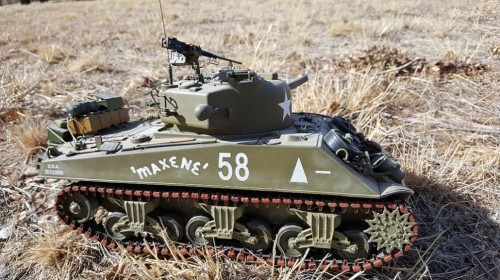

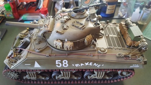

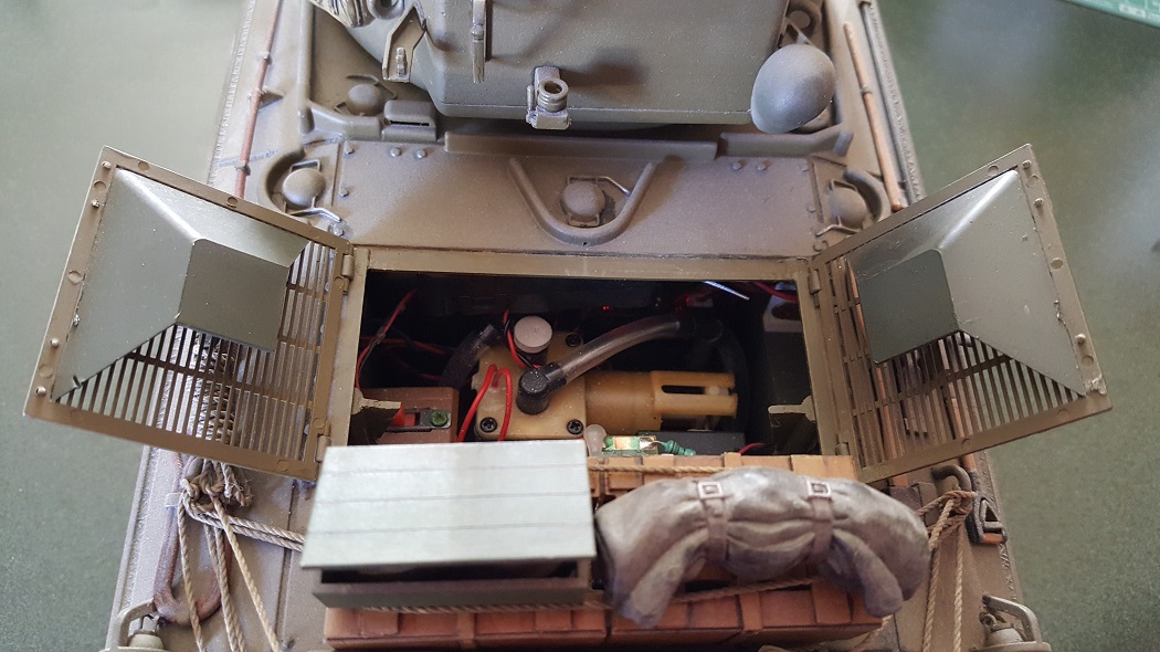

I run a 5000 mAh standard battery in 'Maxene' and have had no issues, heat or otherwise. The tank has been modded with all metal running gear and has no issue with mobility. That size battery keeps it going for a goodly amount of time. The Heng Long Sherman is one of the best runners that the company produces. With a little detailing, you will have something uniquely yours.
