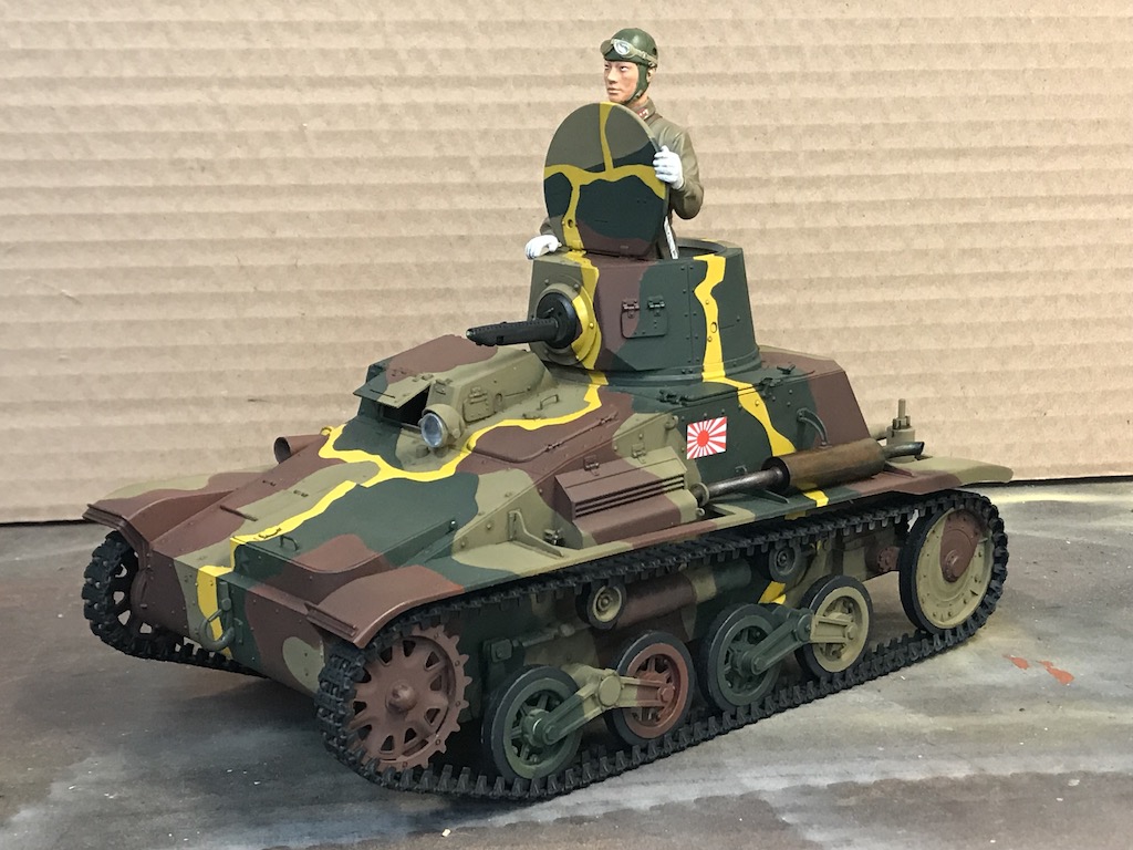

I have just finished building the Takom Type 94 Japanese tankette. It is quite a small 1/16 tank. So, my task was to change it from a static and make it rc. 8O
Several months later, the job is done.
The tank now has forward, reverse, left and right movement with moveable suspension. The turret traverses and the MG flashes. Working front spotlight and rear tailight. Overall I am pretty happy with it as it is my first full static conversion. :D

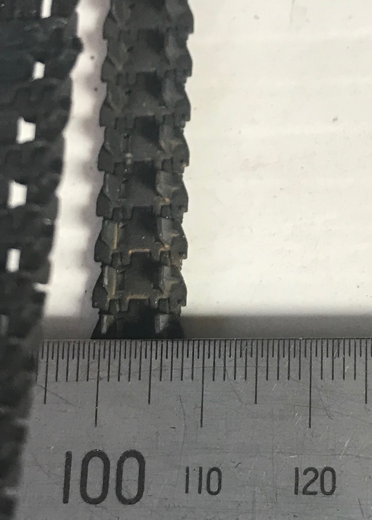

BUT here is my problem, the vinyl / rubber tracks are too fragile and keep breaking. I have already glued them together several times. :thumbdown:
So does anyone have any suggestions to improve the tracks ?
Maybe some one piece 1/35 tracks. But from what tank ?
Or are there any small metal link tracks, 1/16 or 1/35 that would substitute for the original tracks.
I look forward to any comments, ideas or suggestions.

before weathering
before weathering
5.5mm between track guides
close up of the track pattern

Just a thought,
I have no idea what the dimensions of the tracks on your type 94 are in comparison to the rubber tracks on the WSN/Torro M16 half Track but they are robust and very grippy,
They would probably be too wide but being rubber judicious use of a craft knife might do the job,
Like I say Just a thought.
EDIT, The overall width of your tracks appear to be 19mm,
The overall width of the tracks of the WSN/Torro M16 Halftrack is 20 mm.
Whats 1mm between friends :lolno:

Posts: 8398
Re: Tiny Tracks
The overall width of a Panzer111/4 track is 25mm and the distance between the sprocket teeth is 5mm from the edge of the track.
EDIT,
The reason why the PZ111/4 track wont work on the type 94 is the same reason the WSN/Torro track wont work,
The Track guide is in the centre whereas the type 94s track guides are on the track edge,

The tracks are like 7mm. It is very very small.

Would 1/35th workable links work ?
Sadly those tracks use a single central sprocket, therefore the tooth holes run down the centre of the tracks.

I have Rommel's Greif in 1/32nd scale, and the tracks only measure 7mm wide.
And my 1/18th scale SdKfz.251 has tracks 16mm wide, which would translate to around 8mm max at 1/35th scale.
Which would make them viable if they came with twin tooth ring sprockets. But I don't think they did :think:
