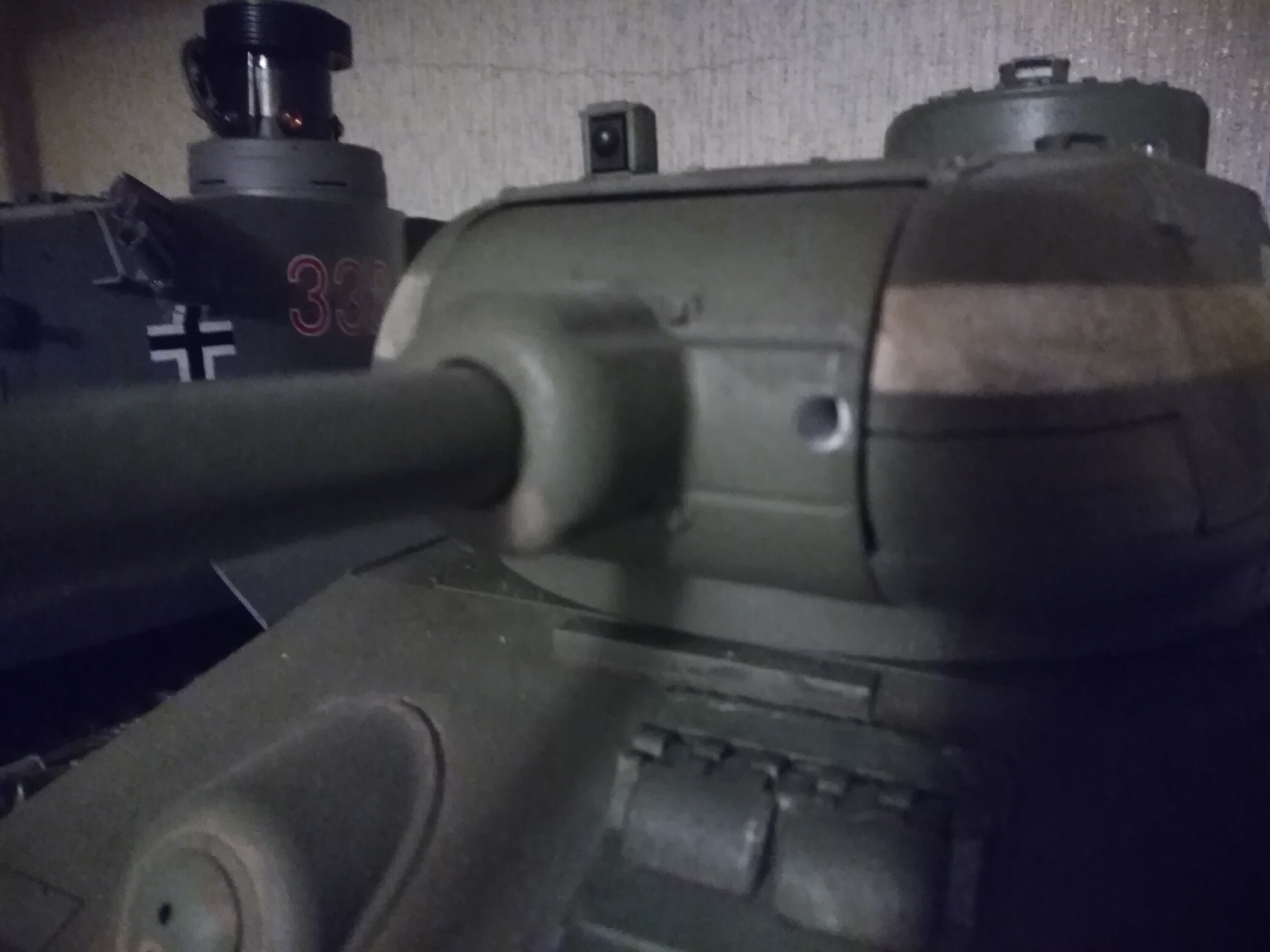

In the mean time l found a cheap "WSN" T34 so I've been experimenting. This too seems to be a sealed unit but, contrary to the information in the manuals, the IR emitter is not based in the periscope housing on the turret but is in the barrel. On firing the gun the barrel emits a longish red light (prefer the white ones) and also the IR beam. I can only see one LED but I've used LEDs with dual colours - could these ones be IR and normal light?
The twin LEDs in the turret top mount are the receivers. The problem is similar to that experienced with the Taigen system but infinitely more so. It doesn't matter where the barrel is pointing, a hit is guaranteed! I'll be looking at how l can control the direction of the IR beam. A long matt black tube protruding from the barrel won't cut it!

I have a WSN T34. For what it's worth, I ignored the IR in the barrel. I drilled out the hole on the right hand side of the mantlet, as you look at it from the front. I fitted the requisite tube with a new emitter of the correct frequency, and it works pretty well.

That seems to be a good solution. However, what sort of IR emitter LED did you use and is it compatible with the WSN battle system (or any other). I guess you dismantled your T34 in order to do this. Can you tell me how you took it apart? Are there screws somewhere? The single sunken screw on the rear deck doesn't appear to release anything on mine - maybe I'm being too gentle with it ;)
