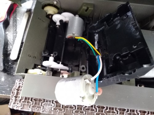

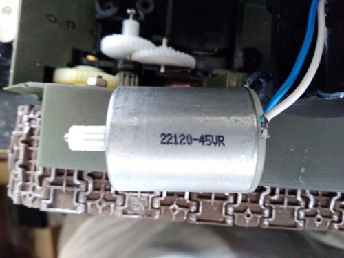

I first asked this way back and never got a reply, so I'm having another go. When I changed the board over to a Clark TK22, I had to change the battery from 9.6v to 7.2v. The net result was that far from it being one of the fastest tanks on the battlefield, it can now be overtaken by just about anything. Has anyone experience of changing the motors on one of these? There is not a lot of info to go one. This is what is inside the gearbox.
If this is not possible, then I shall be grateful if someone could recommend suitable replacement gear boxes. I believe a few people have modded the WSN T34 in the past. This is the current model, not the older one with opening hatches.
Oviously, what I would like is something with more guts in terms of speed and pulling power. If this is not possible, then I shall be grateful if someone could recommend suitable replacement gear boxes. I believe a few people have modded the WSN T34 in the past. This is the current model, not the older one with opening hatches.

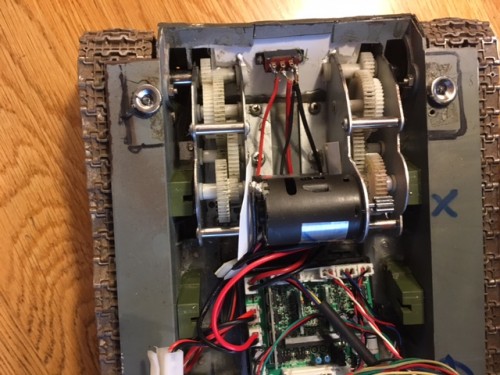

I have an old wsn T34 where i fried one off the motors trying to fit metal gears ( junk that binds).
I replaced it with a motor from an 1:24 HL tank, and that one ran faster so i had to replace the other one aswell.
Later i replaced the wsn Gear box with hl ones. It takes a bit off cutting and twisting, but its doable.

I used to have one of these with an Elmod board, I fitted the metal gears but the one thing I remember about that build was that those gears were an absolutely illogical fit, as well as needing filing to get them to work! I don't recall it being super slow or anything though? It pulled ok on the rough stuff.

I the shafts are a different size you will need HL sprockets as well.
Re: WSN T34 upgrade
I drilled out the HL shafts, and press-fitted the WSN shafts into them.
