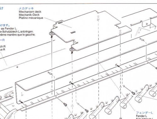

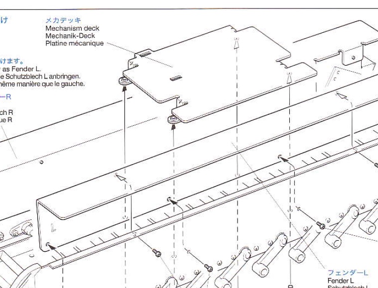

That could make for a messy interior. Bonding in a sheet of aluminium alloy, with epoxy, would make it easier to use the space to add a larger MFU, or speaker...and so on. Here's Tamiya's 'mechanism deck. It has the effect of adding torsional rigidity to the chassis, but also serves as the space where the MFU (DMD) or Electronic controller is attached.

Sheets of alloy for modelling, in a variety of sizes, are readily available from model shops online. Epoxy or nuts and screws will make for a solid attachment.Other than that, flats of 2 or 3 mm styrene could be bonded in, along with right angle bracing struts/ bulkheads. Again, supportive structural styrene (Right angle, Cubed, Tubular etc..) is readily available on the Net. Here's just one outlet, for example: http://www.cornwallmodelboats.co.uk/aca ... icard.html

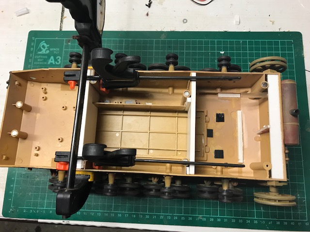

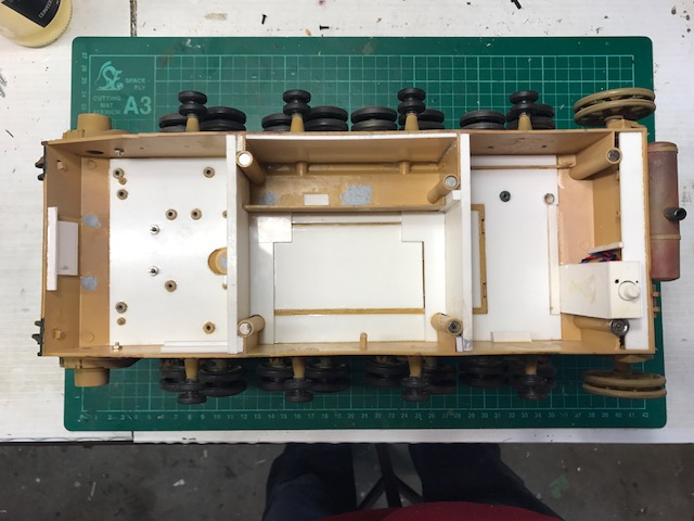

- dgsselkirk
- Posts: 1484
Re: Resin cast to stiffen hull?
I actually just finished up a Pershing for the club draw. I would go 3/8" since the Pershing is a fairly wide tank. For the bulkheads I glue them in position using crazy glue and then 2 part epoxy on the bottom edges to give them strength and seal them to the resin. I get the 2 part epoxy at my local dollar store and it works great. Now, I did not set out to make it waterproof at all so I would have to look at it a little closer with some suggestions if that is what you are after. I will take some pics tonight if you like....
