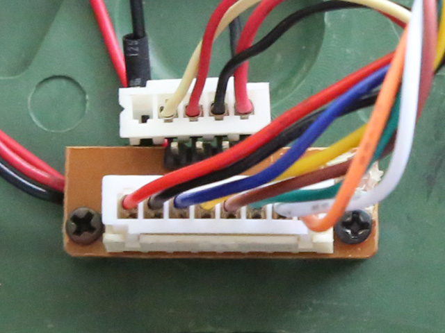

Re: Taigen Panther F - internal layout
The recoil unit I used, was the Stock one allready in the turret .
I was to use the Clark recoil (universal) unit , but since turret is of metall, and hard to alter, I just went the easy route and removed the recoil motor and spring in the torro recoil unit , and Attached a servo as in photo With a link arm.
servo then Connects to recoil/servo port on tk60 Board, and bada bing
blizt is installed (later) , just not showing in photo

Just kept the Stock motor and rewired it to fit the 9pin wire coming from top hull ( tap into the correct wires )
